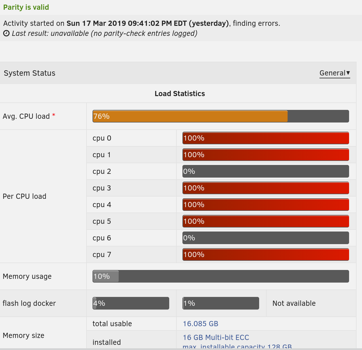

The server has been up for over 30 minutes now, and two of the cores still at 100% (showing in the dashboard)

I think I found what causing some of the CPU cores to load at 100% - the parity check. No matter what I do, the parity check keeps running. If I disable it before turning on the array, then enable docker then the damn parity would start running again.
It has been 7 hours now for the parity check, but the docker is still in Starting services. And could not get the diagnostic file.

See screenshot for core utilization
