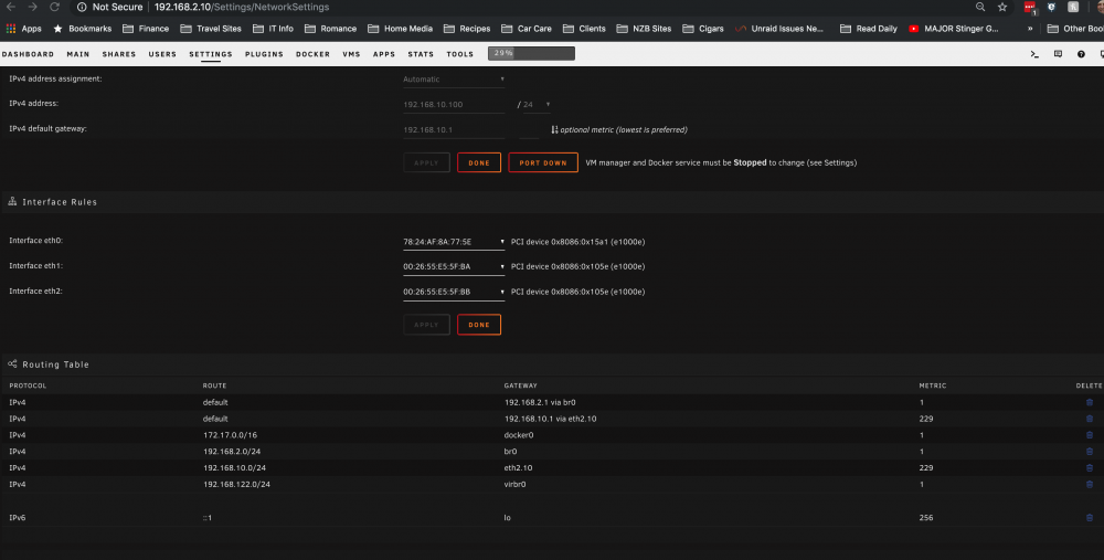

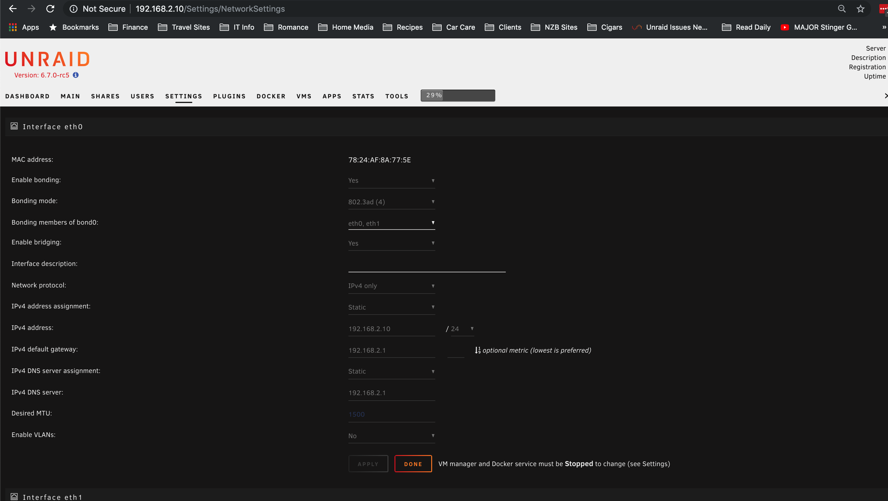

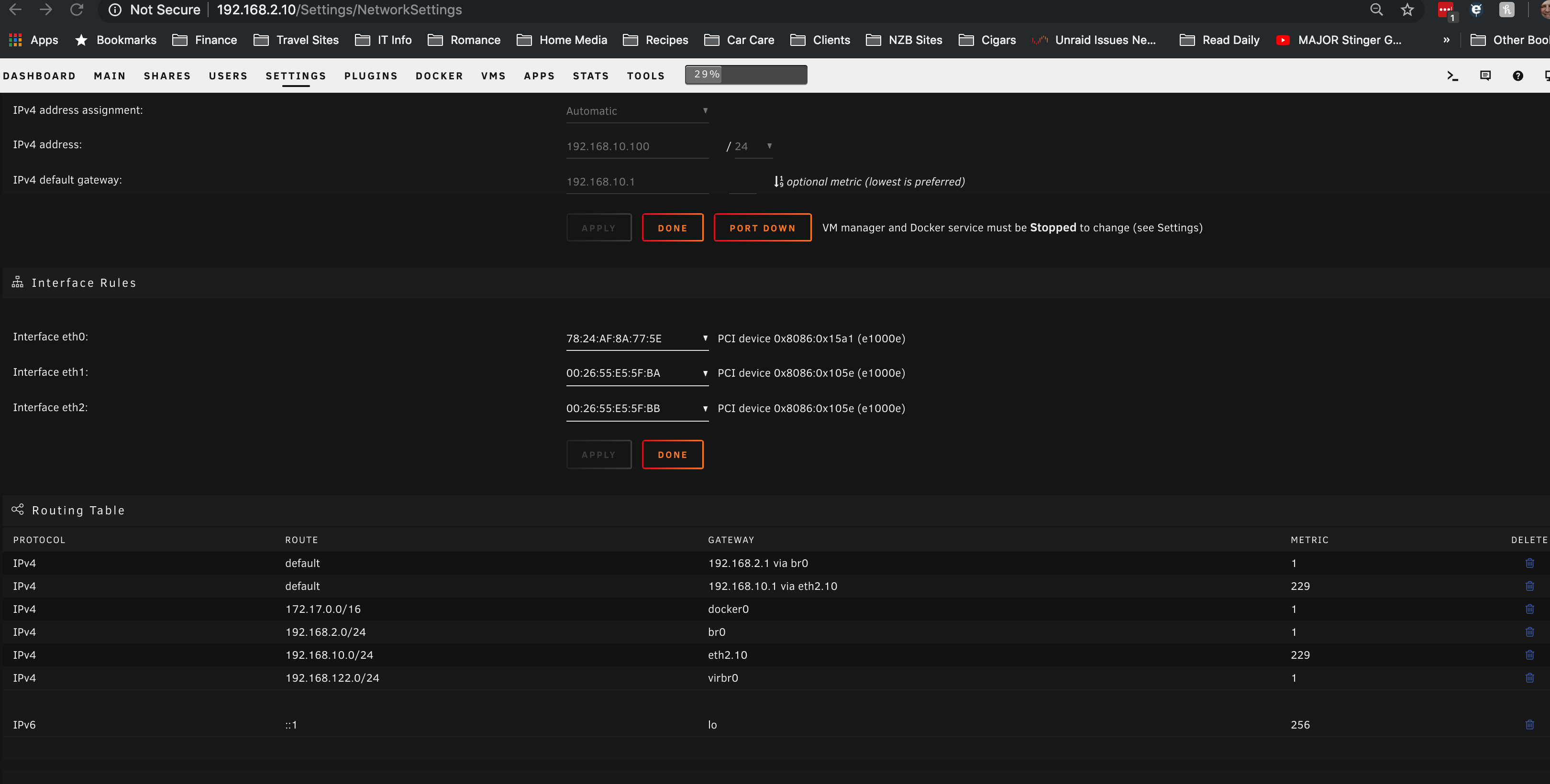

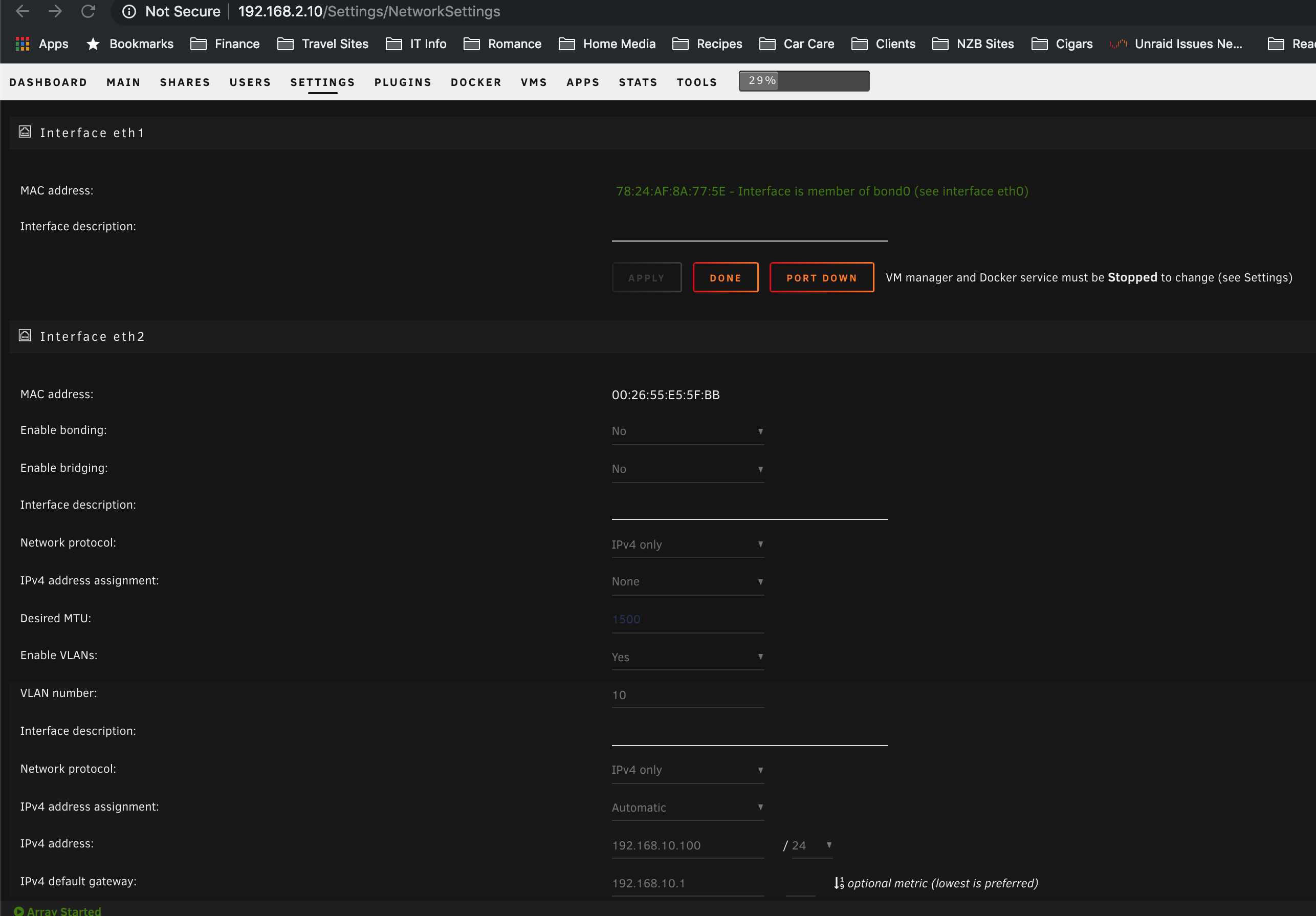

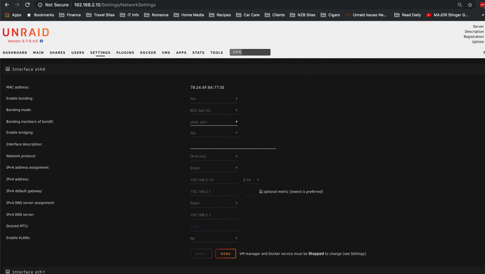

Here are the screenshots of the network config.
The network setting was normal.
