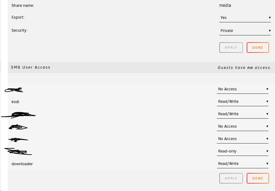

When I create a folder within that share as user "downloader" i can't read the files as user "kodi". And if i create the folder as "kodi", "downloader" can't enter that folder. The settings on the share is as follows.
User downloader is connected from a WS2019 and a mapped drive is connected with that user. Just reinstalled from WS2016.
User kodi is connected both on a Virtual LibreELEC HTPC. And a Windows10 laptop. Same problem on both.

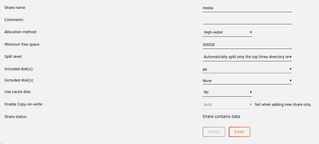

First when i had this problem, it only effected the share if i used a cache disk and mover. So I haven't used cache disk for years now. But now it happends for everything that is saved on the server. Found the link to post when i had that problem, was never solved though.
I have used the Docker safe "new Permissions", and also the old "new Permissions" only on that media share.

bild.png.f18bca5311d491e6d1a16bb20fde0069.pngbild.thumb.png.8d52c0740840c12ad033a4ae1bb232c1.png
