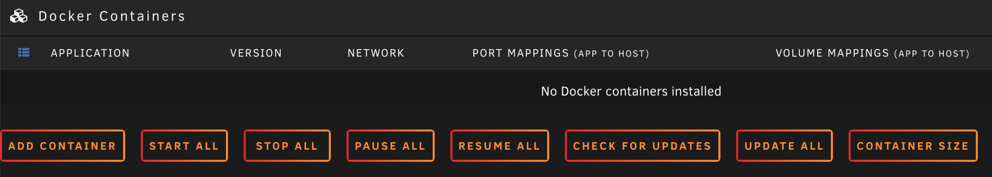

I tried following your tutorial, but after reboot it tells me I don't have any docker containers installed.
1065017496_ScreenShot2020-05-12at1_22_45PM.thumb.png.a9d6bea9fabc2f755b413d1a8194d734.png

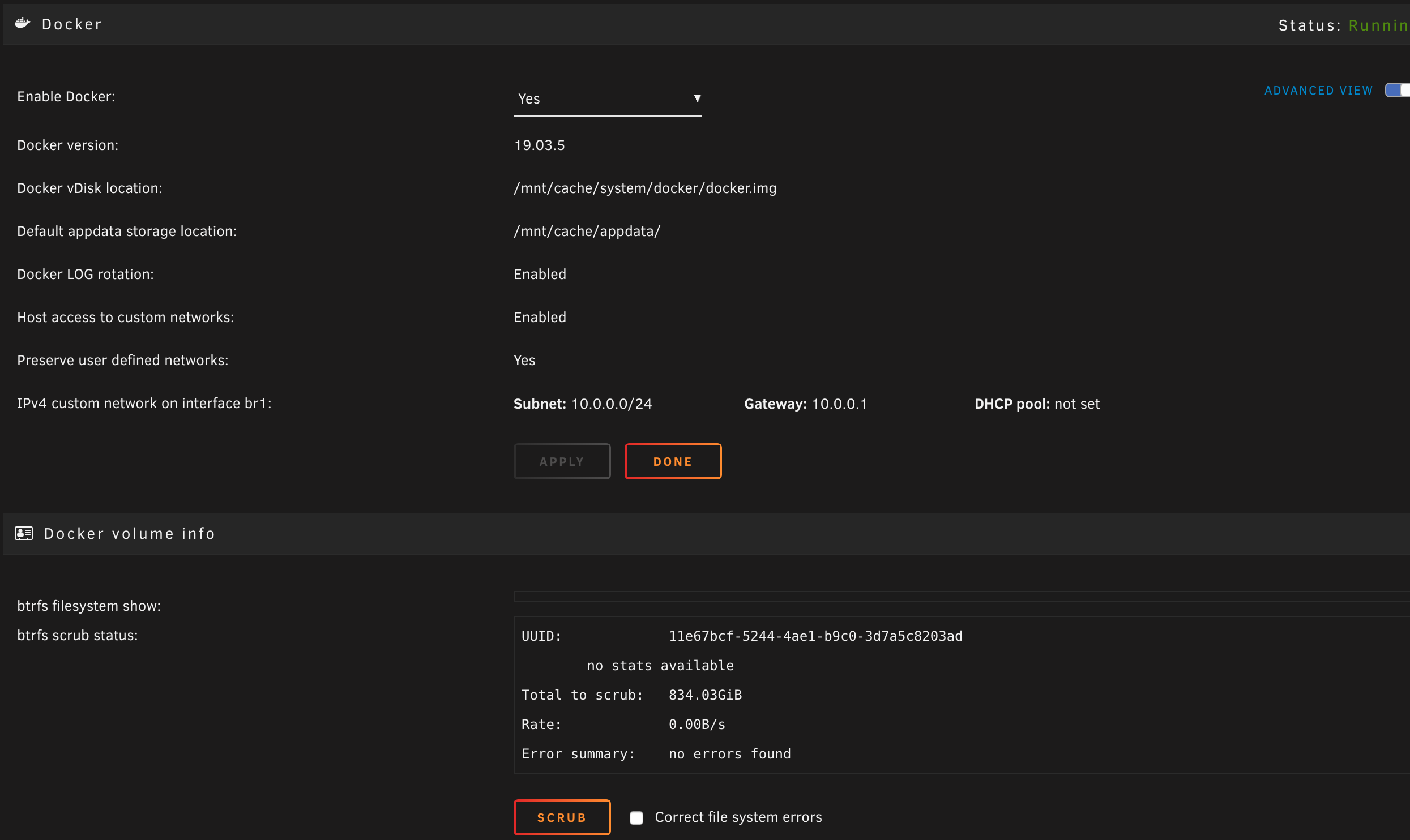

It shows me the docker service is running.

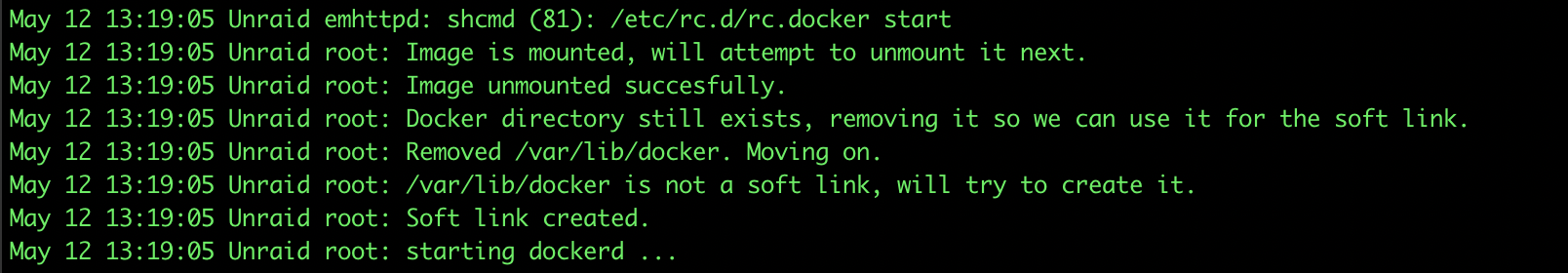

Checking the logs I can see it created the softlinks.
490799377_ScreenShot2020-05-12at1_24_39PM.thumb.png.be86bce91c4fb763629d4be5611bcfda.png
If I remove that entry to copy the rc.docker file in the /boot/config/go directory everything works again after a reboot. However, then it puts it back to original and uses loop2.

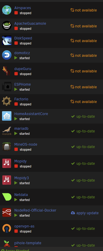

So, Unraid updated quite easily. Only issue now is the following, but won't matter too much as 4/7 are just barebone nothing lol:
The rest of the 'fixes' I will try tommorow (a.k.a. today) as the dockers don't impact a lot, but the VM's do. Will work on it later though.

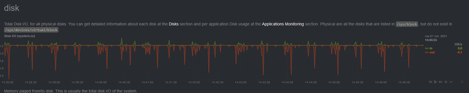

Weirdly the writing (according to Unraid's UI) doesn't seem to be in use that crazy much right now. Nearly 3MB/s write peak instead of 25 MB/s. See picture after (red line is the kinda docker-started line):
Before the update it litterally spiked continously from 12 to 2 to 25 and sometimes (server at high-performance) to 54.
Will very much keep an eye for it for now. Maybe I don't even need to change it. Or you guys have suggestions?

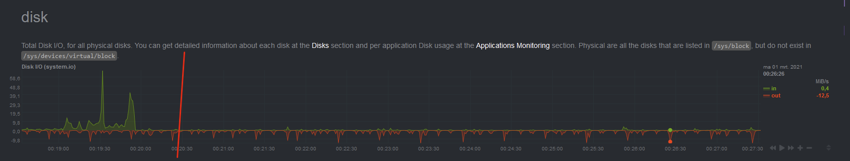

So comming back to this now. I changed a few local things.
- I've updated Unraid to the 6.9-rc2.
- Home Assistant now only saves every 30 seconds to the database.
I came up with these results in a 34 minute timepsand:
All calculated, this generates around 47 GB of writes a week, which I find more casual for the disk (due to there being 3 of them).
Recalculated this is around 4.7 Megabyte per minute and 0,07 per second (and around 0,149 on the btrfs-transacti).
A yearly sum of this woul be around 2466 GB of writes (docker only). I think this is a need fit compared to the 20+ MB/s before nearly being continously. Which would be 1,296 (or just 1,2) TERABYTE per day at 15MB/s 24/7.
As of now and the thing I reported earlier, I actually broke the log (/var/syslog is just empty). I guess this doesn't affect loopt but I will retest.
Edit:
Here you can clearly see the 30 seconds mark when Home Assistant Pushes its data out. Before the saving rate was every 10 seconds
Edited by maxstevens2
Got it all fixed now, no crazy writes anymore, and no crazy action.
