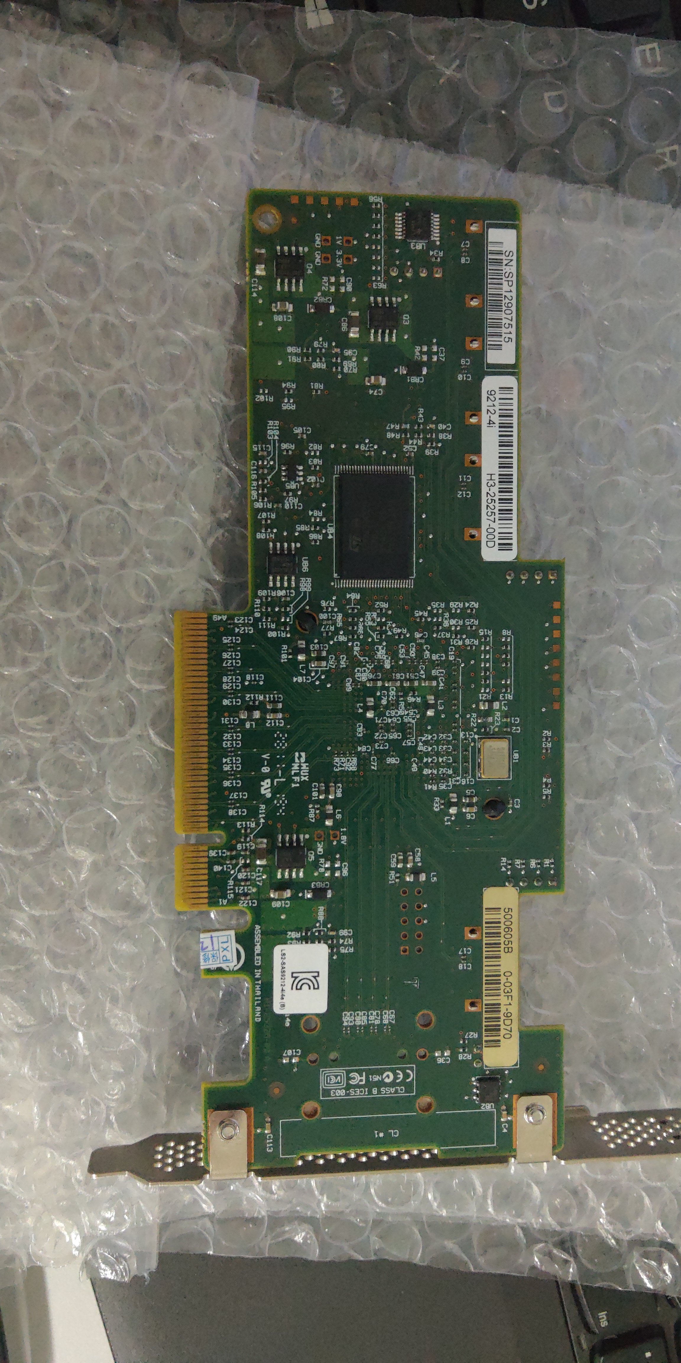

Hello, my brother, I also bought this card, bought from China, I am a person who loves toss, and therefore some problems, So I came to ask for help

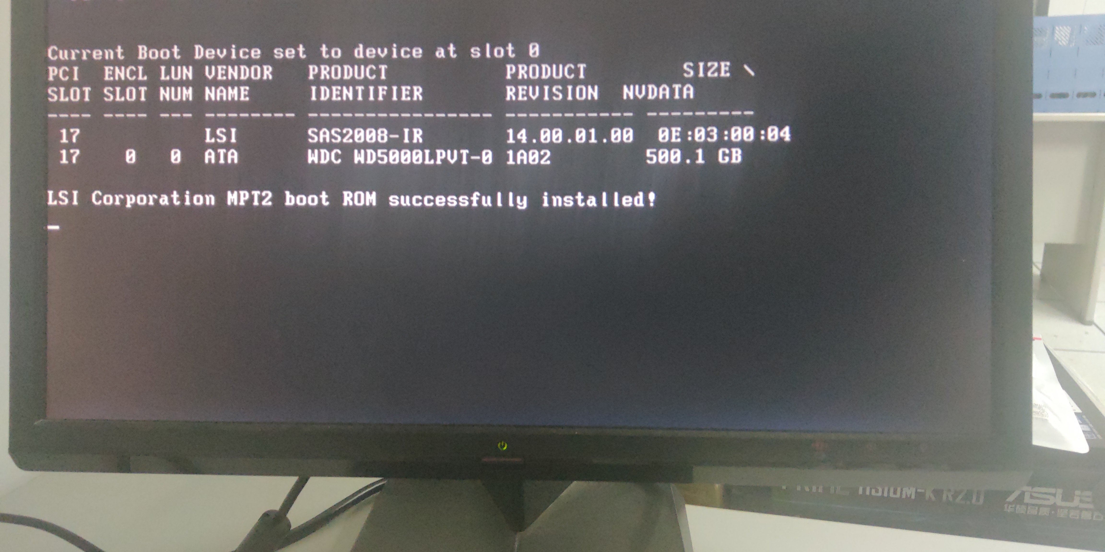

This card was disassembled from HP's server, and the IR mode is displayed after power on, as shown in the figure below, but my hard disk can be found. Very strange

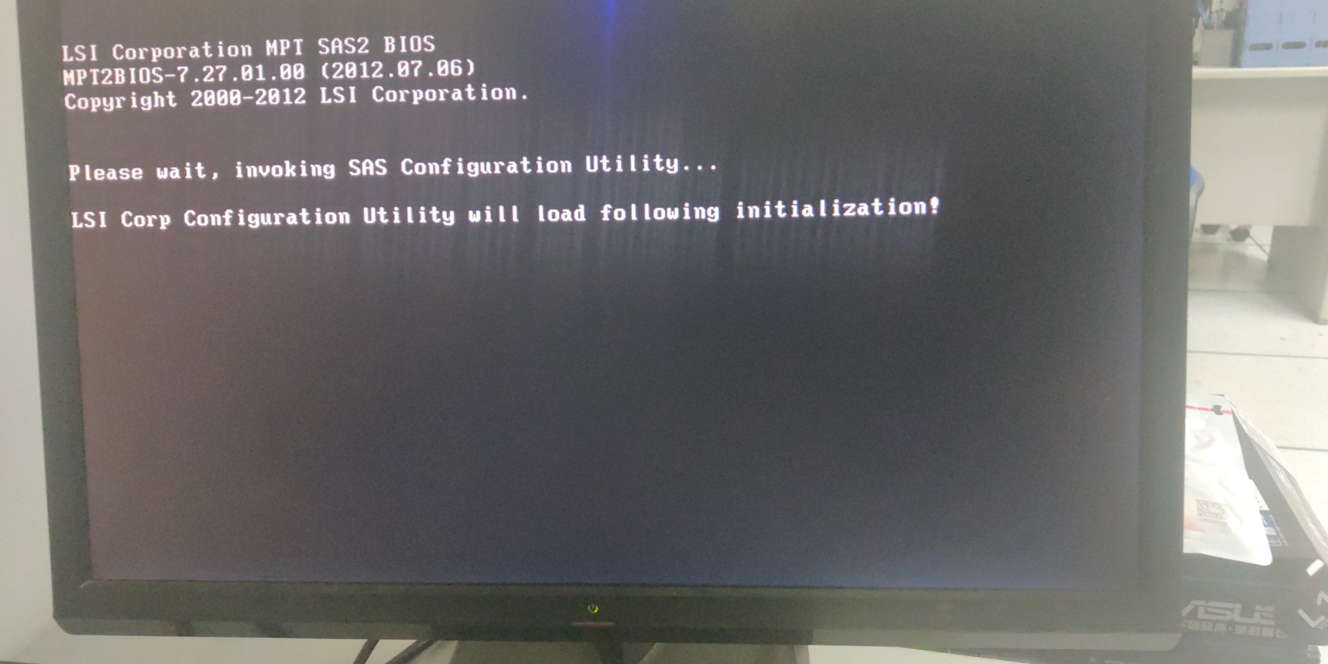

before I flash firmware  ,   when   i  turnd  on  power and  pressd  Ctrl + C  , it always  prompted this
But I've never been in the WebBios

thanks  for your reply,This display  is after I bought it,  not after execute “SAS2FLSH -o -e 6” , My description made you misunderstood 😭 ,sorry

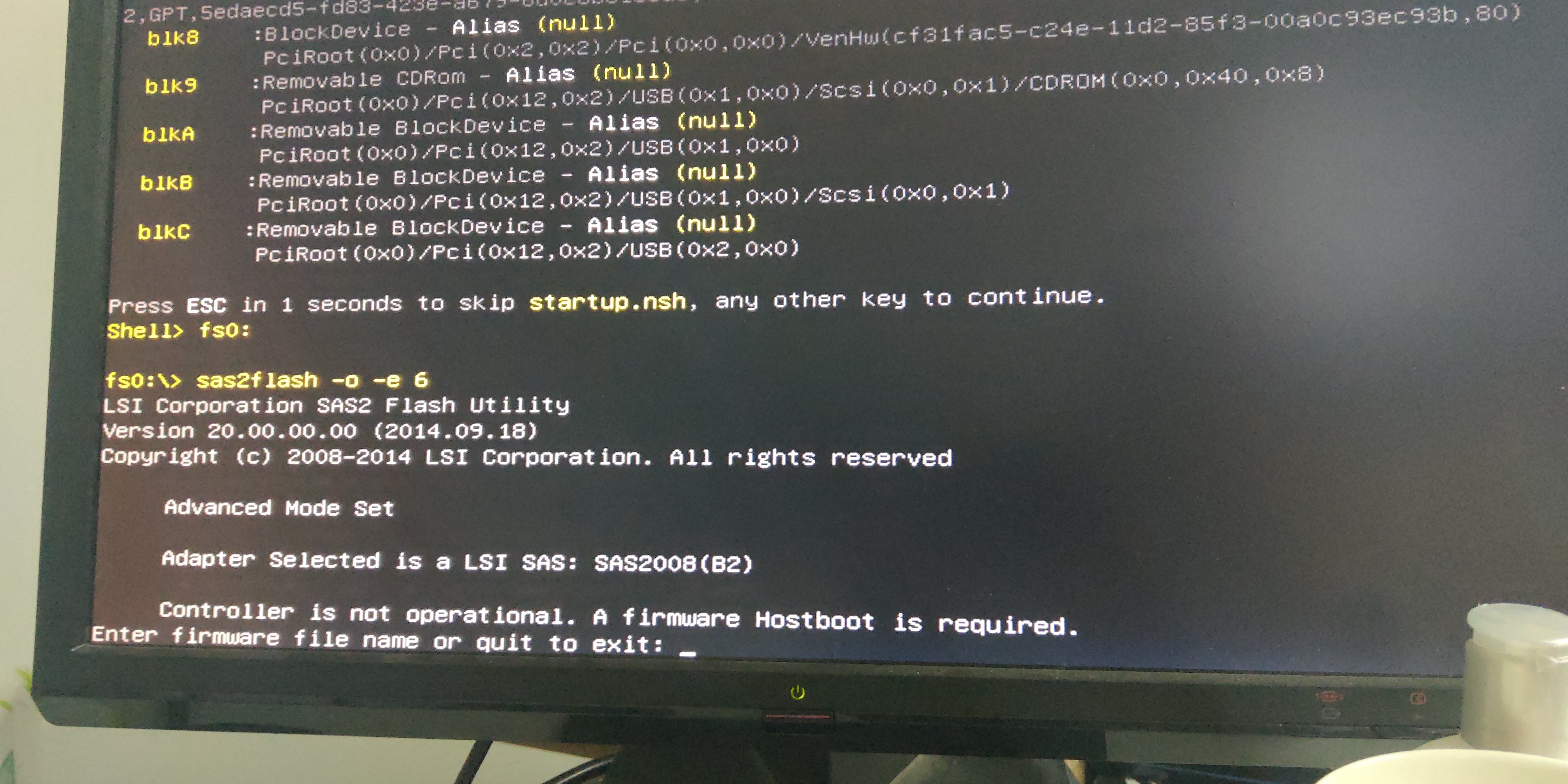

When I execute the command “sas2flash.efi -o -e 6”,  prompted  like  that  firmware  is missing . Please enter the name of the firmware. I don't remember the detailed ,i will give the photo later

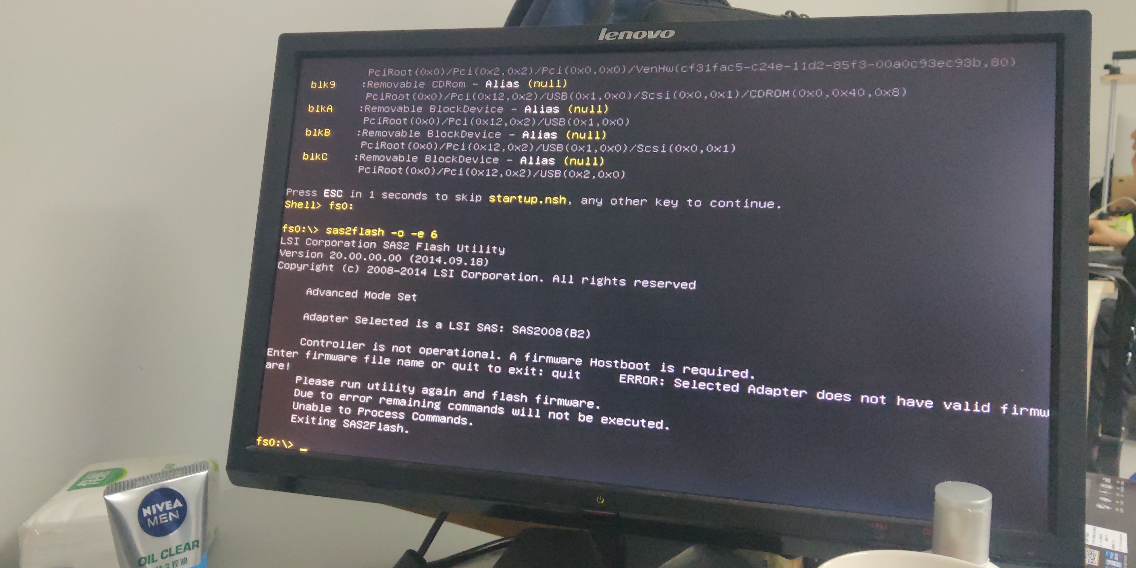

How are you, my stranger friend ,As you said, I did that and  got this .
I typed “quit” this time 。( I tried to enter the firmware file name before, and  got  the same error  as  type " sas2flash -o -f  <name>.bin" )

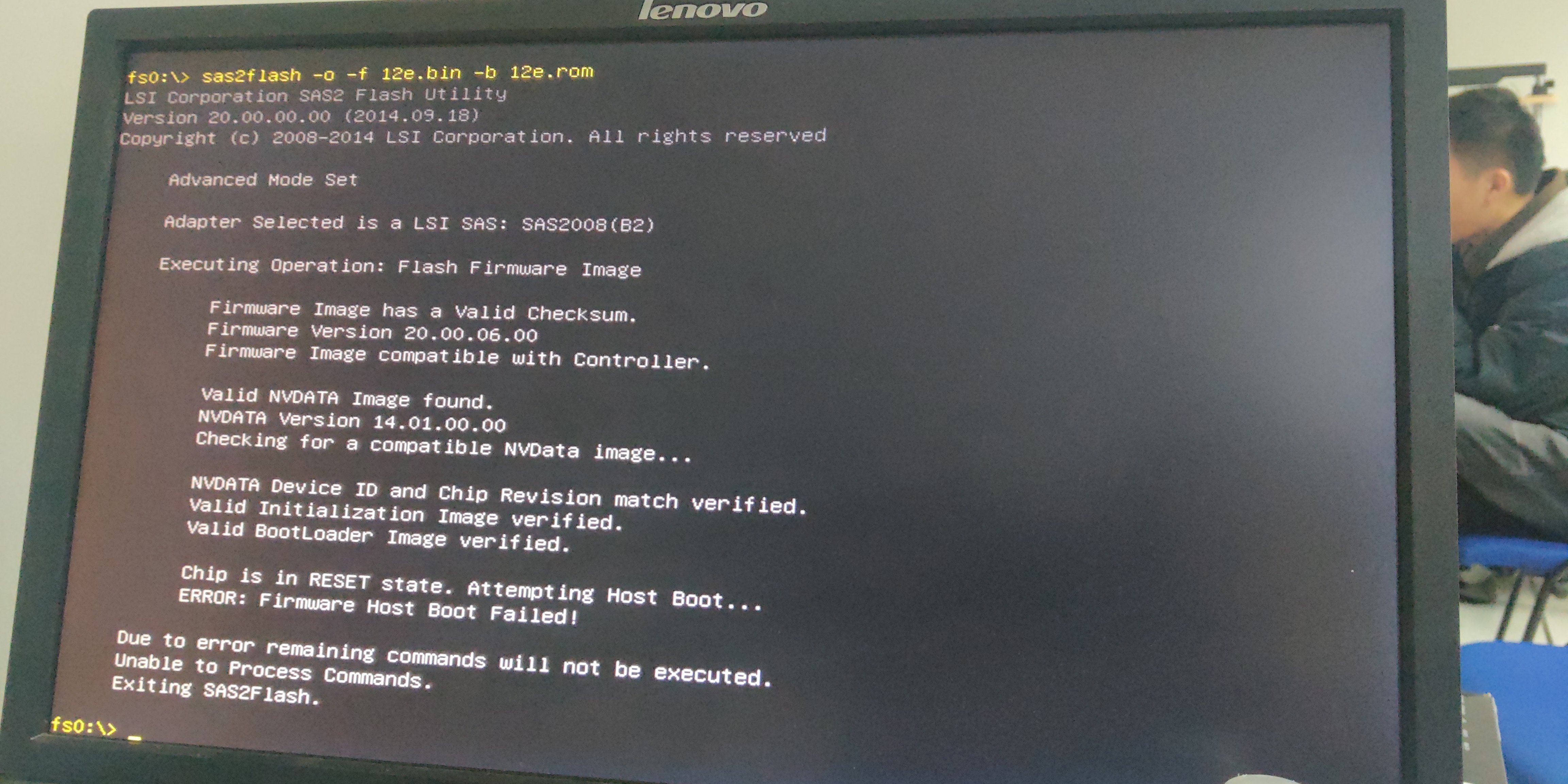

sas2flash.efi -o -f <firmware name>.bin -b mptsas2.rom
12e.bin and 12e.rom  is the firmware and bios P20 version  what i renamed  id。
