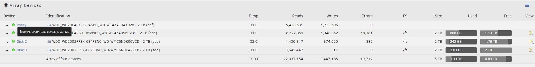

I have quite a simple unraid setup.
2TB - WD Green (Parity)
2TB - WD Green (Disk 1)
2TB - WD Red (Disk 2)
2TB - WD Red (Disk 3)
I originally started out with just the two greens then later added the Red disks as I managed to get them off a friend brand new for free. These are roughly 2 weeks old.

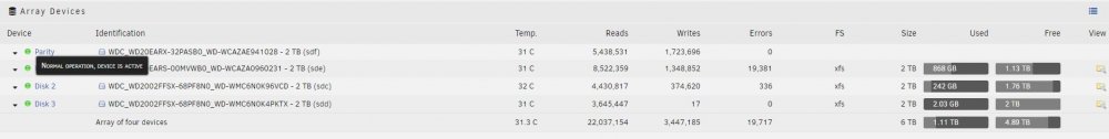

As of today I noticed a few notifications about `reallocated sector ct is 160` (Disk 1) I noticed this number is climbing, so I immedaitely started copying data from this drive to another drive (Disk 2). Now I am about 20% through the copy and have noticed that Disk 2 is showing as errors, however smart scans on both drives are passing so I am slightly confused as to what is happening here. My immediate plan is to take data off Disk 1, copy it to Disk 2 and take Disk 1 out of the array. But now seeing errors on disk 2 has got me thinking that this may not be the best plan?
I'd love some input here.

Disk2 looks OK, maybe just a bad connection.
Disk1 not OK but also not disabled. The normal recommendation would be to replace it, but you mentioned removing it instead. Do you mean you want to have one less disk for now? Or do you intend to put another disk in its place?

Disk2 errors were also a disk problem, they were media errors, though they might be intermittent, run an extended SMART test.
Hey I did that before submitting the ticket and it reported everything was ok :)
Yes, missed that, but keep an eye on it as it was definitely a disk error.
