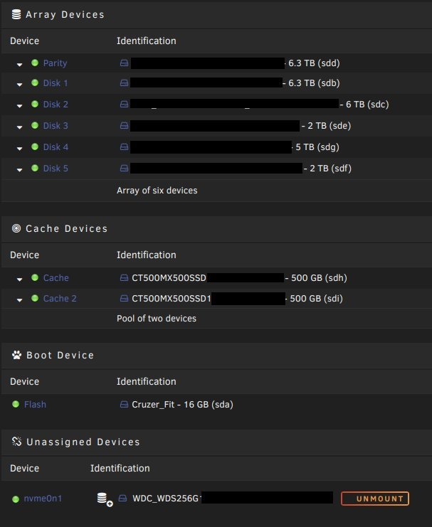

Gotchas? Migrating array to a new server?
Presently I have my array running on a i7-3770
I've finally gotten through testing my new SuperMicro build, and I'm ready to migrate my setup to the new server.
My plan was to:
  1. Back up my flash drive
  2. My thought on doing this was to set the array to not start on boot
  3. Shut it down
  4. Move the drives / flash
  5. Boot and if that goes well, start the array
Are there things I should consider aside from that?
Is this the right way to go, is it really that simple and I'm making it more scary than I need to?
Edited by CowboyRedBeard
As long as you have just blacked out all of the identifying info on the drives (in your screen shot), you should have everything covered.  (You should have a printout of the drive assignments as a part of your prep.)  If you have VM's, you will probably have to reconfigure them.
