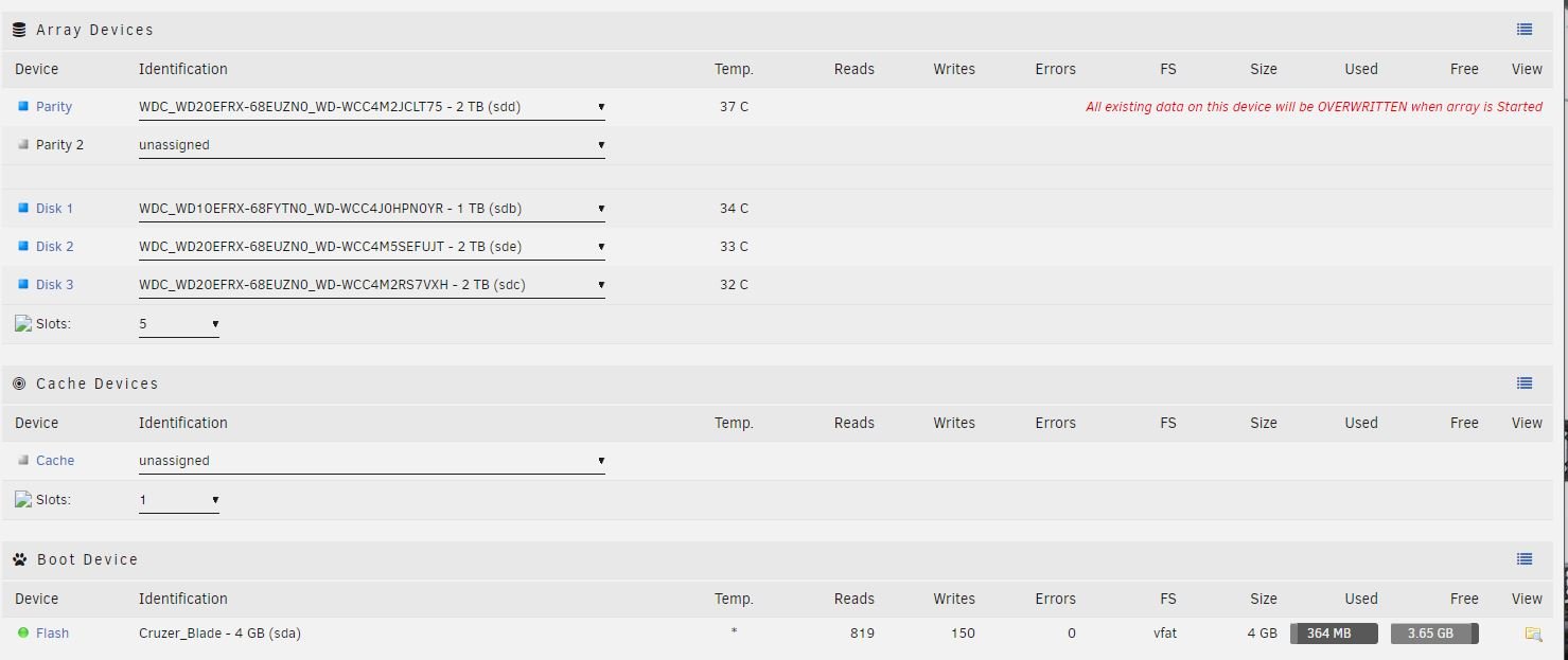

All I have done at this point is run 'new config', and I get this error when I select the previous drive assignments (without applying anything or trying to start/rebuild the array):
  • "All existing data on this device will be OVERWRITTEN when array is Started"
  • The parity and data drives are listed as "new devices"
Have I cooked the array? The data, drives, and parity should all be correct and intact, I haven't done anything since except reboot once.

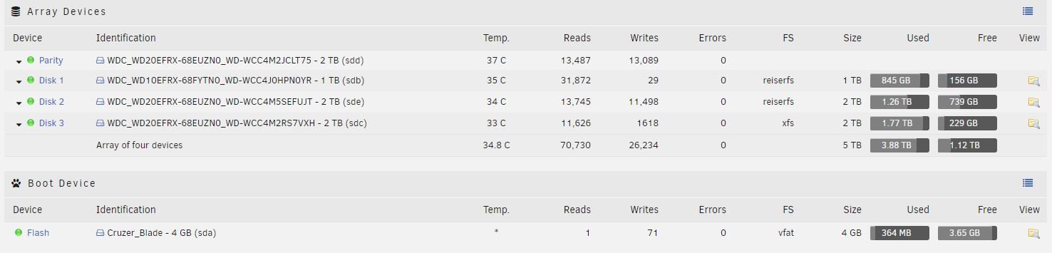

I have already confirmed a new config, initially I had selected "preserve parity drive" thinking I could have the array rebuilt and shrunk from parity with a drive missing. I think this is grossly incorrect now.
See the attached pics, 'nas drives' is a screenshot of the valid raid array right before applying the 'new config'. The next pic is what I'm seeing when I try to re assign the drives.

22 minutes ago, trurl said:
Or, there should be a check box saying parity is already valid, and that should make that message go away if you check it.
The message won't go way, but parity disk won't be touched, array will remain as it was.
You were both right, I had previously not seen that check box. After checking it and starting the array it picked up everything immediately.
