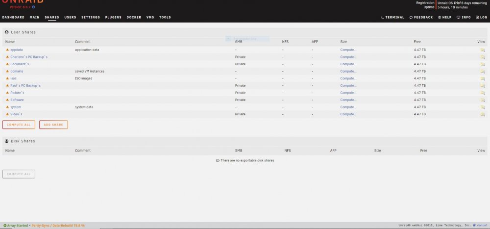

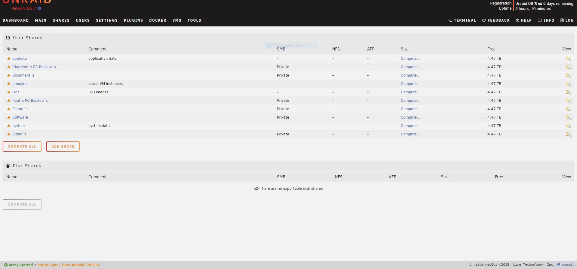

Cant add share
when i click to go and add share the page goes blank.
http://192.168.0.13/Shares/Share?name=

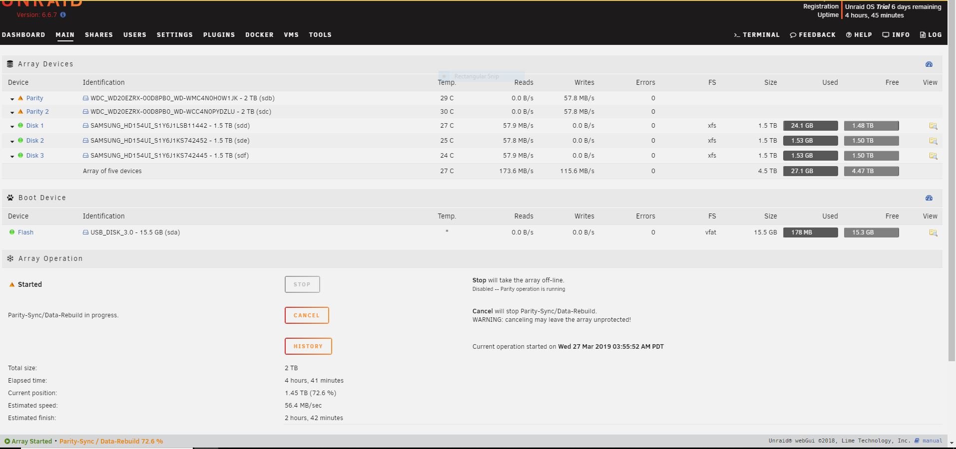

could you tell me why the total says 2TB when there 4TB of parity ?
Edited by Guest
Each parity is independent and don't add together.

1 minute ago, jondak said:
You are using 2 parity disks. They are not cumulative.
https://wiki.unraid.net/Parity
