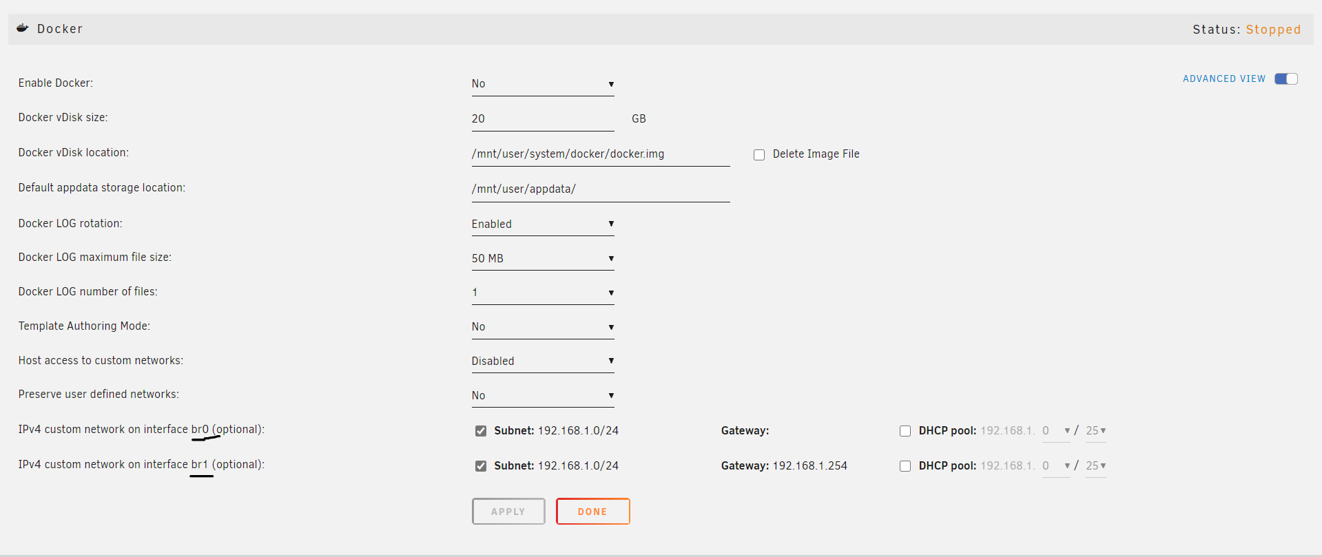

Thanks it's work for the vm but my docker don't see the new interface.
You need to tell docker about the new bridge by going to the Settings | Docker Menu. Stopping the docker engine will then let you edit the networks and allow you to define the IP and gateways for the internal network.
In docker i don't see my virbr0...
Its been a while, but I think the docker settings page limits which network interfaces it will display.
You need to enable "Preserve user defined networks" in the Docker Settings, then in the command line run something like
# docker network create \
-o parent=vibr1 \
--driver macvlan \
--subnet 192.168.1.0/24 \
--ip-range 192.168.1.128/25 \
--gateway 192.168.1.1 \
labnet
Adjust the IPs to your needs. Unfortunately, docker won't let you create a network without a gateway defined and imposes a few other annoying constraints on docker networks.
ok thanks i will test.

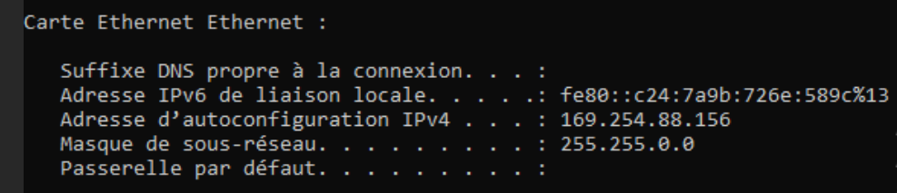

You know if for the virtual network that i have created with your method we can define an ip and a mask by default and gateway ?
because on this network I create a virtual router which works when I but the ip manually in my vm w10 but the dhcp does not work my vm takes an ip in 169.254.88.156 by default while my network is in 192.168.0.0 .
Thanks for your help.
i found the solution i edit my network for that
