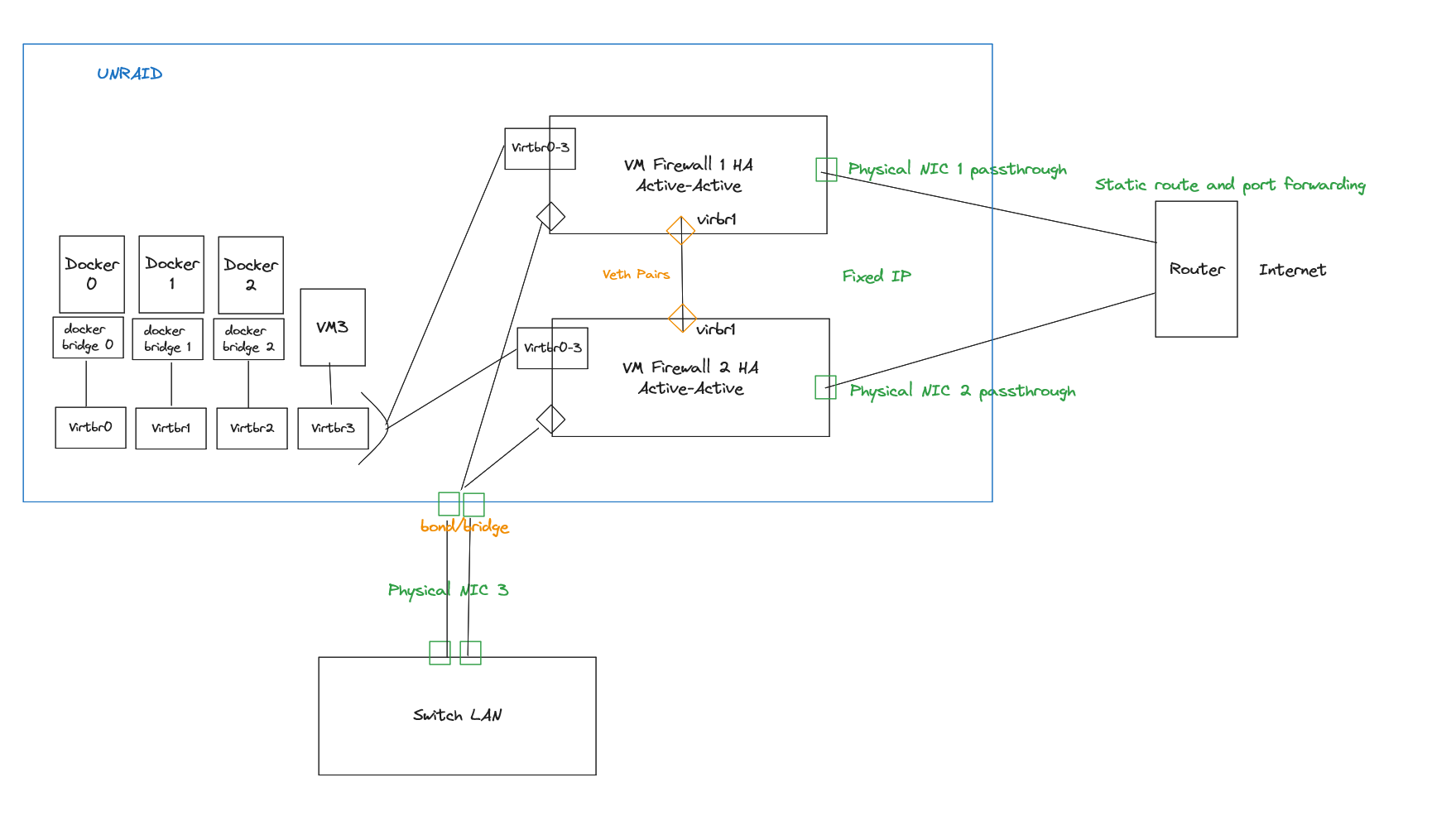

I made a diagram because what I want to achieve is more complex than I thought
Is this even possible with unraid? a virtual switch with vlans? what would be the expected performance?
This is the firewall HA arq
Edited by L0rdRaiden

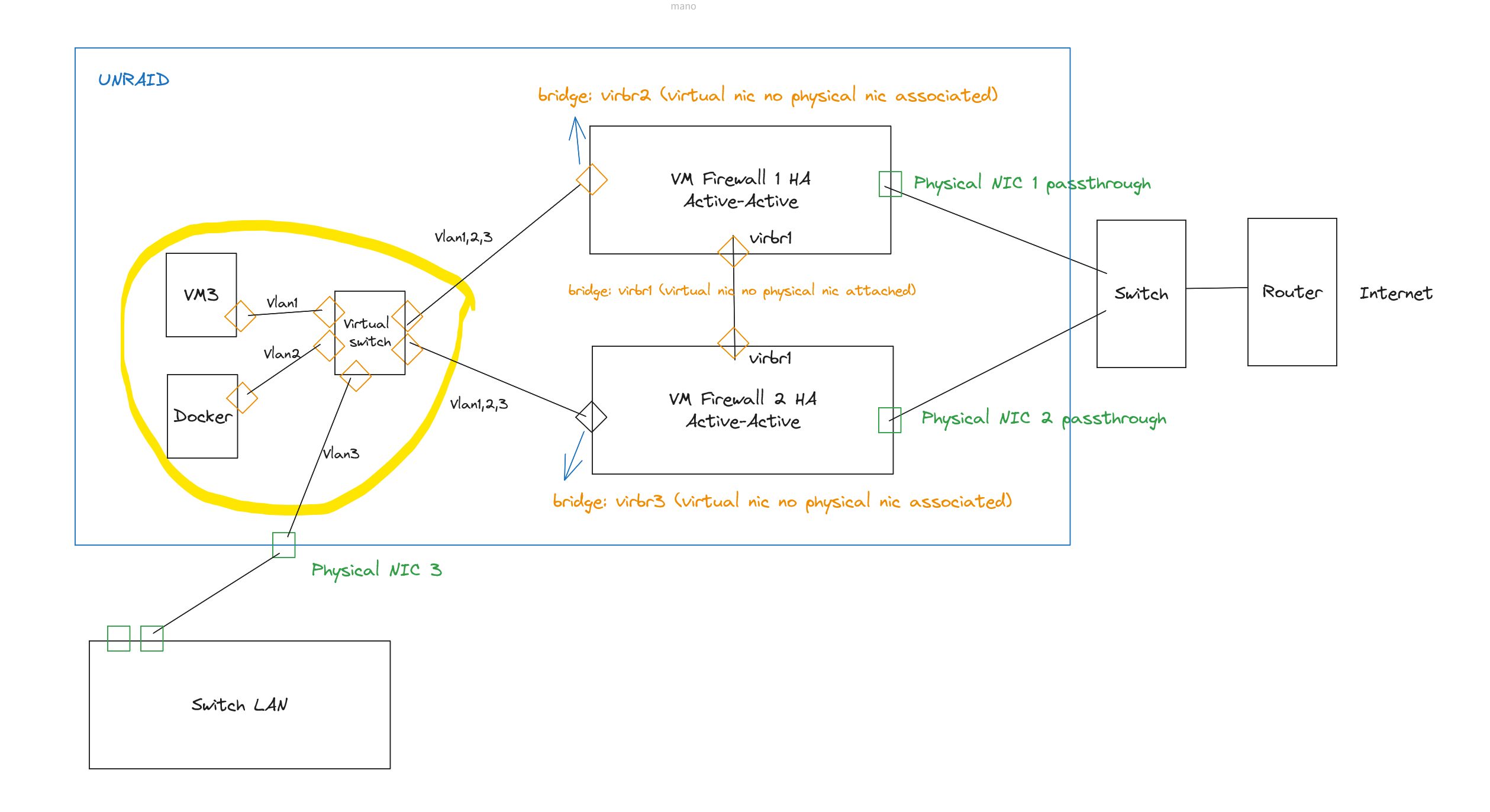

I think this draw is more clear
In this case the containers inside the docker bridge network would be visible to the firewall?
Or docker bridge mode will NAT everything?
I mean if a container in docker 0 communicate with a container in docker 1, what source an dest IP will I see in the firewall?
