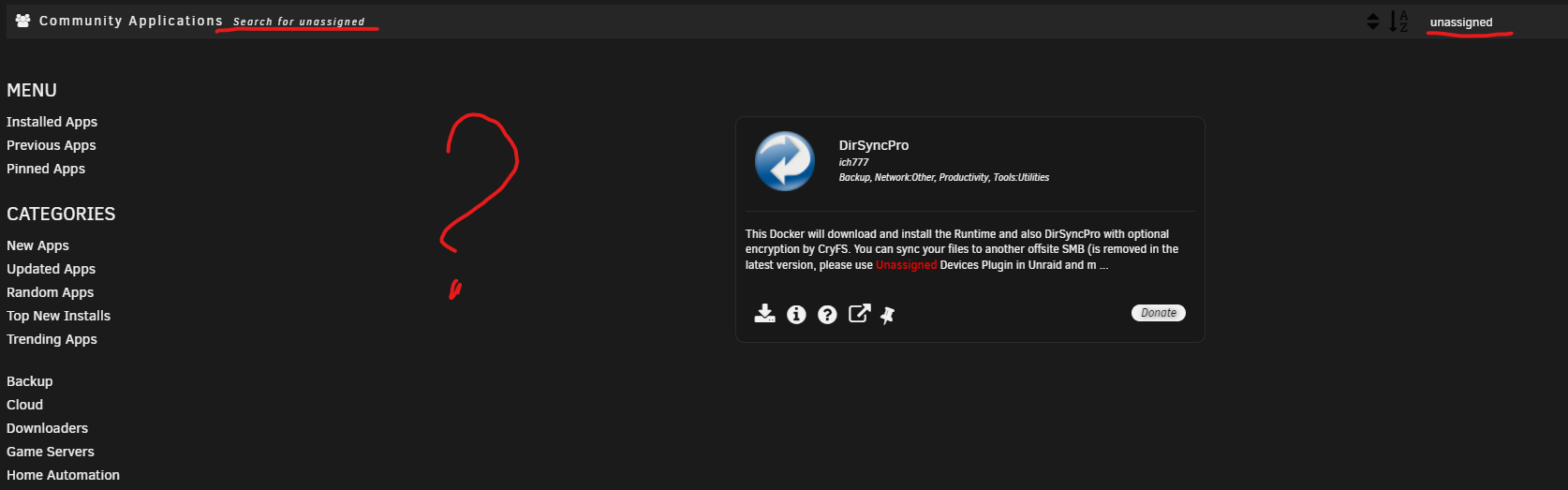

Good day everyone,
I'm having some trouble accessing my unassigned devices and through searching through the web and various forum topic, I'm under the impression that I need to direct to a path "/mnt/disks". As can be seen in the attached screenshot, "disks" is not showing up as an option and so I'm reaching out for some help from this group. If there is any other config info you'd like me to post in here, I'm pretty green at this so please give me clear instructions on how to get log files or others to post if requested. Thanks!

You either don't have Unassigned Devices plugin installed, or have nothing mounted with it.

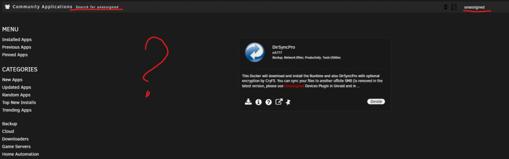

Unassigned Devices doesn't appear to be there in the community Apps as per the directions I find online. Since it's a plugin, should there not be a URL to install the plugin? Am I missing something here? (obviously I am hence I need your patient help) :)

Upgrade your system.  It's running an old version of the OS, and UD is not compatible anymore with it.
Both plugins and docker containers should be installed via Community Apps nowadays.    The unassigned Devices plugin is definitely available there - I have just checked on my system.

Well that did it... Unraid Community +1 yet again... thanks!

I think I figured out why I was running an old version of the OS. I'm using the Unraid Nvidia plugin for a Win10 VM and it only has Unraid Nvidia version 6.6.7. I expect that's what was messing things up for me.
The Nvidia plugin has the current Unraid release (6.8.3)  available so that should not be a problem.    Note however that the Nvidia plugin is irrelevant if using a VM as the VM supplies the Nvidia drivers - it only matters when using Docker containers where you want hardware transcoding support.
