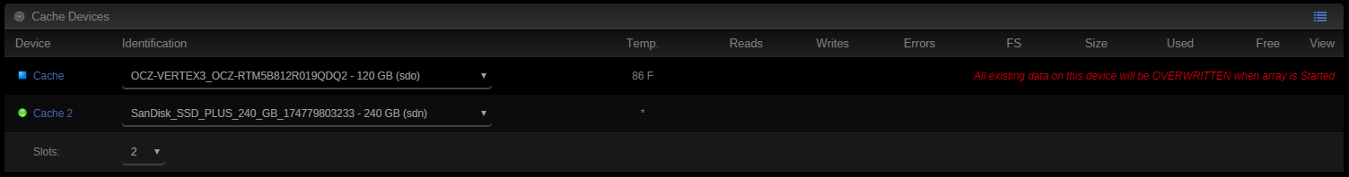

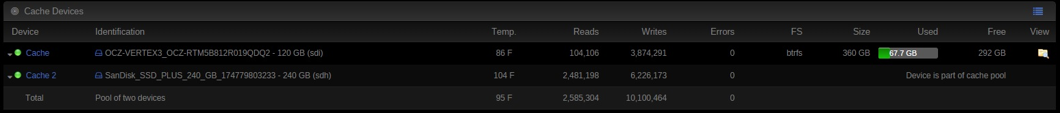

This is what it looked like originally.
This is what it looks like now. The 120gb OCZ shows as unassigned, but if I assigned it back to the first slot in the cache pool, it looks like this:
Does this help? I'd really like to get my dockers and VMs back. Should I just let Unraid reformat it, and can I then just copy the data back?
Thanks for your assistance!
Likely the pool is still working, but if you assign the missing device as is it will format it and make the pool unmountable, to confirm mount the device again with the UD and post the output of:
