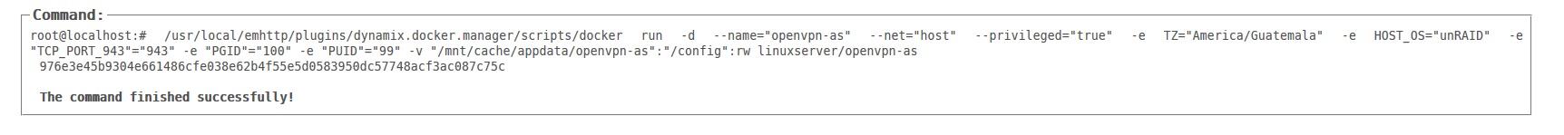

I have installed openvpnas using the Community Applications in unRaid 6.2 but it didn't work. As least not until I found out that I needed to add an additional environment variable INTERFACE and set to bond0. Can you please update the unRAID template to include this environment variable? I also note there is no documentation (that I could find) on how to actually install in unRaid. Its really hard when you have to scrawl through pages and pages of the community forum to find anything out.
I did a video guide for this a few posts up, although it doesn't mention to add that variable for bonded connections!
Remember the guys who give us these dockers etc do so in their spare time. They may not have hardware configs set up in the same way, as some of us may. ie bonded connections etc. So they can't test all conditions. As such these things can easily get overlooked, which is probably why it's not in the template.
I know that some devs don't even use the dockers for their own daily use, they just convert them for us to use in unRAID.
Sometimes if you can't find the info you need in the threads for the docker, then its worth posting in and checking the official forums for that particular application  :)
The variable is not in the template, but it's clearly stated on our github readme for the container, and there is a handy github link in the OP for this image, and all our LT forum support posts for our images contain the relevant links back to github in the first post.

Thank you very much for the help, bonding was enable.
