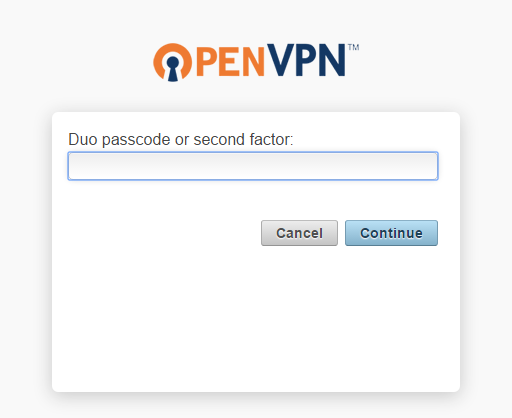

I've added Duo Security for Two-Factor Authentication when using this container. They have a free user tier which allows < 10 users.
It will basically send a push request / sms to your mobile phone as an extra confirmation when logging in from the Web Interface (for those who have this exposed to the internet). I've followed the steps described here https://duo.com/docs/openvpn and modified them a bit.
[*]download and edit duo_openvpn_as.py with secret key etc as described in the link
[*]move duo_openvpn_as.py to /mnt/cache/appdata/openvpn-as/scripts
[*]docker exec -it openvpn-as /bin/bash
[*]chmod a+x /config/scripts/duo_openvpn_as.py
[*]/config/scripts/sacli -a <admin_user> -k auth.module.post_auth_script --value_file=/config/scripts/duo_openvpn_as.py ConfigPut
[*]/config/scripts/sacli -a <admin_user> Reset
[*]Restart the container
Now you have 2FA for logins.
index.php?action=dlattach;topic=43317.0;attach=40568;image
Write "push", "sms", "phone" and click connect, and you will receive a 2FA.

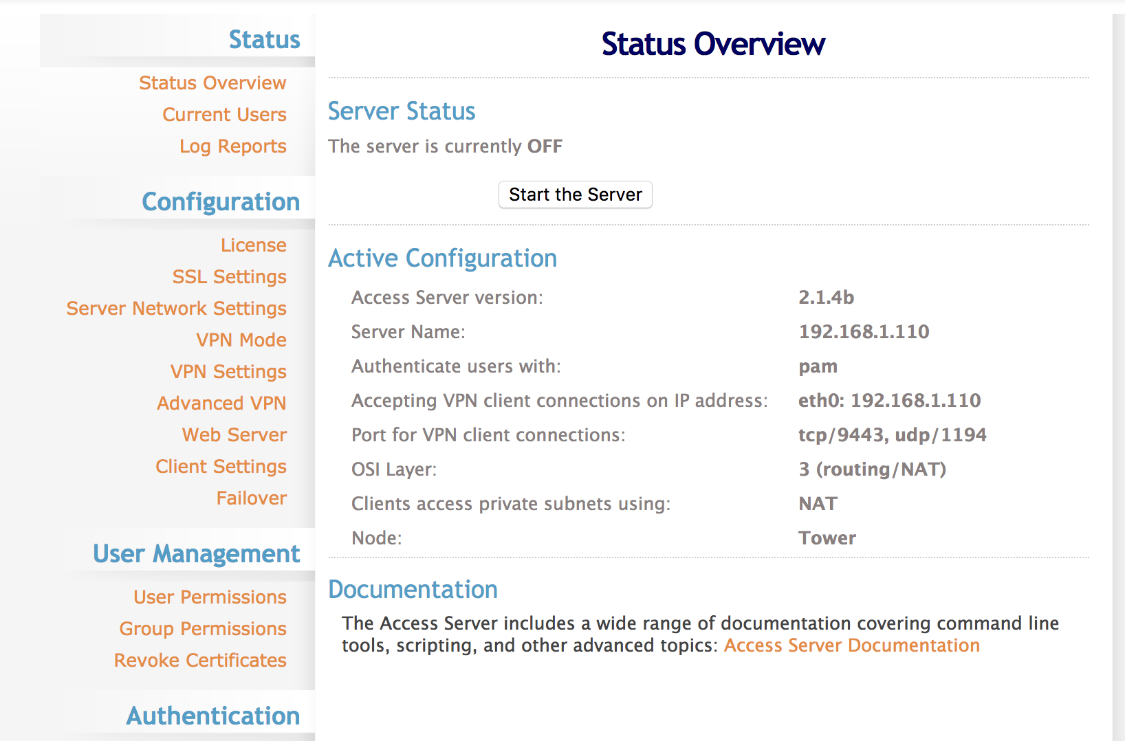

sooo openvpn-as is now up to version 2.4 but I only seem to grab 2.1.2 .... am i missing something?
the image pulls version 2.14b which is the latest package available
you however may not the latest copy of the image. this was updated back in october 2016, so you're way behind in image updates.
hmmm I just tonight told it to update from the Docker tab. I take I just need to delete the whole thing?
So I removed the container and the image. Repulled from CA and I'm still looking at 2.1.2
Would it be because I reused my appdata folder without emptying it?
EDIT: [sigh] yup that was it. cleared out appdata. I'm sure somewhere in this thread it is mentioned.

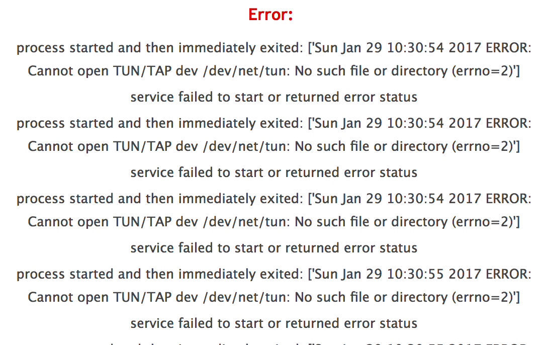

So I have been trying to set up OpenVPN-as on my unraid server, and I keep getting this error when I try to start the OpenVPN server:
process started and then immediately exited: ['Sun Jan 29 10:21:33 2017 ERROR: Cannot open TUN/TAP dev /dev/net/tun: No such file or directory (errno=2)']
service failed to start or returned error status

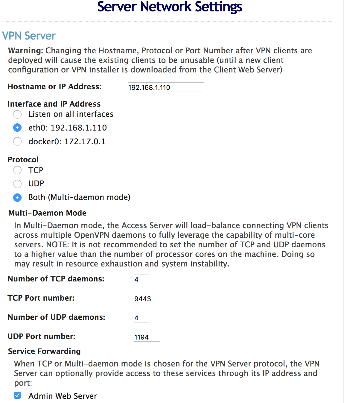

I attached some screen grabs if that helps.  BTW, I took out the forward facing subdomain just for security sakes.  The one in the screen grab is not the real address.
Here is another screen grab
And one more of the error I get when I try to start the server
