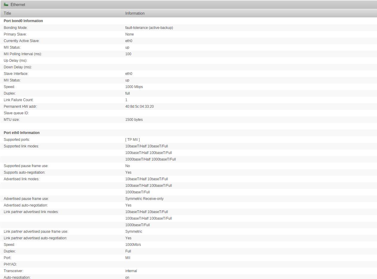

    Ok, I used to be able to connect to Host network with this before the update....that allowed me to be assigned an IP on my WiFi subnet, which then allowed me to access the UnRAID GUI interface.
[fix-attrs.d] done.

Here is this as well if it helps.
590f78c7ea343_2017-05-0715_41_52-unRAID_SystemProfiler.thumb.png.95c95c12f4d49944a02e8a4e9df506a8.png
Why have you got bonding switched on when you only have one ethernet? Turn it off, and remove the INTERFACE variable.
Thank you!  All set.
