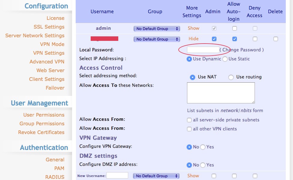

Still can't get this to work with "Local".
Steps I took-
1) Completely deleted the docker, img and appdata folder.
2) Re-installed.
3) Logged into admin with default admin/password.
4) Set authentication to local. Saved and refreshed server.
5) Changed admin password via CLI.
6) Added new user via CLI.
7) Added same user via admin page with options "Allow Admin" "Allow Auto Login". Saved and refreshed server.
8 Attempted to login using newusername/password via https://<IP>:943. Login Failed.
Logs show this-
local auth failed: no stored password digest found in authcred attributes: auth/authlocal:35,web/http:1609,web/http:750,web/server:126,web/server:133,xml/authrpc:110,xml/authrpc:164,internet/defer:102,xml/authsess:50,sagent/saccess:86,xml/authrpc:244,xml/authsess:50,xml/authsess:103,auth/authdelegate:308,util/delegate:26,auth/authdelegate:237,util/defer:224,util/defer:246,internet/defer:190,internet/defer:181,internet/defer:323,util/defer:246,internet/defer:190,internet/defer:181,internet/defer:323,util/defer:245,internet/defer:102,auth/authdelegate:61,auth/authdelegate:240,util/delegate:26,auth/authlocal:35,util/error:61,util/error:44
Did I miss a step to setup local authentication? Looks like the docker isn't storing credentials locally but I have no idea why.
Edit: Looks like I DID miss something.
Just adding the password via SSH isn't enough. It has to be added in the admin page as well.
Wonder what else I missed?^_^

Why are you adding users through command line? You are creating more PAM users as that cli command in the docker description was posted to modify the admin user, which is a PAM account.
Create new users (and manage them) through the gui and don't mess with command line

Thanks. I was following @gridrunner's video guide. He didn't really go into detail about where the users were being created/modified. Makes a lot more sense now why it wasn't working. Thanks.

6 minutes ago, ice pube said:
Sorry if this is too general a question but my google-fu is weak today. I followed Spaceinvader's youtube video along with the recent posts.
I had the same issue.
Using command line doesn't setup your user in the local db. In the GUI there is a "More Settings" tab for each user. You must enter the password there then save changes and update the running server.
If you look at my post up a couple there's a screenshot.
Edited by wgstarks
7 minutes ago, ice pube said:
But in one of the replies above it says to use the GUI. I will try again with using the commandline.
That's correct. As I said, use the GUI not the command line.

Check this screenshot. It shows you where you need to configure the user password. Doing it on the command line won't work with "Local".
Yeah I did that, I created the user using the GUI as well. Do I create the user in the CLI and then again in the GUI and set the password at the same time?
No. You only need to create the user in the GUI. The cli is only needed to change the default admin password.
