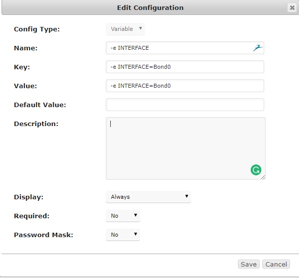

Im having same issue as most , static dns as Google , host with privilege, no gui , if i set to bridge mode it works and i get web gui but the way its spose to run has issues, i have this on few docker apps if host mode dont work bridge mode dont and i have pfsense router

2 minutes ago, CHBMB said:
Are any of you guys using bonded network on Unraid, if so, you'll need to add an extra parameter...
https://github.com/linuxserver/docker-openvpnas#parameters
yep i am , i turn it off on test server and it started working so what best set up for multi eth connection ?
I linked to it....
Set a variable and use bond0
Edited by CHBMB
I linked to it....
-e INTERFACE , bond0
5 minutes ago, CHBMB said:
Or add it in the webui.
adding it as variable at working at mo im sure its how im adding it
10 minutes ago, CHBMB said:
Name = Whatever you want - irrelevant
Key = INTERFACE
Value = Bond0 or bond0
bond0 work , thanks for sticking with me through that !!!
NP, yeah Linux is case sensitive so Bond0 and bond0 aren't the same.
