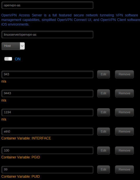

This is the 2nd time I've tried installing OpenVPN-AS, and I've had trouble logging in as any user other than default admin both times.
Here's my config screen:
Per the recommendations at Linuxserver's site, I've created a new users "localadmin":
I usually use KeePass to create long, complex, random passwords, but, because I've been having issues (which I thought may be related to pasting the password into the telnet session), I created a simple password for this account that I knew I could type correctly.
I've granted this new user admin rights:
I have authentication set to local so my users & passwords survive reinstall:
Yet every time I try to log in as my new "localadmin" I'm told that it's an incorrect login:
I've attached the log after the most recent login attempt.
If someone would point me in the right direction, I'd be most grateful!
openvpn.log
Linuxserver site does not tell you to add users through command line.
I repeat, do not add users through command line.
Follow the steps in the original post. They're super simple.

7 hours ago, FreeMan said:
That did the trick!
I really appreciate the work @gridrunner has done with his video, but it seems that it really needs to be updated. Additionally, since so many places around here point users to that video, it would be super helpful if the linuxserver page contained a couple of notes on what's out dated and the current best methods. (hint, hint, @CHBMB :) ).

Thanks! I did get that part sorted with wgstarks' help.
I'm still struggling with the timeout issue when I try to connect with the openvpn client, though. Any thoughts on that?
Sent from Tapatalk
Just to be sure, you do have the proper ports forwarded to the docker in your firewall right? That’s the only problem I have ever had when trying to connect to my docker.
I have 943 forwarded, do I need anything else?
Sent from Tapatalk
Sent from Tapatalk
1194 UDP (default) or whatever port you have specified as Host Port 3 in the OpenVPN Server docker should be forwarded.
Well, that could well be the issue... Will adjust as soon as I get home and try again.
Thanks!
Sent from Tapatalk
Thanks!
Sent from Tapatalk
The client can't connect if the port on which the server is listening (UDP port 1194 by default) is not accessible through the firewall.
It actually defaults to two ports. UDP 1194 and TCP 9443. If you have gotten the paid license for OpenVPN that allows more than two users you may need both ports. My understanding is that they alternate for load balancing.
Good point.  I have only used the free version and rarely have more than one connected user, so, I have only forwarded UDP 1194 and that has been sufficient.  I assumed, perhaps incorrectly, that FreeMan - as his names suggests - was only using the free version :D)
Edited by Hoopster
@Hoopster and @wgstarks - shocking, I know, but I opened those ports and now I can connect with no issue at all.
I guess I was just busy having a brain dead evening. Thanks for the help.
I am using the free version and probably will continue with that, but I may pony up for the paid version, depending on how much the kids use it.

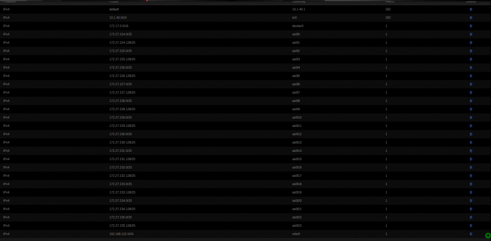

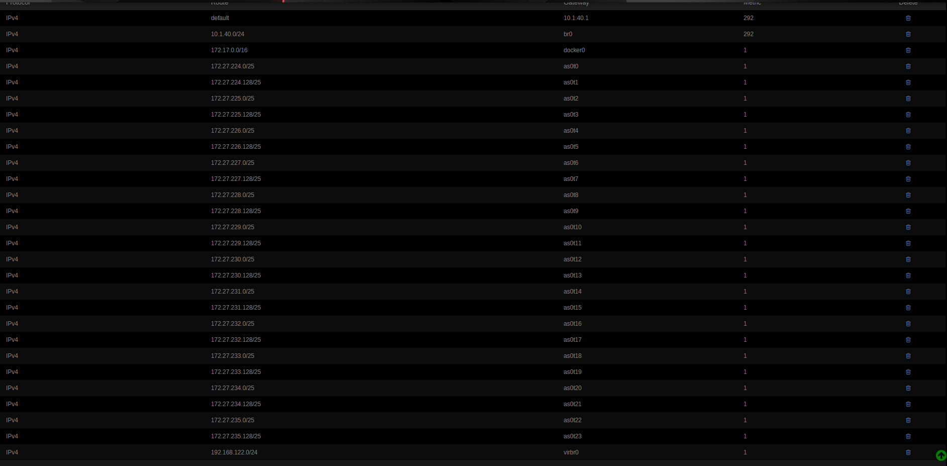

is this norm to make these many Routing Tables?
