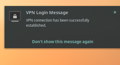

Might be a very silly question but has anyone ever managed to get this to work on a linux OS ? i recently switched from windows to linux mint 18  and ive tried following the very simple instructions of creating a new connection and tried launching it from the terminal nothing seems to be working for me
I've had it working on Ubuntu as a client.
what did you do to set it up ? im fairly new to linux but not a newbie to tech ive tried getting this thing going using the network manager and it just will not connect no matter what it connects if im on windows using the openvpngui or on my android smart phone so what gives here ?
Just tried it on Solus as well and it worked fine.....
Download your profile onto your Linux machine, go to network, add VPN, choose option "From file" click add.
You need to be outside your LAN to connect to it though, I use a hotspot on my phone and a 4G connection to test

so here is what i ended up doing i loaded up solus and imported the config file and it worked with no problem i then found the directory where it made the certificates
and then copied them to a usb stick i also made sure to take note of the settings used in the openvpn plugin and copied them exactly. after reinstalling linux mint and i was able to connect both in solus and in linux mint the last hurdle for me now is that i cant connect to any shares or my unraid server. though when i use teamviewer to access my home network and launch the openvpn docker it does show my 1 client as connected am i missing something simple ? to be clear i do connect successfully via vpn but cant access anything on the network
