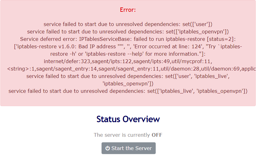

On latest RC, I am getting this issue when starting the server from within the docker's webui:
service failed to start due to unresolved dependencies: set(['user'])
service failed to start due to unresolved dependencies: set(['iptables_openvpn'])
Service deferred error: IPTablesServiceBase: failed to run iptables-restore [status=2]: ['iptables-restore v1.6.0: Bad IP address ""', '', 'Error occurred at line: 148', "Try `iptables-restore -h' or 'iptables-restore --help' for more information."]: internet/defer:323,sagent/ipts:122,sagent/ipts:49,util/mycprof:11,<string>:1,sagent/sagent_entry:14,sagent/sagent_entry:11,util/daemon:28,util/daemon:69,application/app:423,scripts/_twistd_unix:202,application/app:445,application/app:348,internet/base:1166,internet/base:1178,internet/epollreactor:194,python/log:85,python/log:70,python/context:59,python/context:37,internet/epollreactor:223,internet/posixbase:191,internet/process:260,internet/process:762,internet/process:775,internet/_baseprocess:60,svc/pp:117,svc/svcnotify:32,internet/defer:238,internet/defer:307,internet/defer:323,sagent/ipts:122,sagent/ipts:49,util/error:61,util/error:44
service failed to start due to unresolved dependencies: set(['user', 'iptables_live', 'iptables_openvpn'])
service failed to start due to unresolved dependencies: set(['iptables_live', 'iptables_openvpn'])
getting same, forced update of container, same error, container starts, but service in container fails with error below
Error:
Service deferred error: IPTablesServiceBase: failed to run iptables-restore [status=2]: ['iptables-restore v1.6.0: Bad IP address ""', '', 'Error occurred at line: 146', "Try `iptables-restore -h' or 'iptables-restore --help' for more information."]: internet/defer:323,sagent/ipts:122,sagent/ipts:49,util/mycprof:11,<string>:1,sagent/sagent_entry:14,sagent/sagent_entry:11,util/daemon:28,util/daemon:69,application/app:423,scripts/_twistd_unix:202,application/app:445,application/app:348,internet/base:1166,internet/base:1178,internet/epollreactor:194,python/log:85,python/log:70,python/context:59,python/context:37,internet/epollreactor:223,internet/posixbase:191,internet/process:260,internet/process:762,internet/process:775,internet/_baseprocess:60,svc/pp:117,svc/svcnotify:32,internet/defer:238,internet/defer:307,internet/defer:323,sagent/ipts:122,sagent/ipts:49,util/error:61,util/error:44
Getting the same. i got it running once with downgrade to version 150. but when i restartet it was the same again.
Error:
*** Update after some trying. I got it to work. ***
Change the in the Container
Network Type: from HOST to Brigde
INTERFACE:  from BOND0 to ETH0
Hopes this helps somebody :)
Interesting, this got me up and running. Thanks for the tip!
Odd that this container went from NEEDING host network to bridge.

Hi, I have tried this docker on both my Unraid servers (as per SpaceInvader's video; so I think I set up everything correctly).
But I cannot get the server to start; I get the following error(s); same on both.
What I did notice that the server should already be running after installing the docker (and before making some of the changes, like replacing the admin, etc.), but that was obviously not the case with mine.
What am I doing wrong?
If you read a little bit up on this page, you'll find the solution.
OK searched, and although not recommended it worked by changing host to bridge?!
Edited by gerard6110
