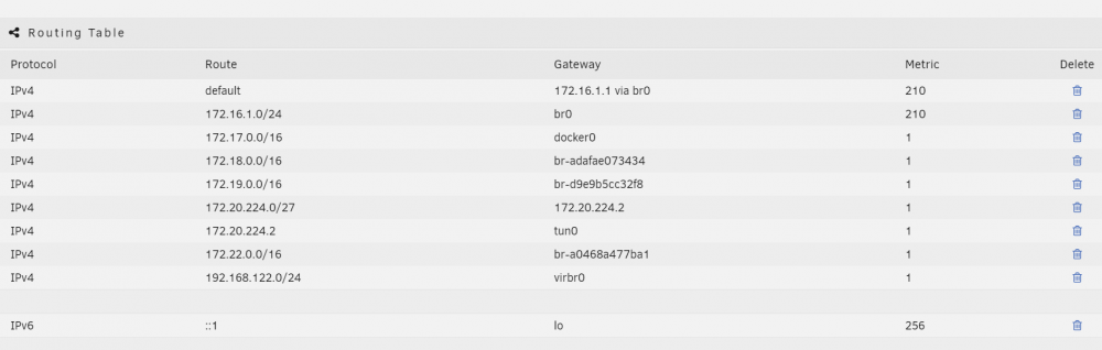

Well.
When you go settings > network settings
Then you scroll down to routing table and you should be able to see
Route (VPN server ipaddress).
Gateway (tun0)
Metric (1)
If this information is not added then your VPN server won't know where to go.

Actually, it's supposed to create a route automatically. Now in version 6.6.6 it's working perfectly
And it has to show. If it doesn't show then the network is not created, meaning it won't connect.

Well I looked at other users and it seemed to eb an issue when the docker is connected to the host network, which creates a tun route. I tried on bridge mode and it works. Same as the other users
