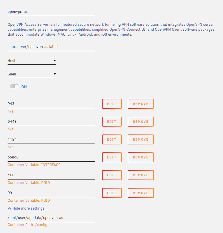

8 hours ago, thepawn713 said:
Yep!  It's been working fine for months and has just recently stopped.
Your screenshot shows host networking with bond0 as interface

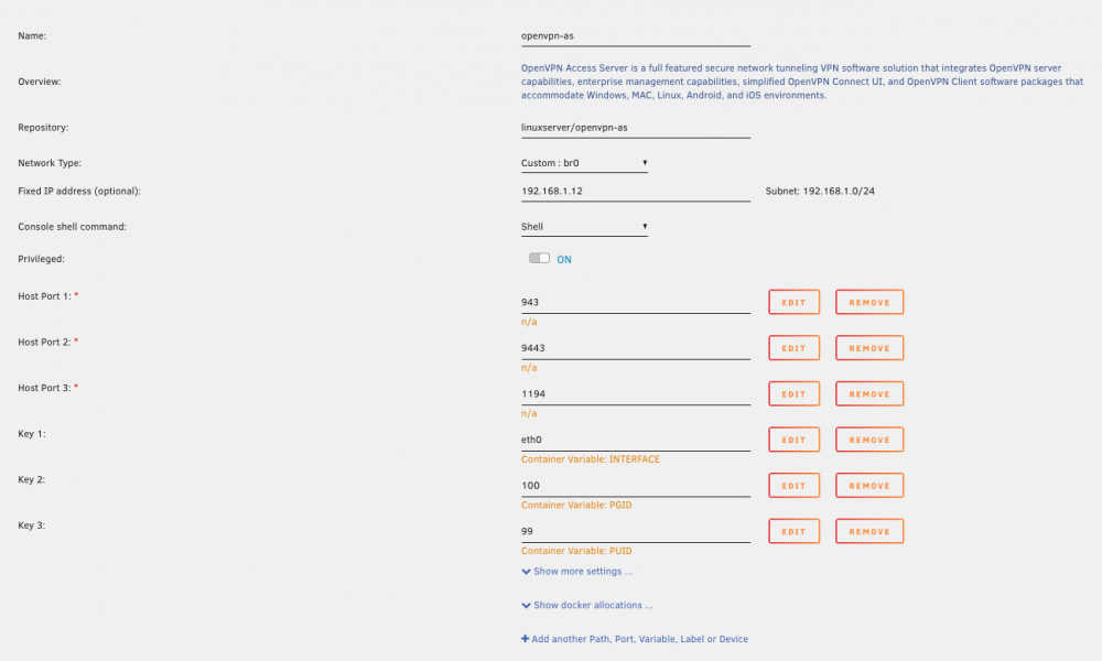

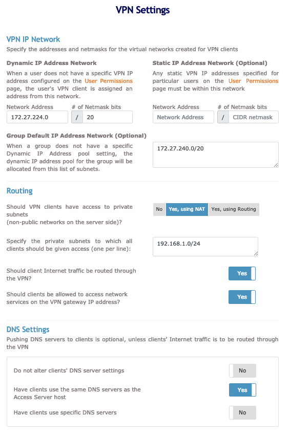

Hi!
I am trying to get the openVPN docker to work, I have followed the guide that Spaceinvader One have made.
I am using the openvpn app on mye iPhone. I used the client.ovpn file for setup.  The app says that i am connected and i can also se my phone listed under devices in the webUI. But I can not reach the internet or my server.
I have port-forwarded the port to the IP address of the VPN server.
What can be the problem?

2 hours ago, Martinoaa said:
Hi!
Think in your docker config you need to change the INTERFACE to br0 to match network type, also in openvpn gui, check what interface is showing there...It's one of those things that is wrong.

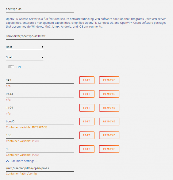

I tried to change it to br0 in the docker settings. But then i cannot open the webGI and my phone cant connect. System Information says that i use eth0 network. Does this have anything to say?

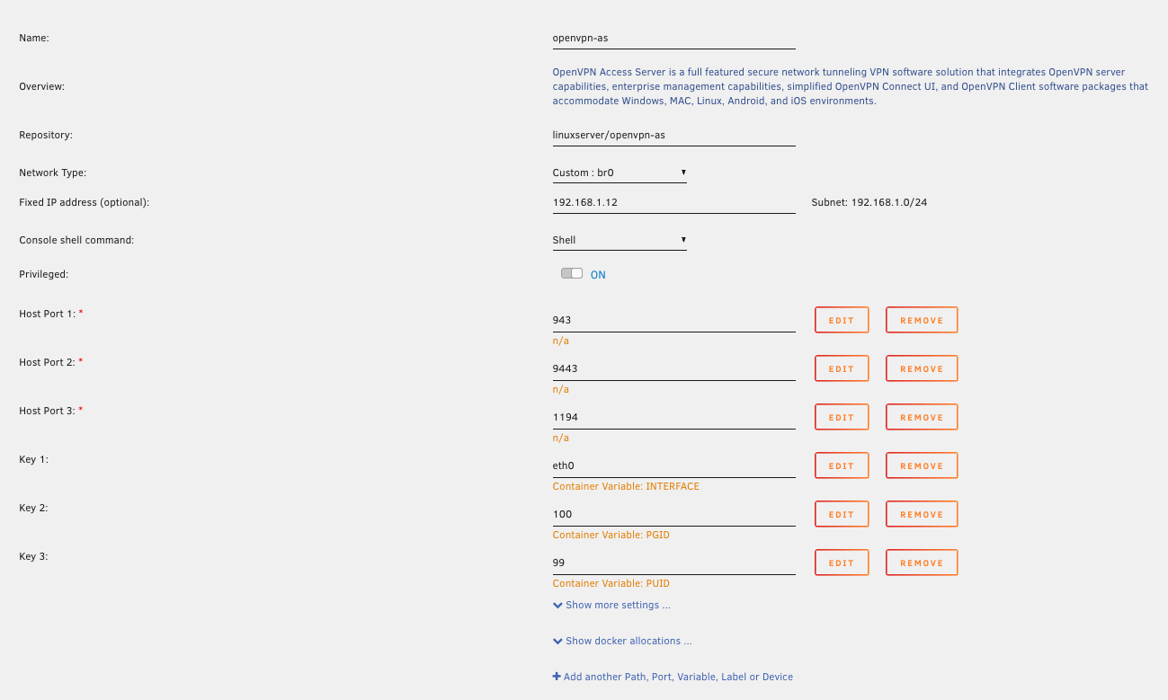

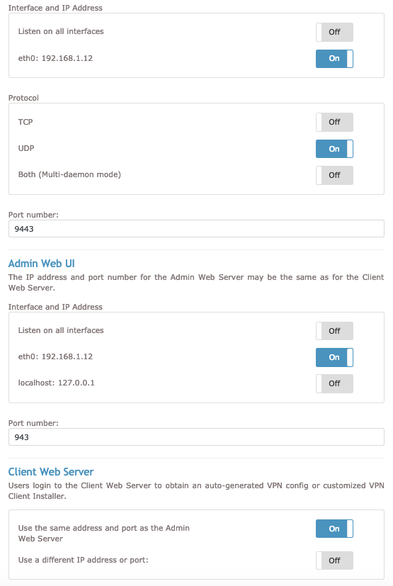

@Martinoaa, sorry I didn't see this until now. Reading your original post again, got me thinking...In the docker global settings (unraid menu > settings > system settings > docker) do you have a gateway address set here? You may have to turn on advanced settings to see that. After that I would try doing a tcpdump in from the unraid CLI (sudo tcpdump host 192.168.1.12) and do a ping from the vpn client to try and reach the gateway, internet, unraid.
Also in the openvpn docker console, do an ifconfig. For some reason, in my current vpn implementation, even though i specified a different physical interface in the docker config, I still had to specify eth0 in the INTERFACE configuration portion for it to work.
I was going to try and look at an old appdata backup, but not clear on where to get that information...but hope that will get you started.
Fyi, the container now contains its own interface called eth0 inside. In bridge networking, this eth0 network gets bridged to the host's interface.
