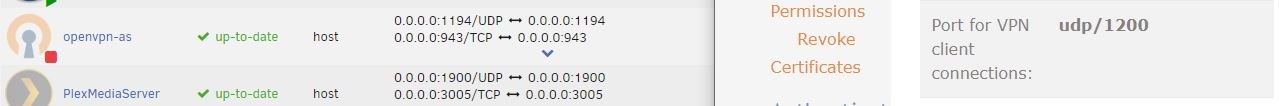

    Ok, I used to be able to connect to Host network with this before the update....that allowed me to be assigned an IP on my WiFi subnet, which then allowed me to access the UnRAID GUI interface.
29 minutes ago, witalit said:

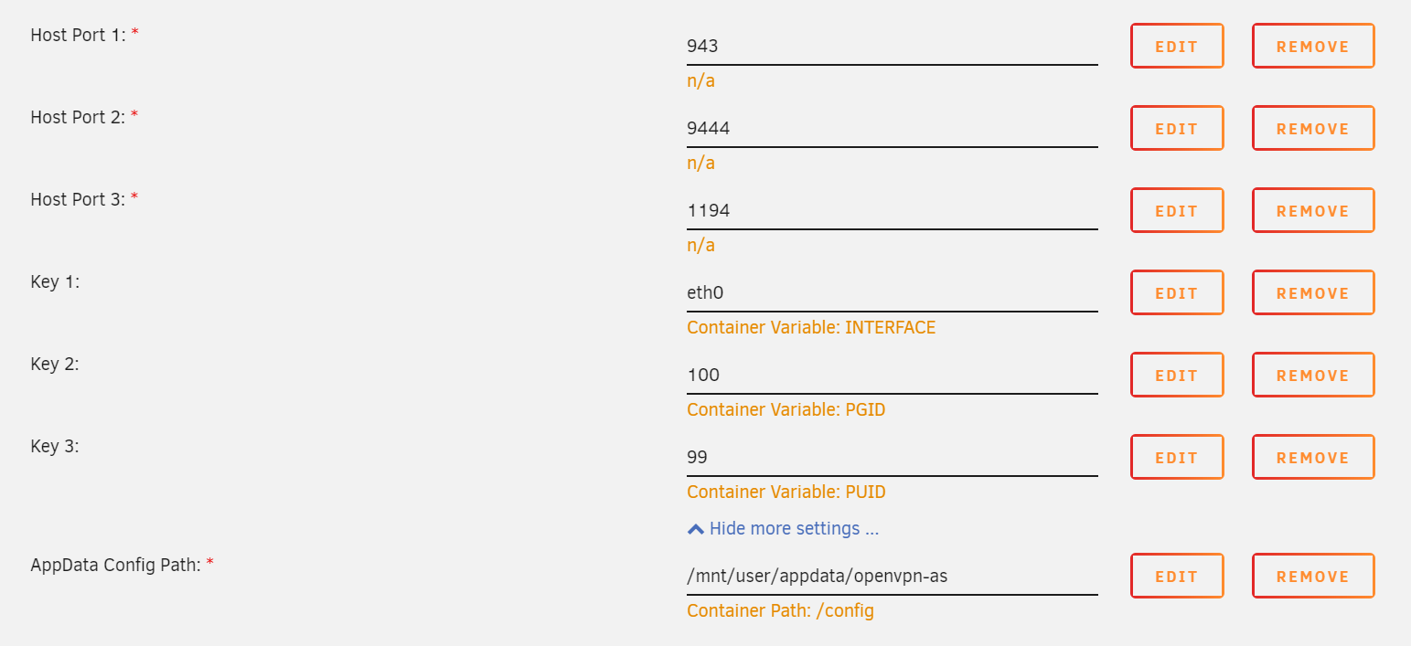

I can't seem to connect to the OpenVPN web portal I get connection refused. I don't have any bonded interfaces just using eth0 in the VARIABLE field of docker config.. any ideas? imageproxy.php?img=&key=00b562fcac28e727
Openvpn-config.pngI think you need to specify an interface on network type, even if it's obvious your going to be using unraid's ip.
What the hell its working now.. I realised I had an old docker appdata folder for OpenVPN. Since wiping that and waiting around 30 minutes are re-installing docker its working.

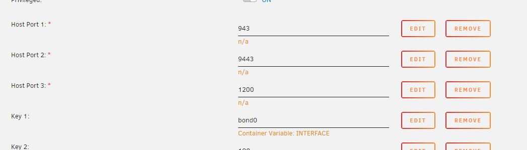

Sorry this Post will not be a lot of help @cheesemarathon but I expierienced also problems after the last update and wanted to notify persons here over my expierience.
I noticed it just today because the WebGUI didn't came up but i didn't change anything on the Container for weeks.
I got a "Connection Refused" on the GUI and I got curious. After that i had done a "netstat -tulpn" on the unraid server itself and nothing showed up. Bot no Errors in the Docker log.
But a deletion from GUI (with active "also remove image"), a "rm -rf openvpn-as" from the Appdata over the console and reinstall of the Template from the WebGUI worked. I just had no internal config of the Container anymore.
@aptalca
On my Side it works with the Setup "eth0" on INTERFACE and also HOST Networking as Containerconfig

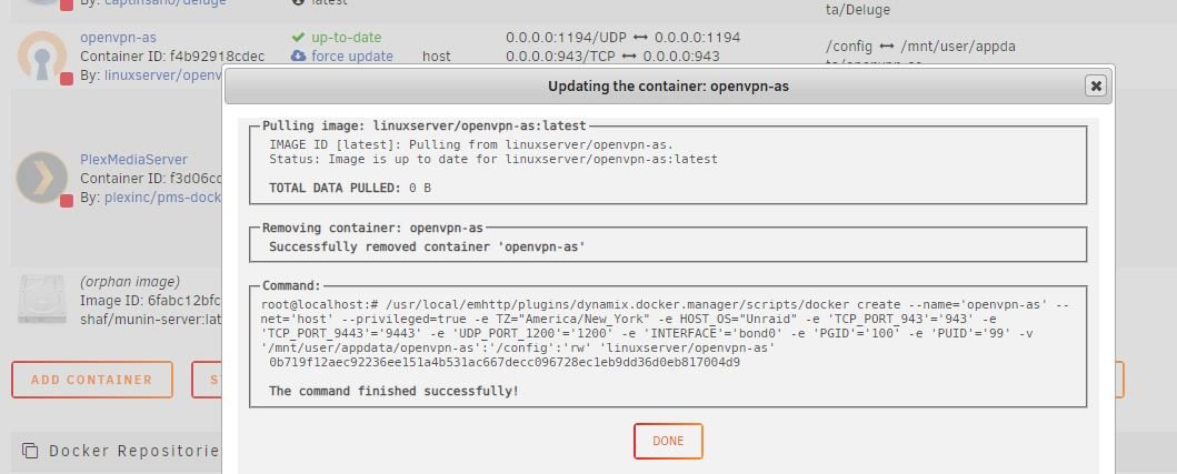

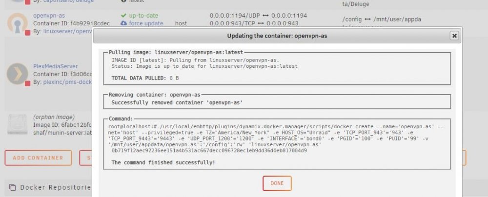

ok i found 2 bugs in this software
when you first install OpenServer AS
and you get the intitial settings   it has 1194  port i set it to 1200
and then when i logged into the server admin  it still kept the port  1194...so i re changed it to 1200 udp
but i just noticed the docker still points 1194 not 1200... so i guess there is a bug its not saving
as you can see 2 out of 3  images show Port 1200  yet docker keeps it at 1194  no matter what you do
reboots  stop start does nothing..  its like Webgui..  the Docker  and the Docker Setting Of Openvpn -as  save 3 different locations for the Port  and not loading the same location

i first did a reboot...  then did a FORCE UPDATE  then a screen shot after it
and no change still forced 1194 not 1200 like its supposed to be
15 minutes ago, comet424 said:
i edited config.json  and changed 1194 to 1200   but didnt help
in next 2 photos...
your screen shots shows that UDP port 1200 is opened on your unraid box,
However the configuration in the openvpn application is a different thing.
thats correct reason i said there is a bug in the openvpn as program
as you see in the previous images...  Unraid is set to 1200 not 1194
yet unraid is reading another file then
