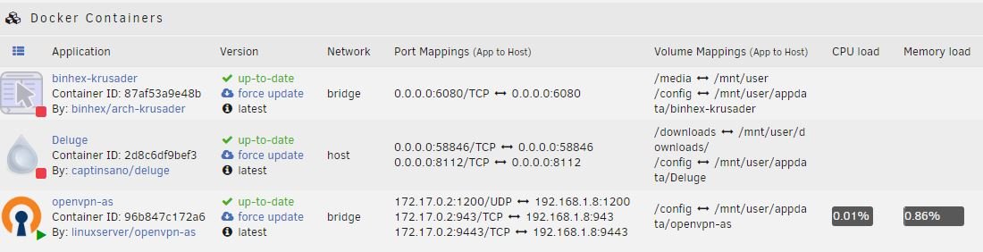

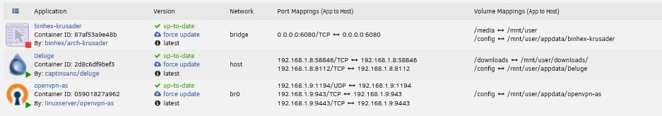

2 minutes ago, comet424 said:
i tried the BR0:   i set it to 192.168.1.9
but still  at port 1194  figured it over right  when i specify a new ip address..   i also Added a port at the bottom you see..  still cant get 1200
Exactly.  As I've mentioned when in HOST or as an unique IP you cannot change the port numbers the app will use.
ya you said that  but you see im not in Host mode im in BR0 mode
and shows 1194 not 1200 like it should be
so its not even showing the 2 1200 ports
well if BRO cant give me port 1200 than what are my options?? since Bridge mode is not an option
or just scrap OpenVPN-AS and find an alternative?
Edited by comet424

45 minutes ago, comet424 said:
ugh  so i cant run  BR0 or HOST as 1200 is what your saying
Yes, that is exactly what they are saying.  Neither host nor custom/Macvlan networks even care about ports.  Only a bridge network uses ports as has been explained several times.
48 minutes ago, comet424 said:
i just tried  just changing to Bridge Mode and then try to use my openvpn client to connect.. but that doesnt work keeps telling me my dns address cant be resolved  yet  it should be working fine
Bridge mode uses ports for external communications.  Although it is not necessary to do so, I setup OpenVPN-AS on two unRAID servers in my LAN.  Since they are on the same LAN, I really only need to be able to connect to one in order to have access to the other, but I wanted to prove access to either via OpenVPN client was possible.
Being on the same LAN, they could not use the same ports.  Of course, the OpenVPN-AS container on both servers is running in bridge mode.
On the second server, I assigned UDP port 1195 (what you are trying to do with 1200) to the second server and TCP port 9444 for management.  Here are my router port forwarding rules associated with both servers:
I have a dynamic DNS name for each server and my OpenVPN client on my laptop has two profiles allowing me to connect to either server by DDNS name and the appropriate ports.
I rarely ever connect to the second server directly via OpenVPN as connecting to the first gives me access to the second which is strictly a backup server and is often not even powered on; however, I just tested it again and it works without issue on the alternate port of 1195.
Somewhere in your Open-VPN-AS container, VPN client, port forwarding rules, and/or DDNS settings, you must have something misconfigured.  It is possible to use a port other than 1194 as my setup proves.

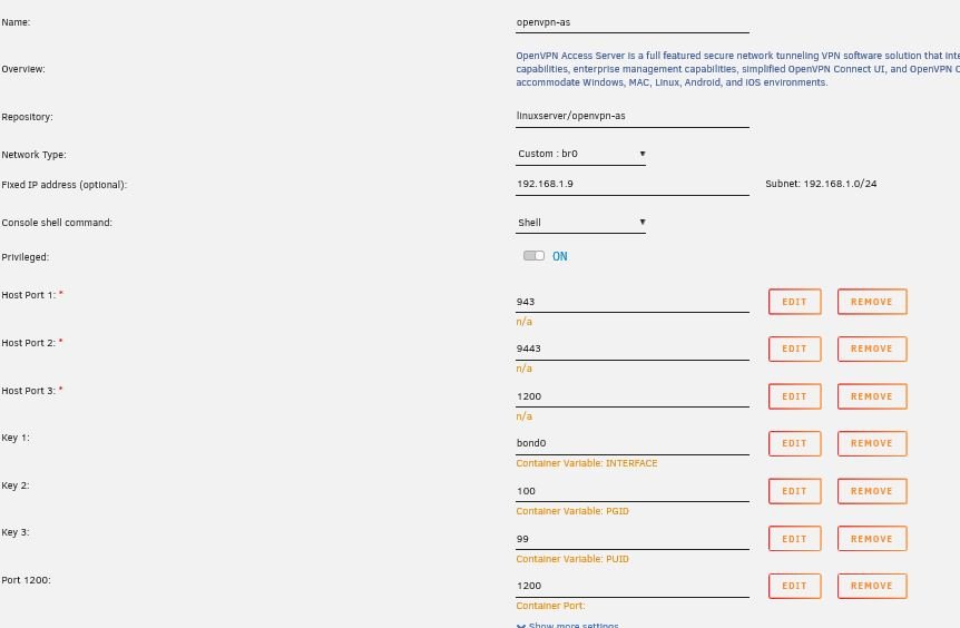

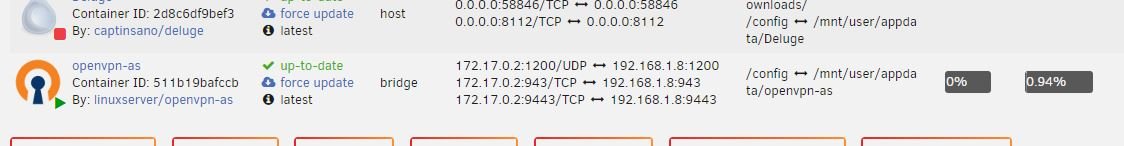

I really didn't have the patience to read all of your posts, but let me tell you it is quite possible to access vpn through different ports. But you really need to understand how these things for together. That's why everyone's been telling you to read the docker faq.
If you want to access it at port 1200, you can either
1) run it in bridge, don't change any ports in the openvpn-as gui, in container settings, map host port 1200 to container port 1194 with udp selected. Map any host port you like to container port 943 with tcp for the webgui. Leave the interface as eth0, or
2) run it in host networking, in the openvpn-as gui change the udp port to 1200. Set your interface to your ubraid network interface.
With either of the above, set the vpn client to use port 1200 udp and that's it.
Fyi, I'm accessing my vpn server on a different port than 1194 via the first option listed above
If the above doesn't make any sense to you, then read up on docker port mapping and docker host vs bridge networking. Google is your friend.

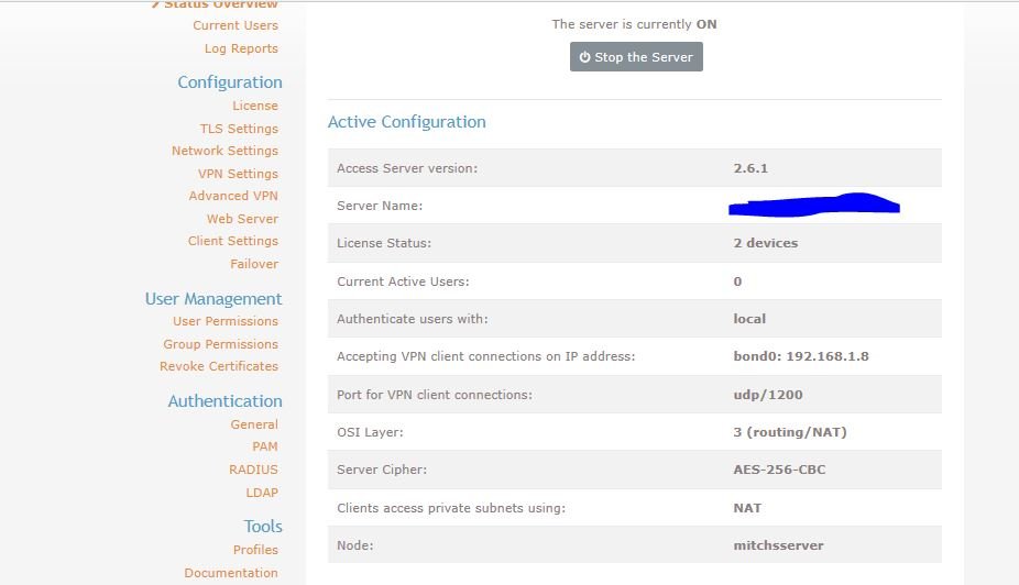

ok fine ill tell it again
Remote Side
I watched  Space Invaders Install OpenVPN-AS  i followed it..  when he came to Port 1194 i changed mine cuz i do not want 1194 as the main port i want 1200
so what i did when you first install OpenVPN-AS   you got to Host Port 3  that says 1194  and i changed it to 1200
and set to BOND0
then clicked save so it would install the program
i then logged into the Gui  and set it up  exactly as spaceinvaders video like i mentioned
instead of his part i set it to 1200 UDP   deleted the admin user created a new admin account.. edited the as.conf   and edited out admin  and
i set my dns address name i have in my pfsense box
ran force update.. exactly like Space Invader did
On my router i Port Forward 1200 UDP  to the unraid box address
i then logged out  and downloaded the Locked Yourself client file

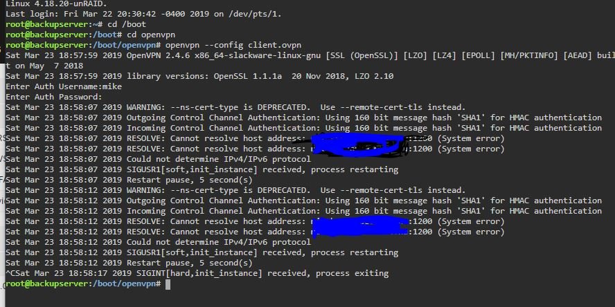

then on my side  i installed Peters OpenVPN Client  and ran
openvpn  --config client.ovp
it then gives the error i showed first cant resolve hostname which is should..
when i was trouble shooting i seen that the Docker OpenVPN-AS  was still at 1194 not the 1200 i had set it up following the video
and thats how i got to you guys in this form.. posting the unable to resolve hostname 1200 error and the 1194 1200 issue i been having
i hope this helps?  dislexia sucks but it all makes sense to me in my head
Then your problem is not the port, but that the address you used is not correct.
Have you looked at the openvpn config file to see which address is there?

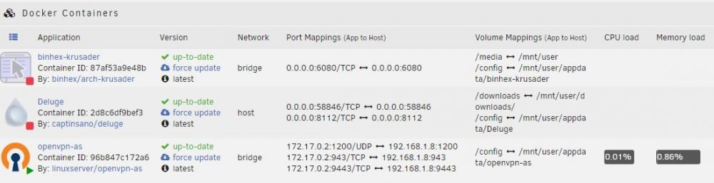

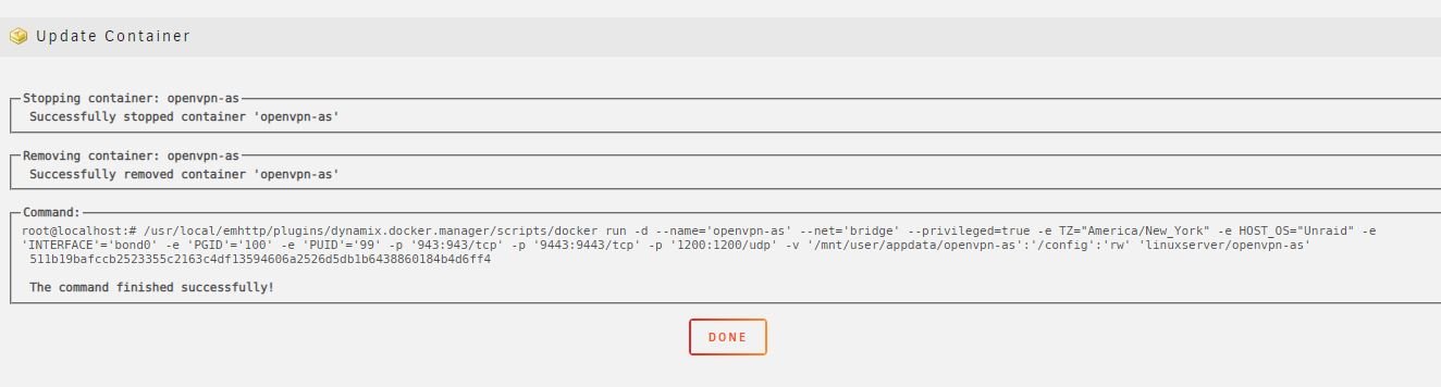

Post the docker run command that results from attempting this in bridge mode.
dont know what a docker run command is  if you mean
the screen shot  of
when i type  openvpn --config client.ovpn
while its in bridge mode i can
the screen shot  of
The docker run command is what results from making any change in the docker config on the edit screen and then clicking apply.  The docker is stopped and restarted with the changes and displays the run command as it is restarting.
It looks something like this (this is the docker run command from a change I made in the UniFi container):
root@localhost:# /usr/local/emhttp/plugins/dynamix.docker.manager/scripts/docker run -d --name='unifi-controller' --net='host' --log-opt max-size='100m' --log-opt max-file='2' -e TZ="America/Denver" -e HOST_OS="Unraid" -e 'UDP_PORT_3478'='3478' -e 'TCP_PORT_8080'='8080' -e 'TCP_PORT_8443'='8443' -e 'TCP_PORT_8880'='8880' -e 'TCP_PORT_8843'='8843' -e 'UDP_PORT_10001'='10001' -e 'UDP_PORT_1900'='1900' -e 'PUID'='99' -e 'PGID'='100' -v '/mnt/user/appdata/unifi/':'/config':'rw,slave' 'linuxserver/unifi-controller:5.9'
You are being asked to post the docker run command from OpenVPN-AS configured in bridge mode.  Make any change (even it it just changing one parameter and then setting it back to what it originally was) and apply the change.
Edited by Hoopster
ah ok the the docker command  ya i posted the HOST docker command then
so first 3 screen shots are in Host mode
4th pic is your docker command bridge mode
Don't change the container port. You have set the host port as you want it to be, and that is OK, but you have changed the container port to match. You have to leave the container port alone and let it use the port the container expects it to be. That is what mapping is all about. The container port corresponds to (mapped to) a different port on the host. Just like with volume mapping. /config in the container corresponds to (mapped to) a different path on the host, /mnt/user/appdata/openvpn-as.
Understanding mapping is most of what you need to understand about setting up any docker all by yourself and without relying on anybody else to tell you exactly what you need to do.
It looks like in the OpenVPN-AS network settings page he has also changed the port on which the container is listening for VPN client connections to UDP 1200.
ok so basiclly you mean its like  windows mapping
network Share  Files aka Port 1194    share it as Drive G:  aka 1200
and you do this in Bridge and in the GUI
like this?
i edit the the 1200 back to 1194  in the container you call it
Edited by comet424
