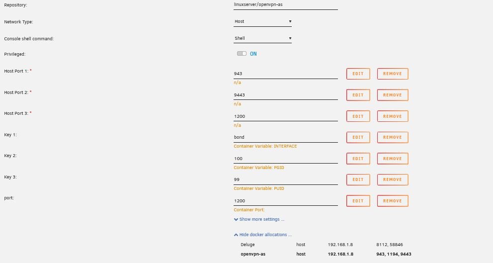

7 minutes ago, comet424 said:
what goes the other way around   the 1194 1200
if so then i have to change container back to 1200  and the GUI  to 1194? is that what you mean
you currently have the container set to 1200, host set to 1194
172.17.0.2 is the container IP, 192.168.1.8 is your host IP
PSA. It seems openvpn pushed another broken bin, tagged 2.7.3
I get the same error with it as I did with the previously pulled 2.7.2
While they/us try to figure it out, you can change your image to "linuxserver/openvpn-as:2.6.1-ls11" and it should work
ok  so the Container  is the GUI    and the HOST is the config settings when i Hit EDIT  right
so then i change host back to 1200
and also change the GUI  login as ADmin  and set it back to 1194 right?
i had to re read 2 messages ago 5 times to try to think it in my head

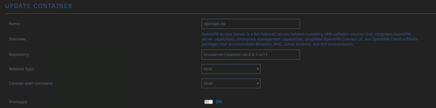

Removed that image, added the container again via the unRAID GUI, changed the repository to "linuxserver/openvpn-as:2.6.1-ls11", worked like a charm! Back up and running ^_^v

That's right, open the container settings and modify the repository entry (which is the docker image)

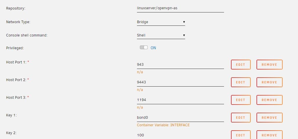

On 3/22/2019 at 10:08 PM, comet424 said:
im getting frustrated .. i cant delete 1194 i added a port to AS  and still wont add port i googled docker ports and that article was usless it doesnt say anyhing how to erase 1194 and replace it with 1200
https://lime-technology.com/wp/docker-guide/
so im really getting frustrated   i want 1194 erased and 1200 put in its place.. in host mode  because Bridge mode doesnt work at all gui is disabled
12
you have bond instead of bond0
ya i ment to tell you i had fixed that  set it to bond0  after i sent pic  sorry about that
ok i re read things again i  confused
the 172.x.x.  container  and you said the host is my 192.168.1.8
is it supposed to go  192.168.1.8:1200 <-> 172.x.x.x:1194
or                             192.168.1.8:1194 <->172.x.x.x:1200
or what is it supposed to look like  i still dont have internet to my sisters server so i cant edit  but what should it look like  so  i can edit it
and do i leave the gui to 1200 udp or did i need to change it back to 1194..
i told her to contact her ISP to get a tech out but she being stubborn..  but if you could even edit my photo(s)  and show what it should look like.. as im a visual learner  nto so much a words learner.. with dislexia and learning disablity i learn better with pictures  instead of trying to explain it
if that is ok with you guys 🙂
Edited by comet424

Yeah remove your existing image.  then go click add container on the docker page.
click on the template and go down to your user templates...
Then click on the openvpn one.
Then go to the repository line and change it to linuxserver/openvpn-as:2.6.1-ls11 .
That is literally all I had to do.
No need to remove and re-add the docker image. Jst edit your docker, change the repository and then hit apply. Job Done.
