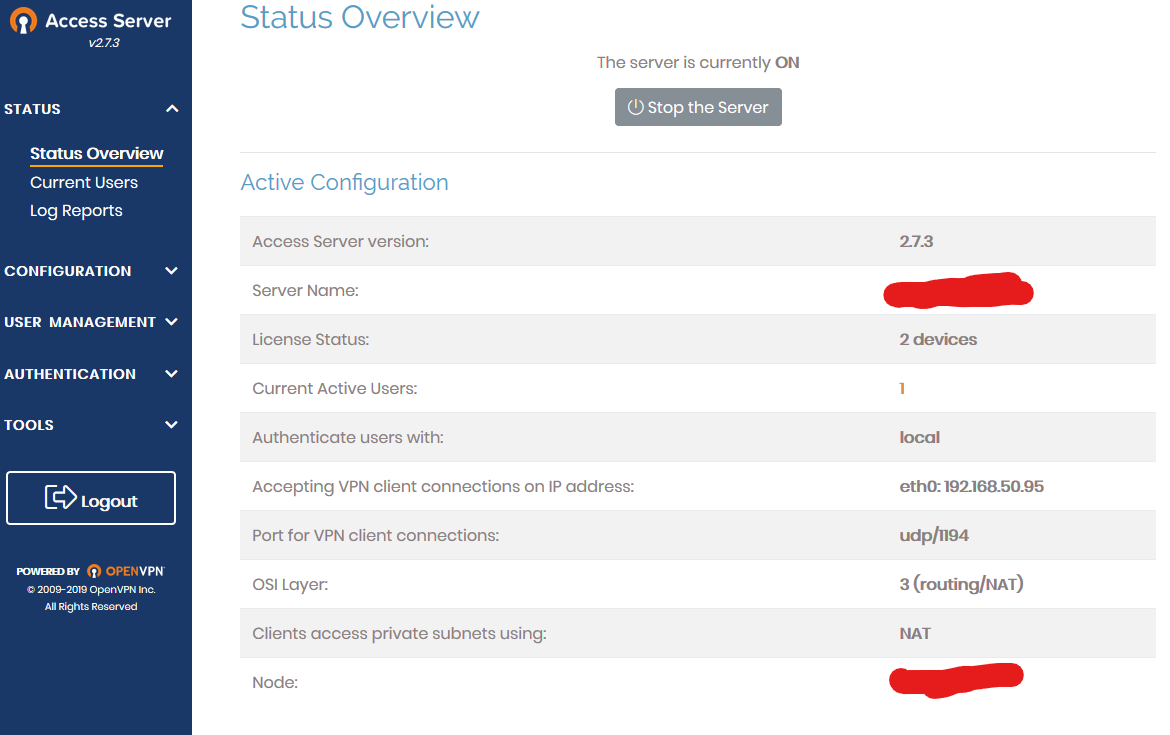

Works for me.  Now running version 2.7.3 from the lsiodev/openvpn-as repository.   I tested connecting from two clients.  Both connected with no problem.

Works for me as well.  Now running version 2.7.3 from the lsiodev/openvpn-as repository.  Will this change back to linuxserver/openvpn-as at some point?

It looks like making the switch from lsiodev back to linuxserver repository makes openvpn-as act like a new install.  I have lost my custom admin users so none of my profiles connect and it is back to the default admin/password login.  The rest of the customizations (server name, networks, etc.) are also gone.  I'll have to go through the initial setup again. Is this expected?
UPDATE:  I have reconfigured openvpn-as (had to download the client profile again to iOS devices) and all clients are connecting again.

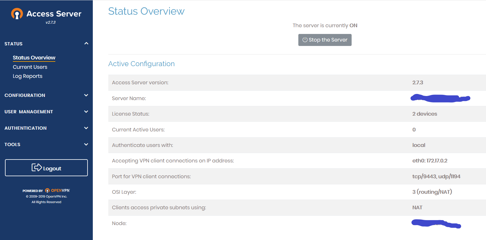

Hi, I upgrade to latest version, but can't open WEB UI, please help.
2 minutes ago, Kristijan said:
Hi, tnx, i read all on this link, but i don't know what i must do to connect to openvpn WEB UI. I always have "Web page cant be displayed". Sorry i am new in unraid. Last version open vpn working normally.
He's trying to tell you what you have to post so we can help you.  Post the info as described in that link.
I don't know which info is needed. I install openvpn over spaceinvader tutorial, but now when i update to new version can't connect to WEB UI.
Which info is needed? Tnx
