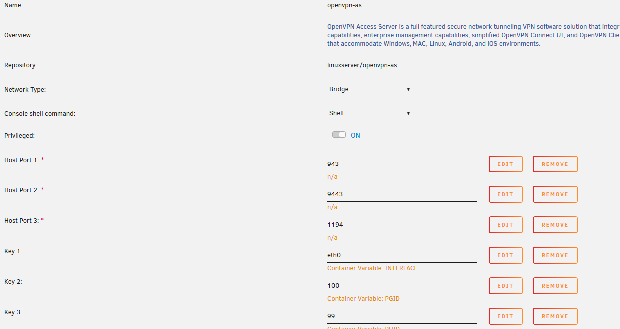

2 hours ago, aptalca said:
Run it in bridge mode as shown on GitHub or docker hub page
it already is deploying with the option (INTERFACE=eth0):
root@localhost:# /usr/local/emhttp/plugins/dynamix.docker.manager/scripts/docker run -d --name='openvpn-as' --net='host' --privileged=true -e TZ="America/Los_Angeles" -e HOST_OS="Unraid" -e 'TCP_PORT_943'='943' -e 'TCP_PORT_9443'='9443' -e 'UDP_PORT_1194'='1194' -e 'INTERFACE'='eth0' -e 'PGID'='100' -e 'PUID'='99' -v '/mnt/user/appdata/openvpn-as':'/config':'rw' 'linuxserver/openvpn-as'
e005927c1b69a868509c178eb48cd476ec0f98fa67ef0442a9d8daf62d03058b

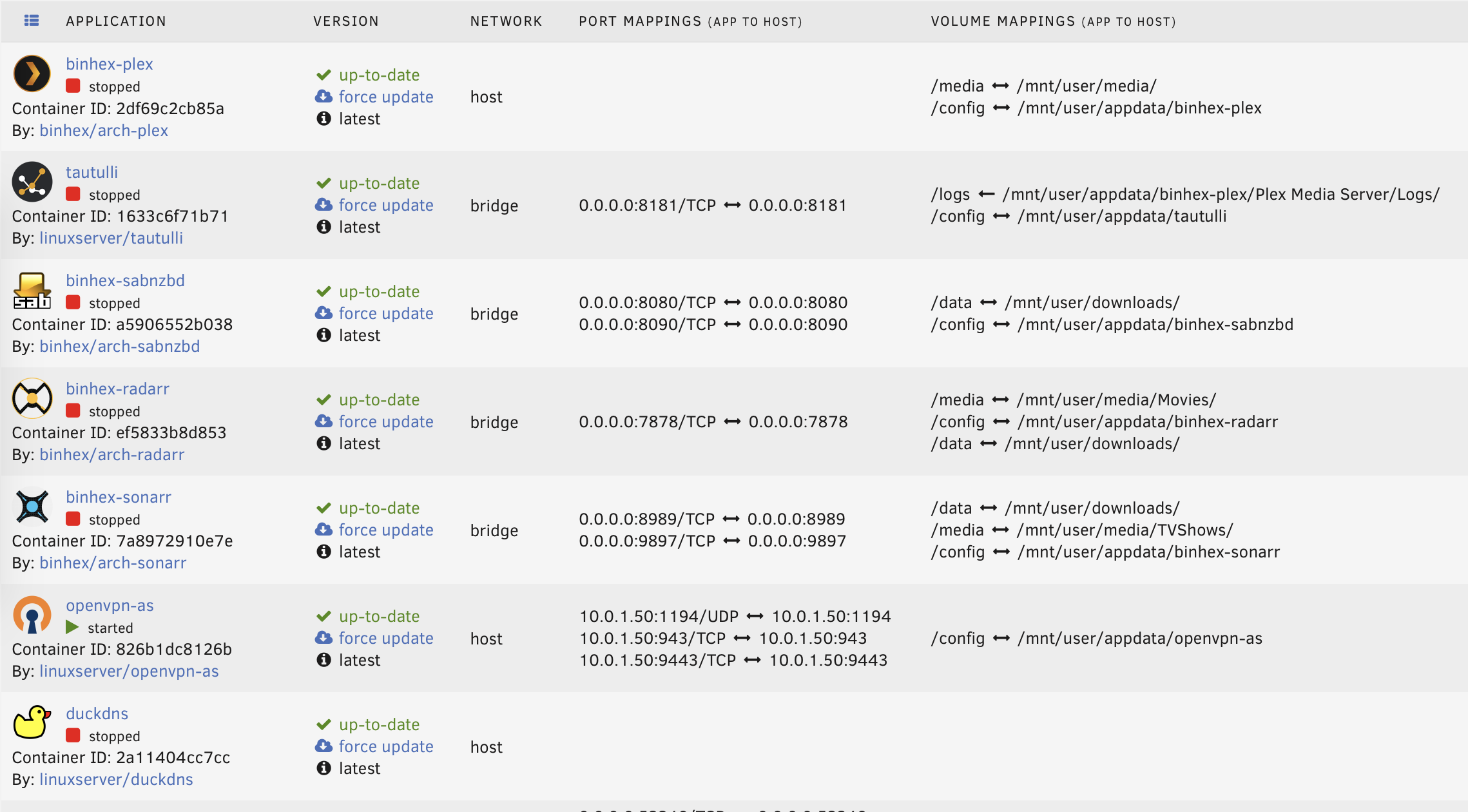

I have somewhat narrowed down the problem. If I start openVPN prior to all my other docker services the OpenVPN server starts up without issue. I am not sure which one is causing the conflict however...

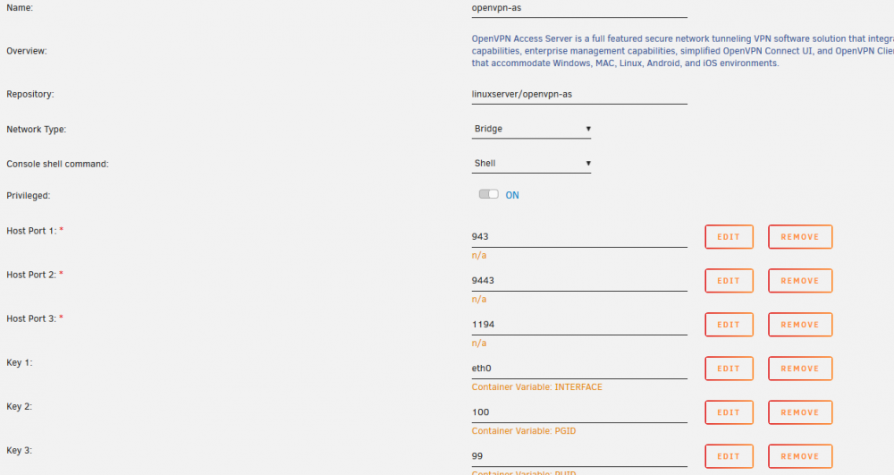

2 minutes ago, Jhp612 said:
it already is deploying with the option:
2 hours ago, Squid said:
Hey Squid did I miss a response? From the doc's it shows that it is in bridge mode by default since January and you can also see the interface is set to eth0 unless I am missing something
Look at your screenshot.  It's not in bridge mode.
Personally, I don't use this container, and just jumped in when I saw your docker run command and screenshot both stated Host when @aptalca asked you to switch it to bridge.

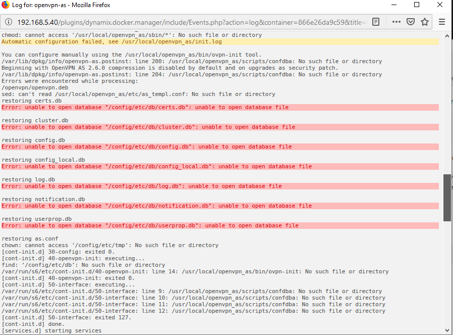

Hi All, Having an issue with the recent linuxserver/openvpn-as repo build of Openvpn-as that I hope someone can shed some light. Running 6.7.0-rc-7 right now, haven't updated openVPN in ages (can't recall prior build but already did the network type = bridge and removal of "interface=eth0" modifications which all worked until I tried to change the network settings the clients could access) but decided to nuke the full install and start from scratch.
As it stands now I'm able to install the docker, get into the GUI and add a new user although every time I attempt to stop/start the docker it appears the install reverts back to defaults. I mean my users details, as.conf settings and not sure what else all revert back to the defaults as if the file has been completely wiped.
I've tried using the same app folder location and new app folder location but nothing appears to be retained. File permissions look correct (nobody/users) and the cache drive works for the other dockers just not this one.
Any assistance is greatly appreciated.
App run is as follows:
root@localhost:# /usr/local/emhttp/plugins/dynamix.docker.manager/scripts/docker create --name='OpenVPN' --net='bridge' --log-opt max-size='10m' --log-opt max-file='3' --privileged=true -e TZ="America/New_York" -e HOST_OS="Unraid" -e 'PGID'='100' -e 'PUID'='99' -p '943:943/tcp' -p '9443:9443/tcp' -p '1194:1194/udp' -v '/mnt/user/Dockers/openvpn':'/config':'rw' 'linuxserver/openvpn-as'
566e0951ece71323f6fa1a567f02a72ba1301036be09ca43ccd155914931f7b6
logs when the docker starts (up to EULA) are as follows:

It seems there is a bug for new installs. Looking into it.
EDIT: Yup, missed something for new installs. PR submitted, should be merged soon. After update, it will reset one more time but then it should be good.
Edited by aptalca

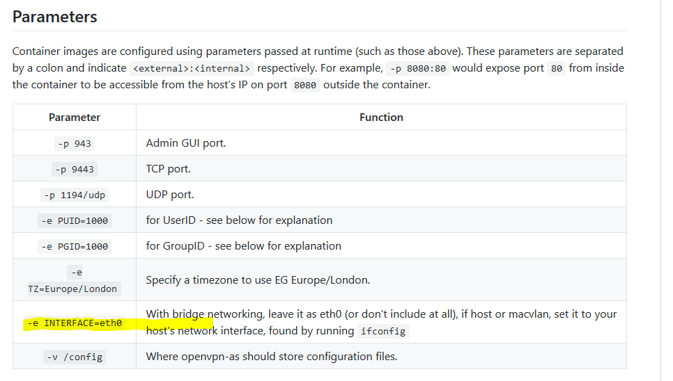

I think you can remove -e 'INTERFACE'='bond0' and run it as bridge now as per the readme.
In readme I see this parameter.
@Kristijan Did you also read the bit that says With bridge networking, leave it as eth0 (or don't include at all)
Edited by CHBMB
Yes, I try but no sucess. Again not connect to WEB UI. Change to bridge and eth0.

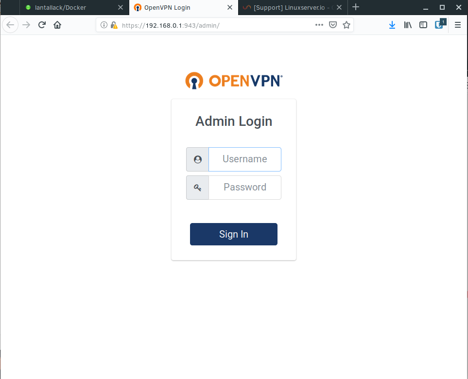

Here's my logs
and the webui

Ok, but I can't edit as.conf No permissions when docker is started.
With version 2.6.1 i don't have this issue.

I must edit as.config and comment creating defaut admin user after docker update.

Hi Guys,
So i had OpenVPN running smoothly until last nights update. (Have auto updating turned on).  When i tried to connect this morning it wouldn't connect.  Checked my openvpn-as appdata share and most of the contents were missing.  Not a big deal.  Just created from scratch and had the config back working about 10 mins later.
My problem is that now i can't connect on UDP (port 1194).  Port is still forwarded to the container it just won't connect.  I tried changing it to TCP (Port 9443, Opened it on my router) and it worked first time.  I just can't for the life of me figure out why this bugger won't connect on UDP any more.
Anyone else had a similar experience?
Below are my port mappings,  Using Bridged as my networking option.
172.17.0.10:1194/UDP-192.168.0.18:1194
172.17.0.10:943/TCP-192.168.0.18:943
172.17.0.10:9443/TCP-192.168.0.18:9443
