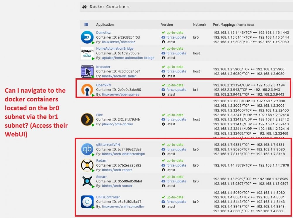

Hi again,
Firstly, I'm not an expert in networking... but I know enough to be dangerous :)
Can I in anyway have OpenVPN as a docker or VM talk to other docker services located on a different interface?
This is what I've tried so far.... I've installed a second NIC and added it as a separate interface in the settings... I've also setup a new network on my UniFi USG with it's own gateway using it's second Lan\Wan port.
Modem > Unifi USG > Interface 1 (Unraid server)
                  > Interface 2 (Unraid server)
192.168.0.1 > 192.168.1.1\24 > 192.168.1.2 (Unraid Server)
                             > 192.168.1.14 (some docker service)
                             > 192.168.1.16 (some other docker service)
            > 192.168.2.1\24 > 192.168.2.2 (Unraid OpenVPN docker)
I can connect in ok and view other devices on my local network but not anything else on the unraid server (other dockers).

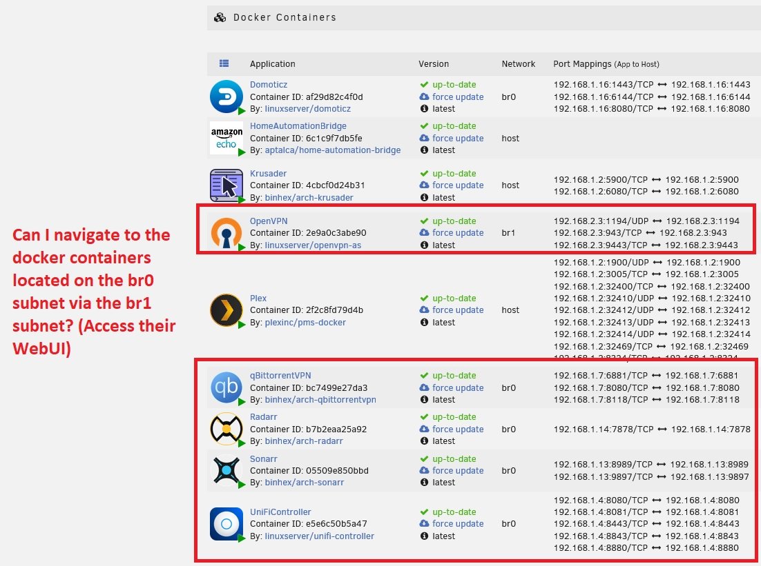

6 hours ago, jaminben said:
Hi again,
From a networking perspective, yes, you can access other subnets. I have devices on vlans on different subnets and I define those subnets in openvpn-as gui settings as accessible and I can access them.
One thing you need to keep in mind is the "security" feature of macvlan. If you used that for any containers, they won't be accessible by the host or anything that uses the host's network interface
