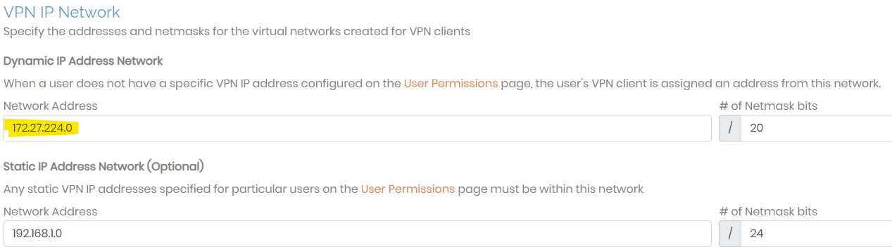

I've been keeping an eye on this thread since the updates but I can't seem to find an answer for my issue. For some reason openvpn keeps pulling the docker ip address range through on eth0 (172.x.x.x) when I'm using a 192.168.1.x range. When I connect via the openvpn app on my mobile I'm dished out a 172.x.x.x address. I can use a static 192.168.1.x address via vpn settings on the openvpn web GUI, which is then used in the openvpn app on my mobile, but I can't access the unraid GUI or sabnzbz/sonarr/radarr.
All worked perfectly before the later releases but I'm stumped! Any help would be much appreciated.
Thanks!
Update
If i amend the Dynamic IP Address Network from 172.x.x.x to 192.168.1.0/24 I can't connect back to the openvpn webgui but i do get a 192.168.1.x address in the mobile app. However I still cant connect to the unraid GUI or any services (all on the same 192.168.1.x subnet).658788031_Annotation2019-05-14163422.thumb.png.ef4df941c0979205d72e9b0ac11c5ff4.png
Edited by sizo
update
@sizo try what @Stupifier mentioned above.
"Update:
Figured out how to access UnRAID GUI. Did NOT figure out how to be assigned a local address on my primary WiFi subnet though.
In Admin Page ----> VPN Settings go to Routing section and add a line for the subnet you want your clients to have access to (for example, I added 192.168.1.0/24 which is my primary WiFi subnet and where I can access my UnRAID GUI locally)"
"Update:
I can confirm this worked.
Good Job.
"Update:
tried this again but for some unknown reason this time it works!!
Thanks for all the help!

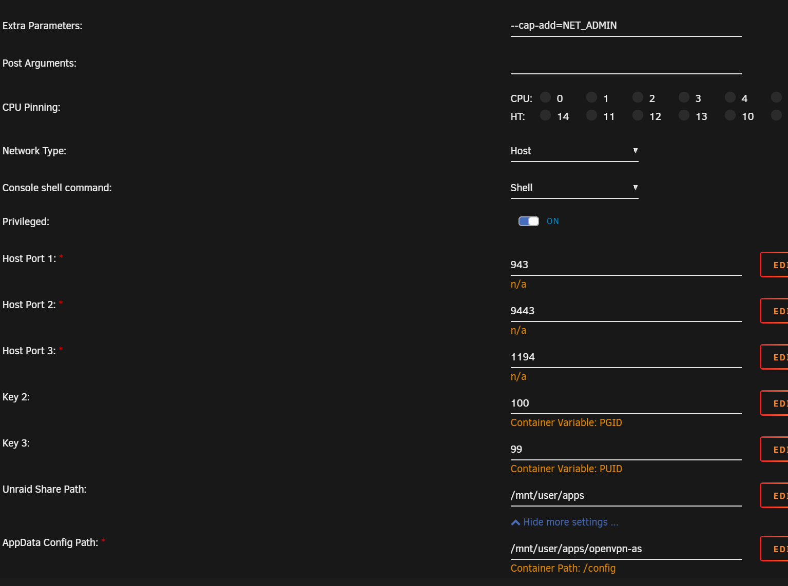

2 hours ago, Jaster said:
Did it, but nothing changed. Keep getting the same error while trying to start the server inside the container.
Hey,
Try to remove the docker container and remove the openvpnas folder under appdata. Then use the stettings from @dkerlee to set it up again.
Post a screenshot of your container settings
3 hours ago, Jaster said:
image.thumb.png.655749f4b058a70b28be3f97e28be0da.pngimageproxy.php?img=&key=00b562fcac28e727
That's host networking, not bridge.
See the first item on the list above
Edit: Bridge works (not br0..?). Thanks... sometimes I'm just blind ;)
