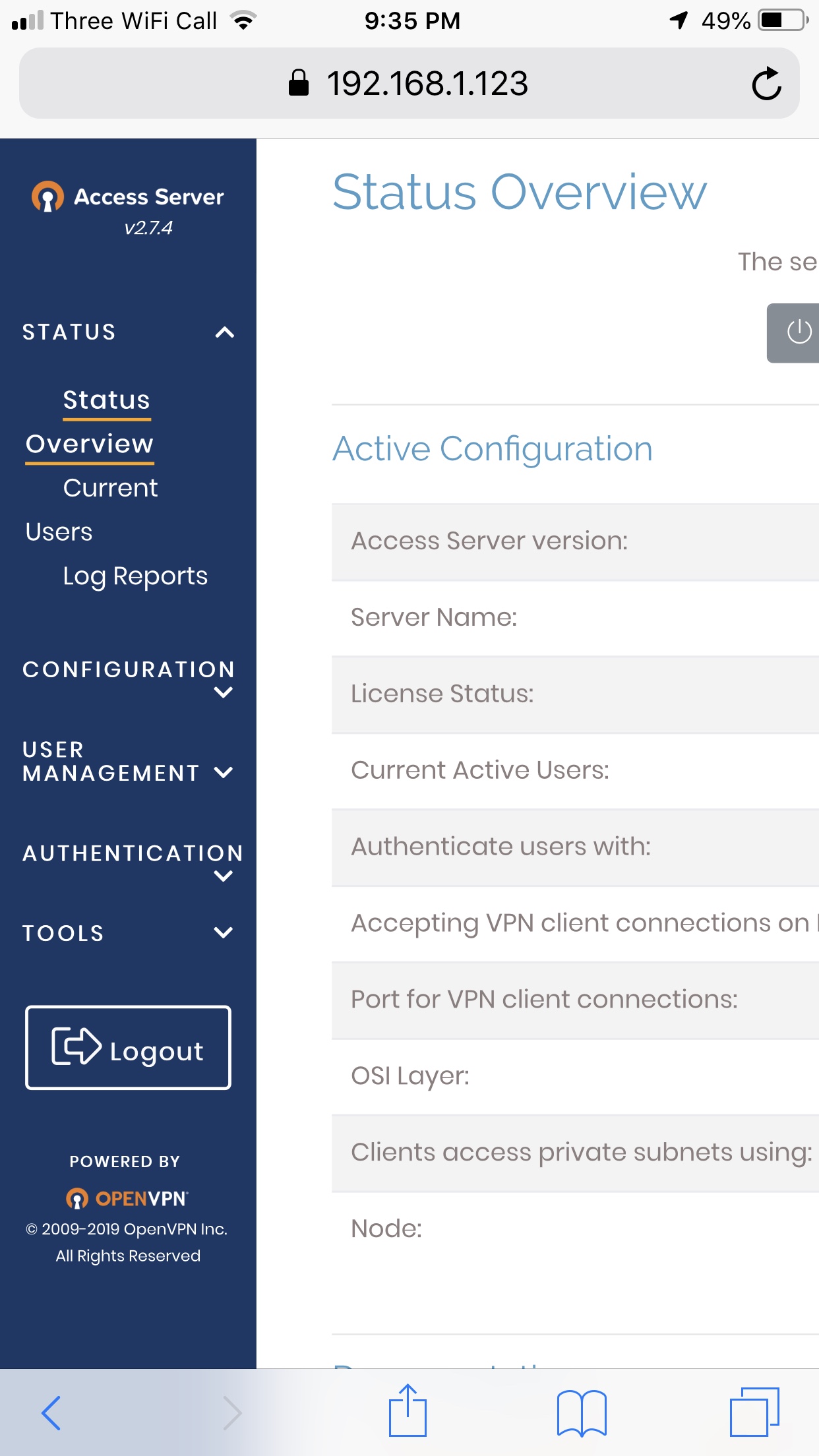

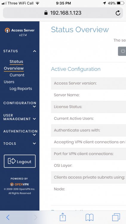

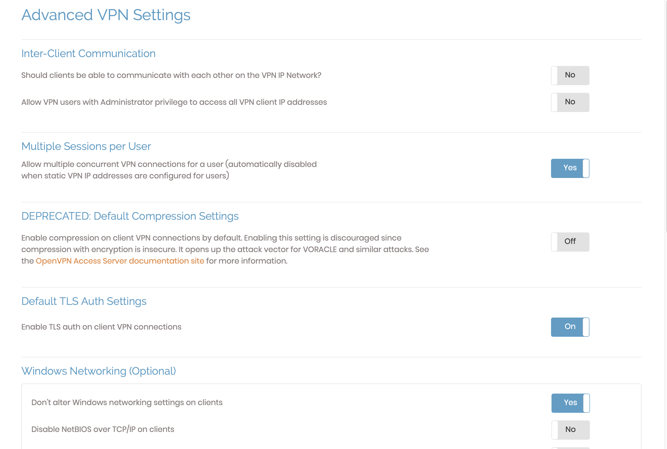

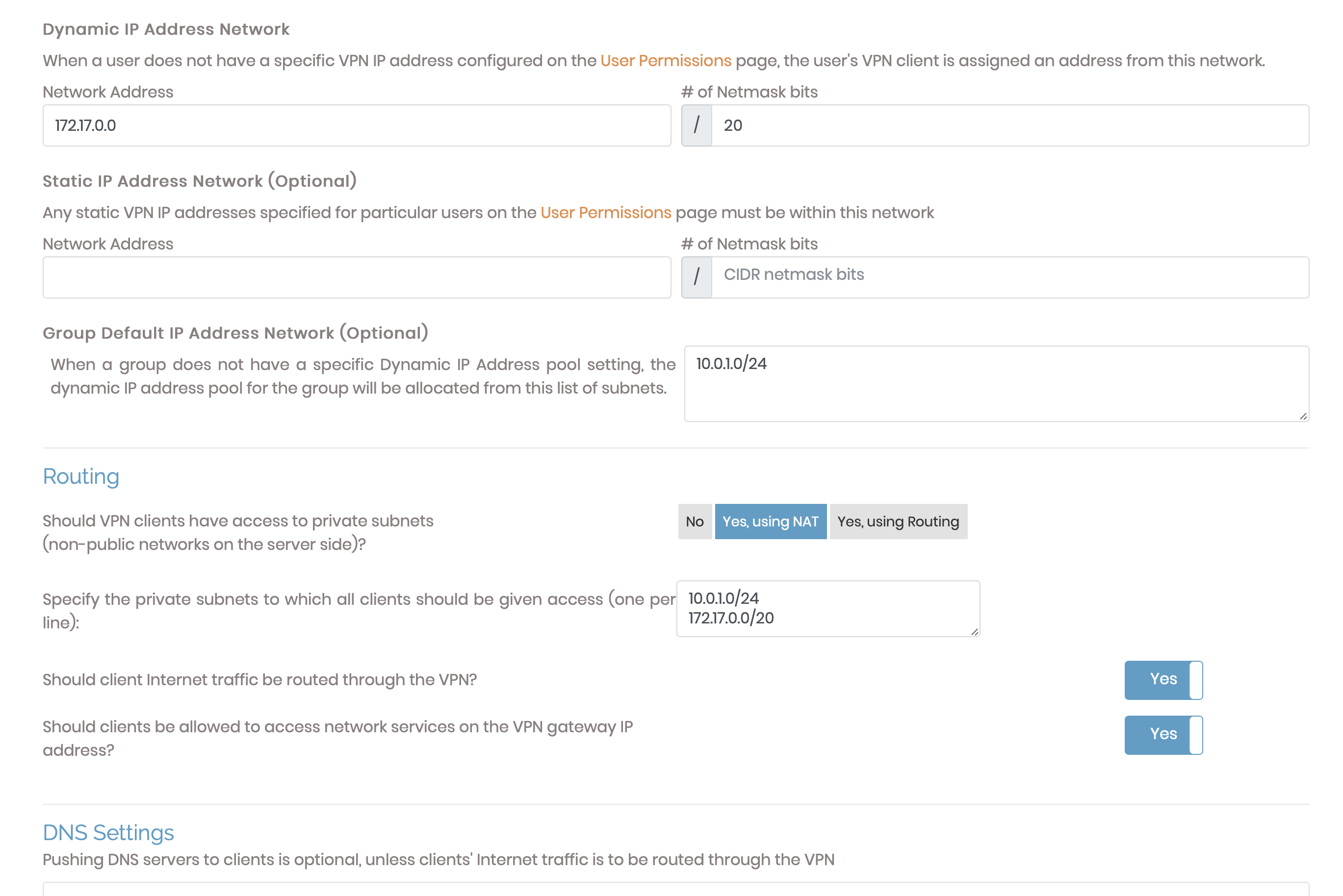

Im having issues with the docker image since upgrading to UnRaid 6.7.  I am running OpenVPN As version 2.7.4.  I believe my setting are correct, and once connected I can access my UnRaid Servers and Dockers.  However, after I disconnect, I have to restart the OpenVPN Docker to reconnect.  It perpetually gets stuck in Tunnelblick until I restart the container and then it works for a single connection again.  Below are my settings.  Any help would be appreciated.
Return all those values to the defaults. Only add your lan subnet to the routing section
It worked perfectly.  I should have thought of just doing a clean install and trying that route.  Thanks for the help.

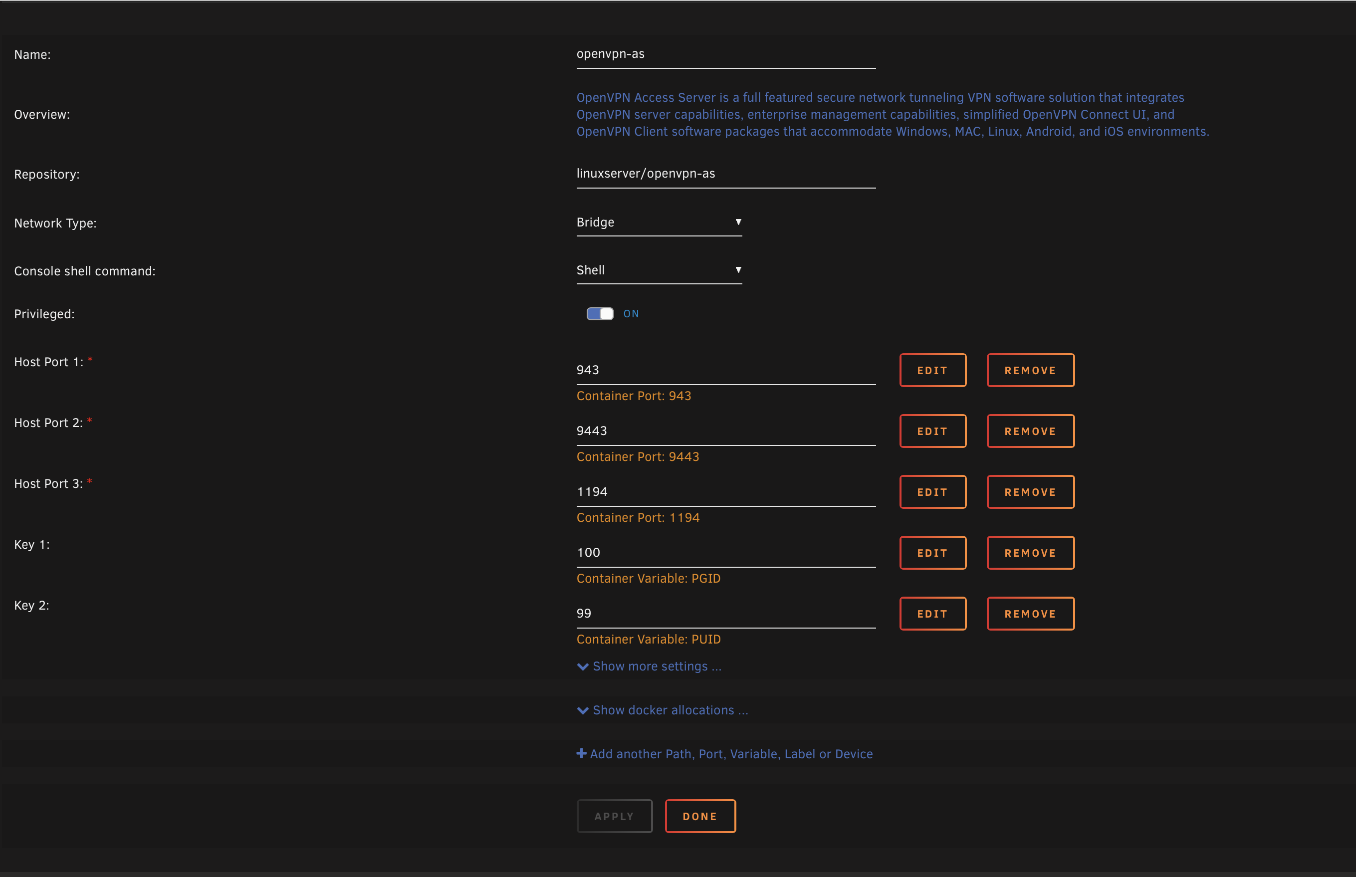

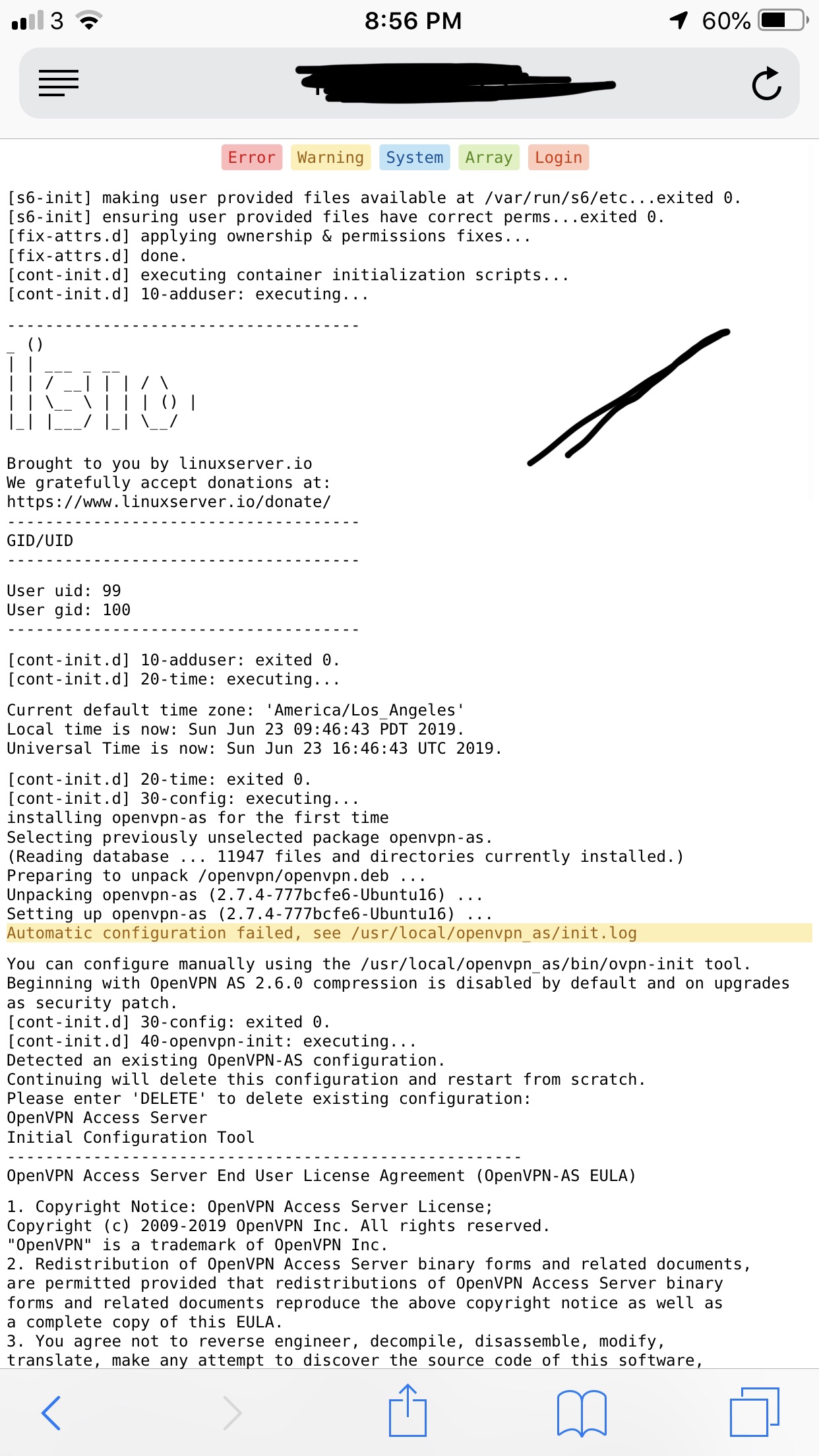

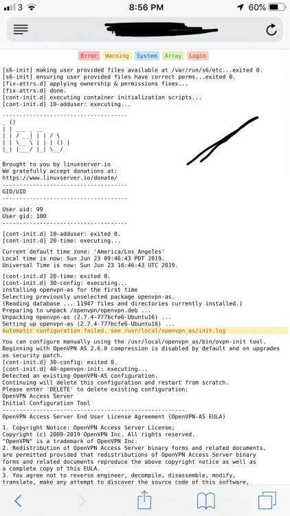

I got some problems with the openvpn docker on my unraid 6.7.0 Server. On the photos you can see my configuration and the log. My webbrowser says: ERR_CONNECTION_REFUSED
What can I do?
Edited by Der_Eine
No one knows a solution? I tried anything and now I am really at the end...
With all the No such file or directory errors, you should post your docker run command
What can I do?
I had had a similar issue. For me it occurred when I updated the OpenVPN-as container. I had to do a clean install (removed docker container and erased the OpenVPN-as folder from my appdata share), reinstalled and that fixed the problem.

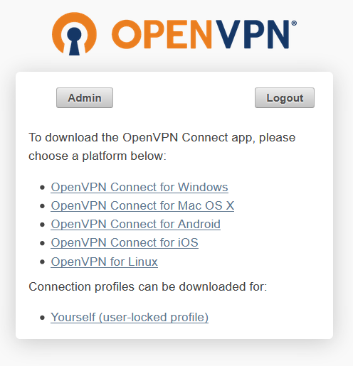

I get this I cannot find the OpenVPN file to download for my client set up?
Been quite awhile since I've used this app (have switched to a different method of connecting remotely), but after you set up the user etc via the admin login, don't you just login locally as the appropriate user and then download the .ovpn file there and then move it to the applicable device?
I cannot find the ovpn file to download
Doesn't it just download via the browser?
Where from?
Did you login as the admin or as the user you want the opvn for?
ok.  The UI has very significantly changed in the last 4 months since I last used this.
Was trying to Goto the admin page again,
It’s working now but how do I connect with my unRAID GUI
Login from the OpenVPN WebUI
I logged in as the user for whom I want the .ovpn profile configured and clicked on the link at the bottom.  I then imported the downloaded .ovpn file into the client on my laptops and mobile devices which need access through Open VPN.

You need to add the subnet of your unraid server to the settings in openvpn routing info. If you get stuck, there are several posts and images in the last few pages as this started happening in the last update :)
To get to the user (non-admin) interface you need to use this address:
https://unraidipaddress:943/?src=connect
I would then bookmark this.
Or just open the gui from docker page, then change out /admin for /client in the adr bar :)

Just the naked domain will suffice, without /admin at the end
