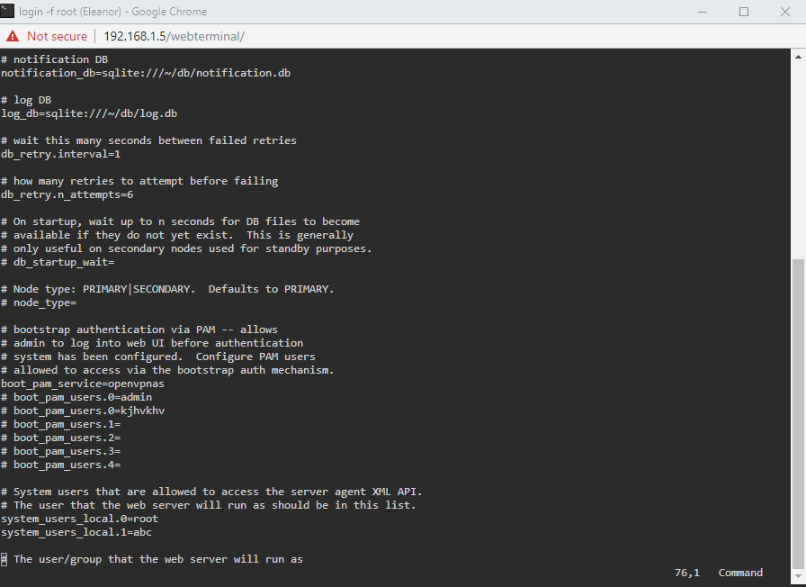

1 hour ago, Tucubanito07 said:
Good evening Guys,
I started reading from page 60 to 63 and i don't see anyone having this issue. I went online and searched on google and i came across this website https://discourse.linuxserver.io/t/openvpn-as-unable-to-login-since-latest-container-update/583.
The error I am getting is below:
session error: argument of type 'nonetype' is not iterable: flat/twist:24,flat/ten:83,flat/flatstan:103,flat/ten:70,flat/ten:61,flat/flatstan:264,flat/ten:70,flat/ten:61,flat/flatstan:247,flat/flatstan:236,admin/astatus:165,admin/astatus:147 (exceptions.typeerror)
I already tried the fix that was there and it did not work. All i am trying to do is keep admin from populating again after i delete it. I tried changing the # boot_pam_users.0=admin to # boot_pam_users.0=kjhvkhv and it still does not work. However, then I added # boot_pam_users.0=admin and # boot_pam_users.0=kjhvkhv and still dont work. The only thing that works is just leaving boot_pam_users.0=admin like normal and then i am able to get into my other accounts. Any help will be appreciated.
Thank you very much.
You need to uncomment it (remove the # sign)
