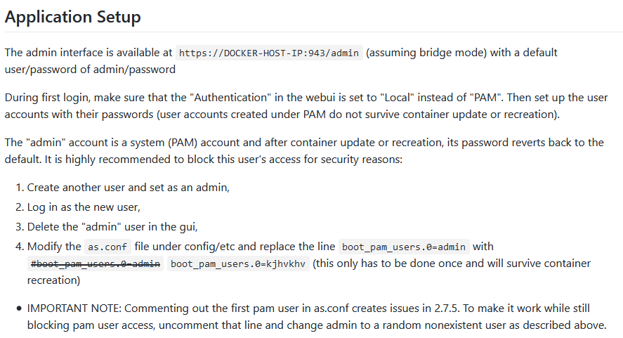

I'm sure I'm doing something wrong - OpenVPNAS runs fine on my machine that is until I update it... once I update it, it loses all settings and I have to start again and reconfigure it and reissue new keys to users etc... I like to keep things updated but my only choice at the moment is to not update OpenVPNAS... Am I doing something wrong, is this correct behaviour for this docker?
Any help would be very much appreciated!!
Did you read and follow the Application Setup instructions in the links in the first post if this thread?  If your users were created with PAM authentication, their credentials do not survive container reboots/updates.
Hi yes I did. It's not just the users - the entire configuration is reset. Everything under Configuation, User Management, Authentication is all reset to 'default' - it's as if I've deleted the docker and reinstalled it....
I just updated this container as I have done many times and all configuration information was preserved (as it always has been).  The only thing I can think of is the location to which the OVPN configuraiton is saved in your appdata share is somehow read-only and the changes are never written permanently.  Grasping at straws, perhaps.
Check the logs after an update.
Post your docker run.
Make sure the config folder is on /mnt/cache
And make sure your cache pool is healthy.
