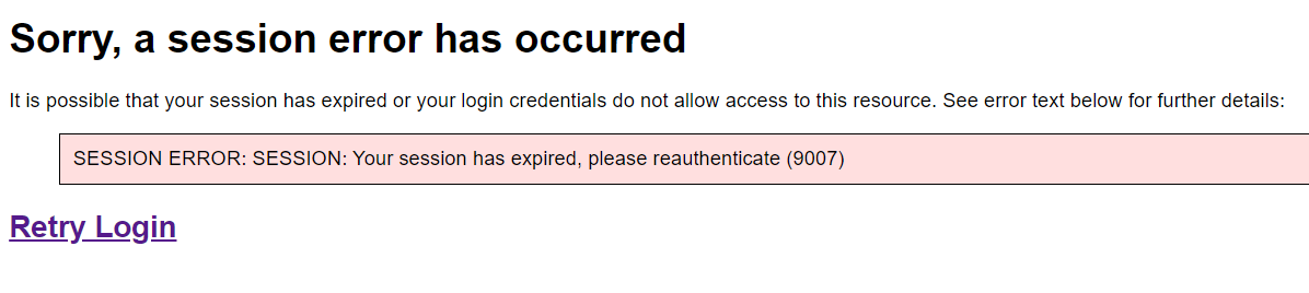

Hi all, I'm following Spaceinvaderone's tutorial on installing OpenVPN-as and I'm getting the below error. I have tried a fresh install of the docker after deleting the folder from 'appdata', rebooted, and ensured the docker is in privileged mode.

I'm having the same issue ("Sorry, a session error has occurred").
I noticed this in the image log:
Automatic configuration failed, see /usr/local/openvpn_as/init.log
You can configure manually using the /usr/local/openvpn_as/bin/ovpn-init tool.
/var/lib/dpkg/info/openvpn-as.postinst: line 72: systemctl: command not found
Stopping openvpn-as now; will start again later after configuring
I this is the last line of init.log:
Enabling service
Error: Could not execute 'systemctl enable openvpnas' to enable startup/shutdown scripts
I switched the shell to bash and tried running the command manually in the console, but it won't tab complete systemctl. It seems the command is just missing. Is this normal and I'm barking up the wrong tree? Or is an image possibly missing?
Enabling service
Edit:
My run command is :
root@localhost:# /usr/local/emhttp/plugins/dynamix.docker.manager/scripts/docker run -d --name='openvpn-as' --net='br0' --ip='192.168.1.31' --privileged=true -e TZ="America/Denver" -e HOST_OS="Unraid" -e 'TCP_PORT_943'='943' -e 'TCP_PORT_9443'='9443' -e 'UDP_PORT_1194'='1194' -e 'PGID'='100' -e 'PUID'='99' -v '/mnt/user/appdata/openvpn-as':'/config':'rw' --cap-add=NET_ADMIN 'linuxserver/openvpn-as'
Post a full log. Those are harmless errors
