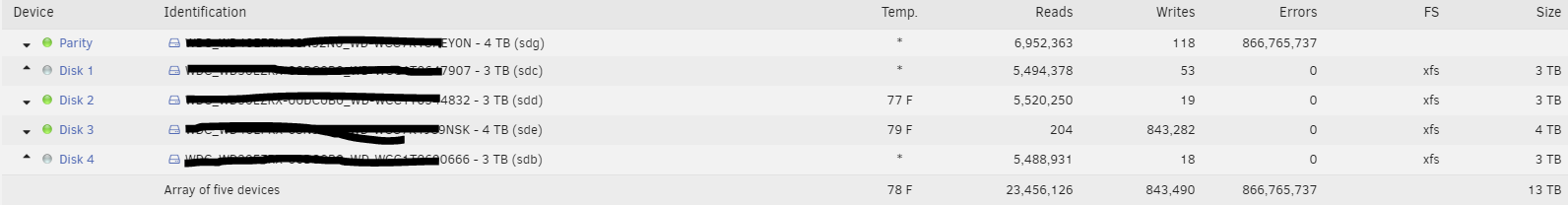

The parity drive is about 3 months old and had no signs of issues during pre-clear, I believe my issue is a bad cable on a 4 drive cage causing the Parity drive to have read errors. The concern I have is I am currently doing a rebuild of drive # 3 in my system, I can't imagine it will finish correctly with 32mil+ read errors on parity.
What is the best way to handle this?
The log file is 100% filled with read error lines.
Do I shutdown, reseat cables and restart the drive rebuild?

It does claim parity is valid, I'm doubtful.
I'm assuming it's because of the 866mil "read error" messages but when I try to gather diagnostics I get this:
Fatal error: Allowed memory size of 134217728 bytes exhausted (tried to allocate 134094880 bytes) in /usr/local/emhttp/plugins/dynamix/include/DefaultPageLayout.php(418) : eval()'d code on line 73
I don't know how it (Disk 3) could be complete with only 843.382 writes either there is 2.24TB of data on that drive.

The number of writes is meaningless, but with so many errors the rebuilt disk will be mostly garbage, see if you can get the diagnostics on the console by typing diagnostics
Problem appears to be the Marvell controller, besides parity it also dropped one of your cache devices and was very close to dropping the other one, Marvell controllers are not recommended for Unraid for some time now, this is one the reasons, they tend to drop disks.
You can try rebuilding again but risk the same problem.
