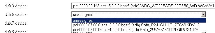

Five data drives are setup and working fine. When I try to add additional drives, the serial numbers do not display in the GUI. The word "Safe" appears in each new drive I try to add, plus numbers that are not the serial number.
The one drive in the screenshot, with the word safe, is identical to the parity drive plus drives 1 - 5. It is a Western Digital 2 TB Green drive. The other drive is a Seagate 1.5 TB.
I tried removing all new drives, and rebuilt the parity drive from the data drives 1 -5. After the parity was rebuilt, I get the same "Safe" in the new drives names, not the drive serial numbers I expect.
Is there a solution to this type of problem?

All I can think of is that is something your BIOS is doing... Are those two disks connected to a different disk controller than the other disks in your server?  (or, if on the motherboard, are they on a different disk controller chip?)
I've never seen that "Safe" preface before.
What specific make/model motherboard are you using?
Joe L.
Joe, you lead me the right direction! I am using a Gigabyte GA-EX58-UD5 system board. The system board has two on-board RAID controllers. One RAID controller is called Sata 2 ICH10R, which is a six drive controller. The drive connected to this controller are working normally. The other on-board controller is a four drive controller and is called Gsata2 Gigabyte JMB322.
The six drive controller RAID settings were configured in Windows, when I had the system setup with Windows. I don't know if the six drive controller can be configured at all with unRAID, although it works great.
The four drive controller is configured within the BIOS. There are a number of settings for the four drive controller.
Sata RAID/AHCI mode: AHCI is selected
Disabled
RAID
AHCI
Sata port 0 - 3 Native Mode: Disabled is selected
Enabled Sata port 0 - 3 work at native IDE mode
Disabled Sata port 0 - 3 work at legacy IDE mode
Disk RAID status, Smart Backup Config;
RAID 0  fast
RAID 1  safe
JBOD large
Normal (port multiplier)
I don't know how this last item was configured, since I think I changed it before seeing what it was set to before I changed it. I assume it must have been set for RAID 1 - safe.
I set the Smart Backup Config for Normal (port multiplier).
Then I tried booting into unRAID again, and I could see the serial numbers on the drives in the unRAID drive configuration screen.
Thanks for pointing me the right direction!
