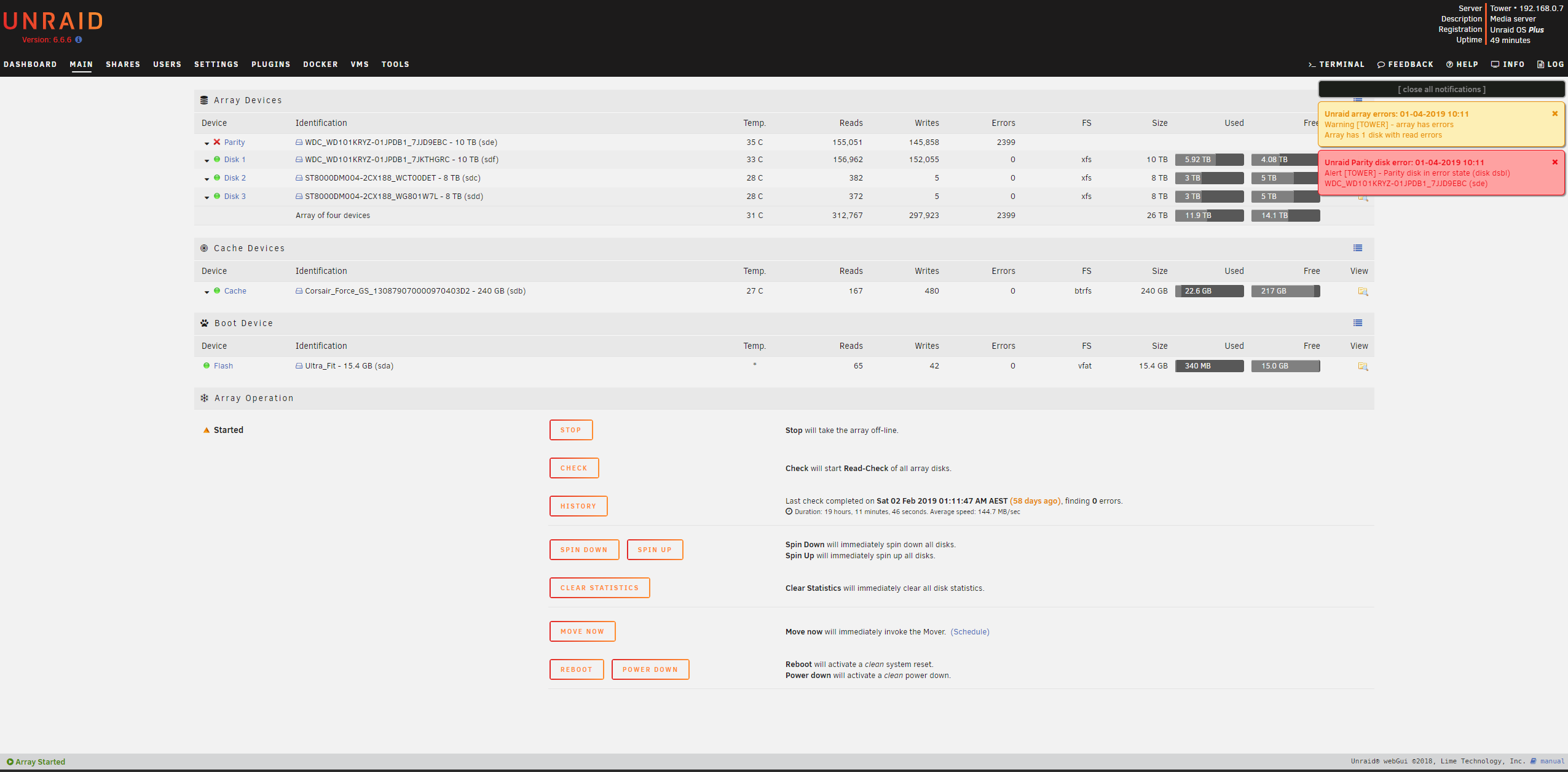

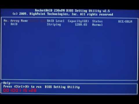

Hello, booted up my nas today and started the array, I had started and finished copying over some files and after I was done noticed the notifications that there were errors on my parity drive (see attached image). Have since stopped the array and downloaded the diagnostic file (tower-diagnostics-20190401-1040.zip). I feel the need to mention that when booting up the nas it did initially not go to the "RocketRAID bios setting utility" (attached image just from google to show what I was talking about) as it normally would and had to reboot a few times for it to come up. After getting it to come up it all started up normally.
I had been told by @johnnie.black in a previous post I made about drive errors that it could very likely be the raid card and should replace it with another controller he recommended.

Parity disk dropped offline, likely controller related, you can reboot and post new diags so there's a SMART report for parity, but best best bet would likely be to replace that controller with one of the recommended LSI HBAs.

I rebooted and got the diagnostics (tower-diagnostics-20190401-2027.zip), I did not start the array though as it is currently disabled, I am trying to remember the way of getting it to re-enable, it was to unassign the drive, start the array, stop the array(at what point do you stop it though?), re-assign the drive and then restart the array isn't it?
Parity looks fine, so very likely a controller issue, could also be power/cable related.

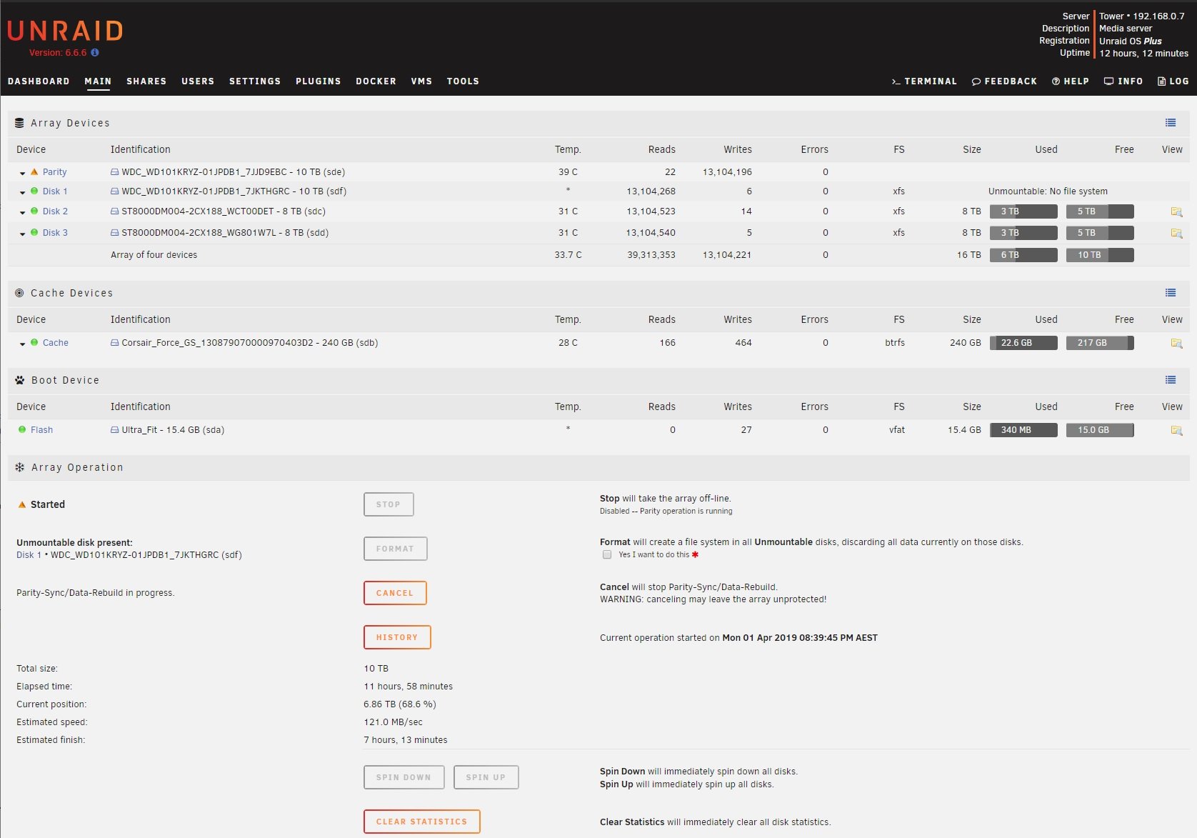

Ok have done that it currently parity sync/rebuilding about 6hrs left. I have also just noticed that one of my drives Disk 1 now says it is "Unmountable: No file system" tower-diagnostics-20190402-0834.zip Should I potentially be stopping the rebuild if it is reading (which it is) from that drive for the rebuild of the parity drive, rebooting and seeing if it comes back and then starting again on the rebuild?
Let the sync finish then run a filesystem check on disk1

tower-diagnostics-20190402-2016.zip So it is still in maint mode and for now still showing that the drive is "Unmountable: No file system" is there something that should be done next to test if its worked?
Start in normal mode, disks aren't mounted in safe mode.
Done, it is all back and present *deep sigh* thank you very much mate, you really are a life saver as I am not really knowledgeable in this stuff so I really appreciate your patience with me.
