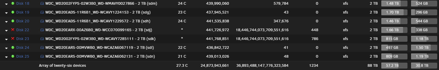

Tons of write errors suddenly on multiple drives
Been running these drives (and hardware) for well over a couple years now. Suddenly just started getting tons of write errors equally on 2 drives.
This probably isn't the hard drives then write? Should I be looking at either the controller or cables first?
