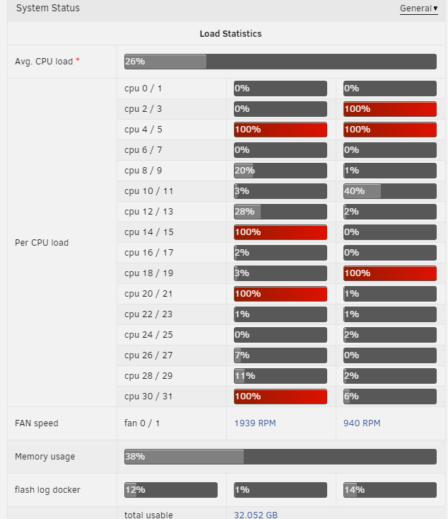

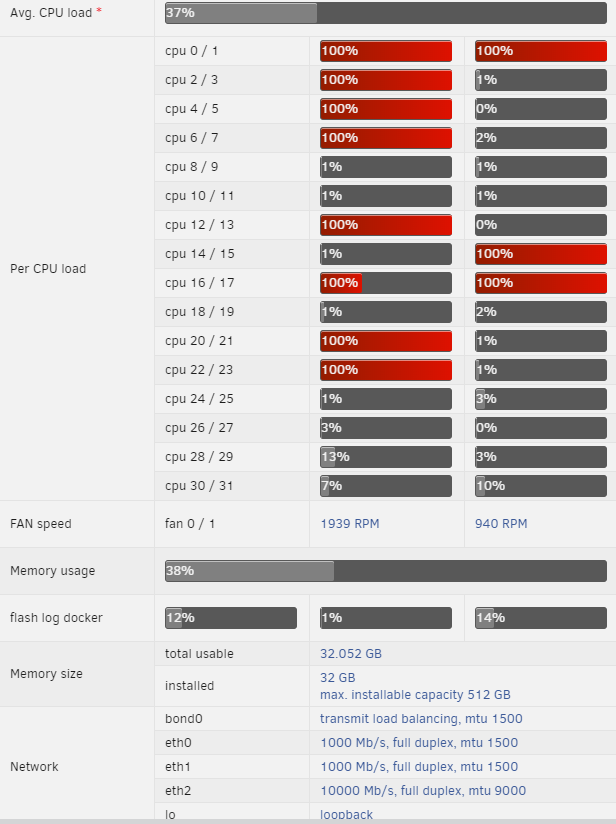

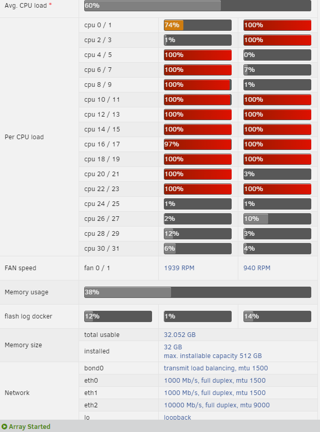

It may be a coincidence it may not but around the time of changing from a single Cache SSD to a 4 Disk RAID10 I am having problems with the server freezing (Grinding to a halt) with the LED Status Light for the SSD Pool solid on.  Checking the CPU usage I can see as many as 8-10 cores (out of 32) all red at 100%.  When this happens I am unable to use the server at all, VM's lock, Plex, (all dockers in fact) and after a few minutes the cores drop down - barely registering usage the SSD Activity LED drops to a flicker and everything comes back to normal.  This can happen every few minutes to a couple of times a day so incredibly difficult to pinpoint.

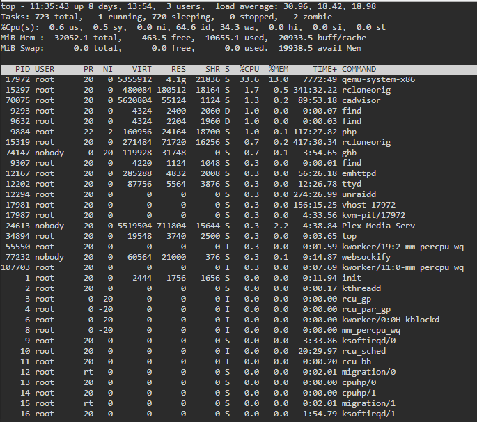

You can see that the top command is not reflecting the usage I am seeing in the dashboard either?
Any pointers would be really appreciated!

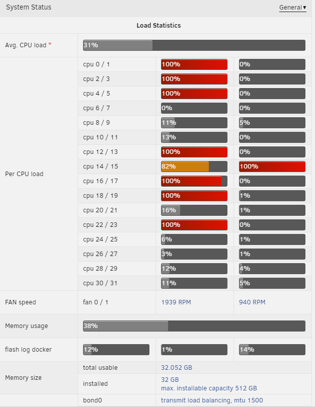

here is the CPU usage when the issue is occuring

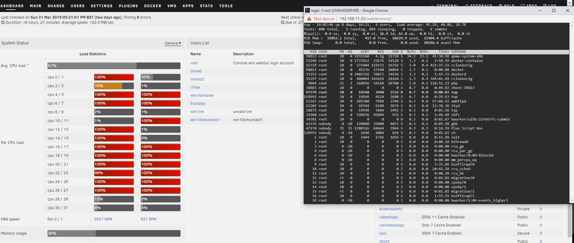

here is the dashboard when the issue is occuring

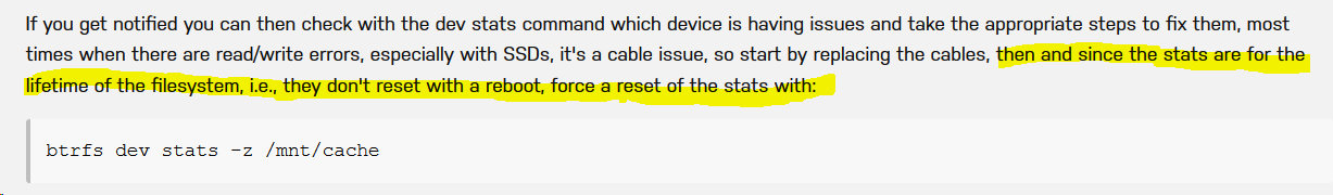

and is there a way to clear the errors reported on

Thanks for all your help (as usual!)  🙂
5 minutes ago, mbc0 said:
Why is 1.59TB scrubbed when I have 4X 480GB SSD's? (960GB Total)
Because data is mirrored.
There is, it's on the FAQ entry I linked above.
I am obviously far too stupid,
I have read both pages you linked to, been through the Main unRAID 6 FAQ's searching for btrfs error count / clear errors, I guess the answer to the question I am looking for is using different terminology that what I know or understand, I guess I will have to leave the error counts as they are and write them down
It's here:
Thank you @johnnie.black Sorry to be such a pain...
After all this the error count has not increased but still have the same issue! server has become unusable.. any ideas?
Try shutting down dockers/VMs, also like it might be a good idea to recreate the docker image, since there could be undetectable corruption, though same could be true for vdisks if they are in NOCOW shares.
Ok, I will do that... Thank you,
may take some time to find this problem as it can be every few minutes or a couple of times a day!
Ah! I think I have found what is causing it!  I don't know why it is happening but I can make it happen on demand!
I have lots of automation and I have just forced it by moving some data from my Desktop to the server...
I can copy at 400mb+ using my 10gb/E cards which as expected is going to be a demand on the drives but never had an issue when using a single cache drive.  If I copy large amounts of data everything is fine at first 400mb+ speed and cpu usage low, then the speeds drop literally to 0 and everything locks up CPU usage through the roof then if I pause the file transfer everything catches up and unraid/dockers/vm etc return to normal, then if I resume the file copy the same happens again making the VM's Plex, dockers all lock up!
Is there a way to test cache performance? this is clearly the issue!
