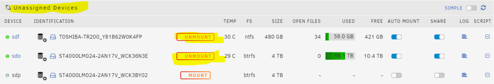

Did you unmount the disks from UD?
How do I do that?
Now I just selected the disks in random order, and nothing else.
Sorry for all the questions, but I don't get you...
You have the disks mounted with the unassigned Devices plugin, you need to unmount them first.
Like so:
For all the mounted disks.
