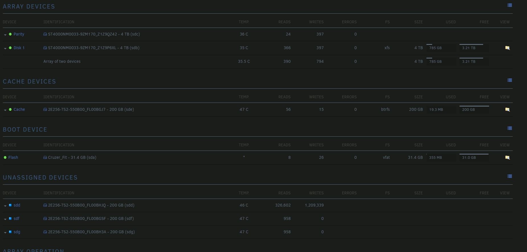

My config previously had drive sdd configured as a single cache drive. The change I made was to change this to use drive sde instead
Of course, I didn't bother reading any help files or wiki pages - and just went ahead and stopped the array changed the drive assigned as the cache drive. Upon restarting the array, I've now discovered I've lost all of my docker containers. When I go to the docker page, and click "Add Container" I've now got a drop-down for "Templates" which contains all of the containers I previously had installed. They do contain the settings for things like host paths, and keys, and appear to be set to what I had previously set - however when I install the app and check the WebUI I've lost all of the config settings within the application. I'm mainly using containers for media, so I have Sonarr, Radarr, Plex and a few others installed - and when I check Sonarr for instance, I no longer have anything configured.
When I stop the array, and try to configure it to use sdd as the cache drive again, I get the warning "All existing data on this device will be OVERWRITTEN when array is Started" - so I have no re-started the array using this drive as cache.
I had a fairly "default" install, and I was under the impression that being a cache drive meant it didn't really contain any share data. I was not aware that it contained any real data like docker shares. My question is, is there any way for me to recover all of the previous container information? Either by "recovering" the old cache drive without it being formatted, or re-installing apps on the new one. I'd like to not have to reconfigure the apps themselves.
I've attached a screenshot of my dashboard, and can upload diag files if it will help - but I'm hoping this is a fairly straightforward noob question.

Your use of the device identifiers sdd,sde is not generally useful, since these are not necessarily the same from one boot to the next. Unraid identifies disks by their serial number,
Is one of the Unassigned Devices your former cache disk?
Go to Tools - Diagnostics and attach the complete diagnostics zip file to your next post.
Start the array without any cache device assigned to make Unraid "forget" current cache config, then stop array, assign old cache device and start the array.

Thankyou so much - this worked perfectly. I think I'll do some more reading about how the cache disk works to avoid losing this again!
Thanks again!
