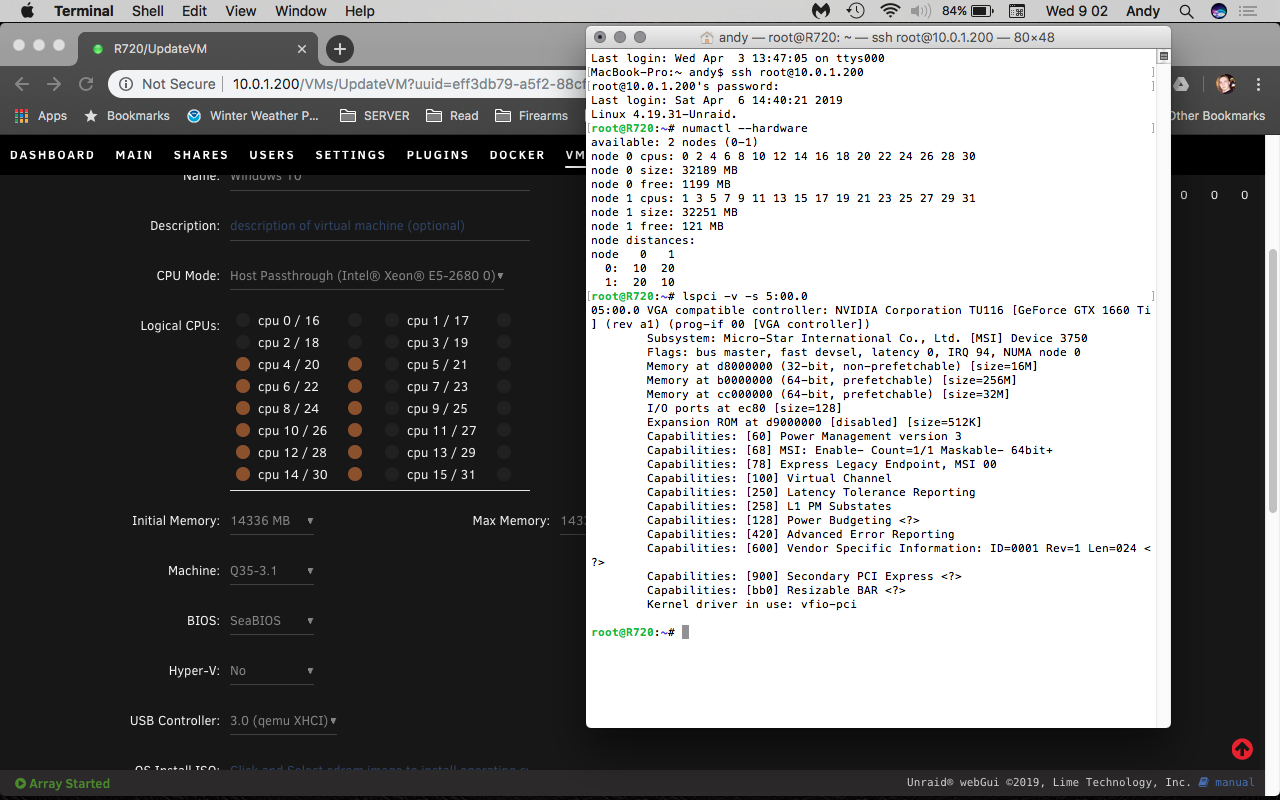

Are you sure, you're not assigning cores from both CPUs with this settings? Can you post a screen of the settings of this VM where we can see the core pairings?
You have 2 CPUs each with 8 cores 16 threads. If cores 0-7 are from the first CPU you are mixing them with the second CPU if that one starts counting with 8 up to 16. You have choosen the core 4 thats in the lower half of all cores and 30 thats close to the last core. For me this looks wrong. Emulatorpin is set to 0,16. If that is the first physical/logical core I end up with the following scheme

EDIT:
Post a screen of the output of the following command please
numactl --hardware
EDIT2:

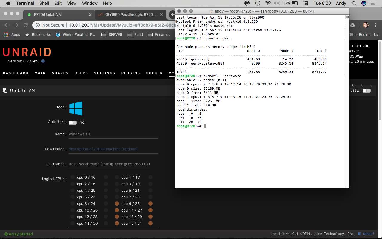

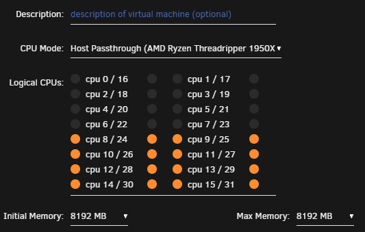

Example of my Threadripper CPU. This is basically also a dual CPU. The topology Unraid shows you in the UI might be different to mine, just to get you an idea. The marked cores in my config are all cores from the second die/CPU used by one VM.
Edited by bastl
Sorry it took a minute to get back to this, 1350116044_ScreenShot2019-04-10at9_02_40AM.thumb.png.b3045b9c0cc7a88c0f025555df8b400b.pngHere is a screenshot of my CPU pinning, and the output of numactl --hardware and lspci -v -s for the GTX, It looks like im pinned to all Node 0 for my cores and the card is also on node 0, i have also tried exactly the same setup but with the card in the riser 2 slot which puts it on Node 1 and then pinning cores to Node 1 as well, effecively putting the emulator pins on the first Node seperately.  Currently as you see this the same CPU cores are also isolated from UNRAID.
Ok, so your CPU pinning looks fine and your GPU is on the same node as the cores you use for that VM. Perfect. What I noticed from your numactl output, you're using a lot of RAM and only have 1.3GB free in total. In general Unraid doesn't care where the RAM is connected to, to which node. This could also cause your issue. Try the following to strictly use the RAM from a specific node. Ad the <numatune> part from the example below to your XML underneath the </cputune> element. This should prevent Unraid using RAM from the second node. Another thing you can try is to set a specific iothread and pin it to the same node as the VM, also in the example below.

With "numastat qemu" you can check how the current RAM usage of all running VMs is looking. For some reasons the "strict" settings not always works and some users already reported that even with this setting Unraid tends to grab a couple megs from the other node as well. I myself couldn't figure out what causing this or how to prevent that. Maybe @limetech has an idea or can provide us a solution to prevent Unraid doing that.
Still having this issue, I have moved everything to Node 1, Since thats where the NVME drive also resides. Isolated the 8 Cores from Unraid, Pinned them to the vm, Added the Numatune command for node 1, Added the iothread pin etc.  Seems that the strict setting on numatune still shows 14 MB frome node 0.  Im getting 60 or so FPS so i guess i'll live with it for now.
Here is current xml just in case i'm missing something.
