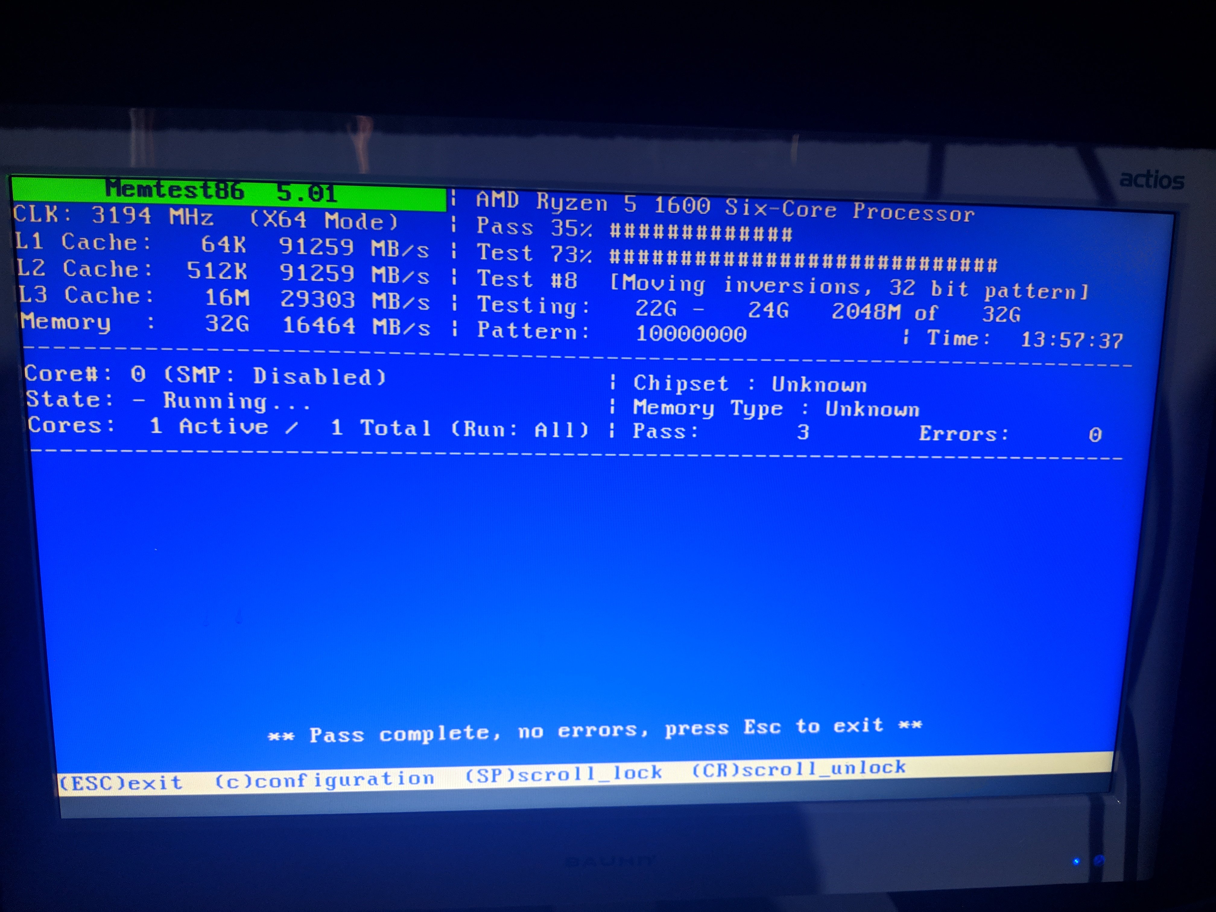

I ran memtest overnight for 14 hrs. Did 3 passes with no errors but was locked up when i tried to do anything using keyboard.
I was using a wireless keyboard. Does that matter?

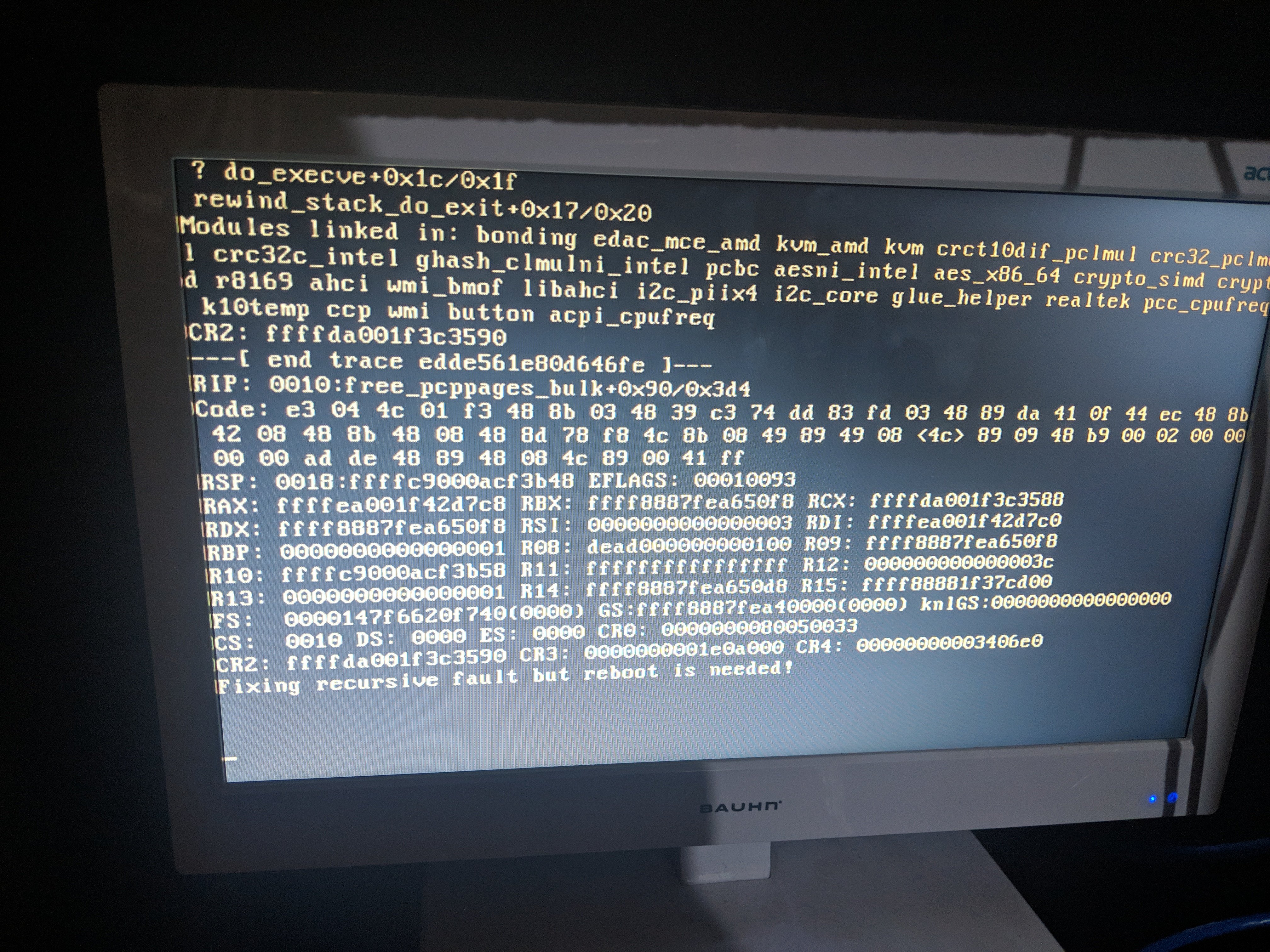

Attached is the pic of memtest while locked up. Second pic is on boot of unraid. It locked up at that point. It seems to be getting worst.
I will run parity check again but at this point I am running out of ideas and my knowledge is not the best in this field.
