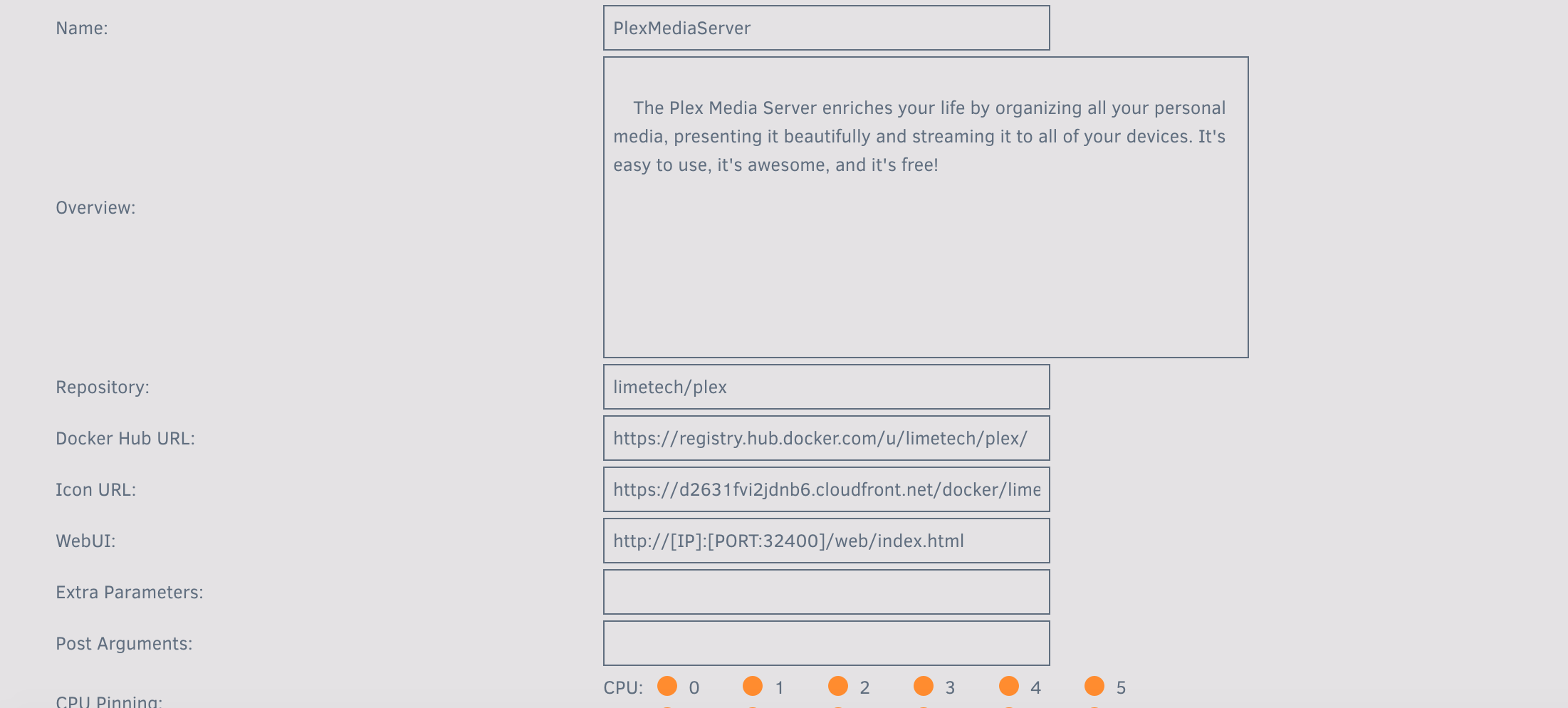

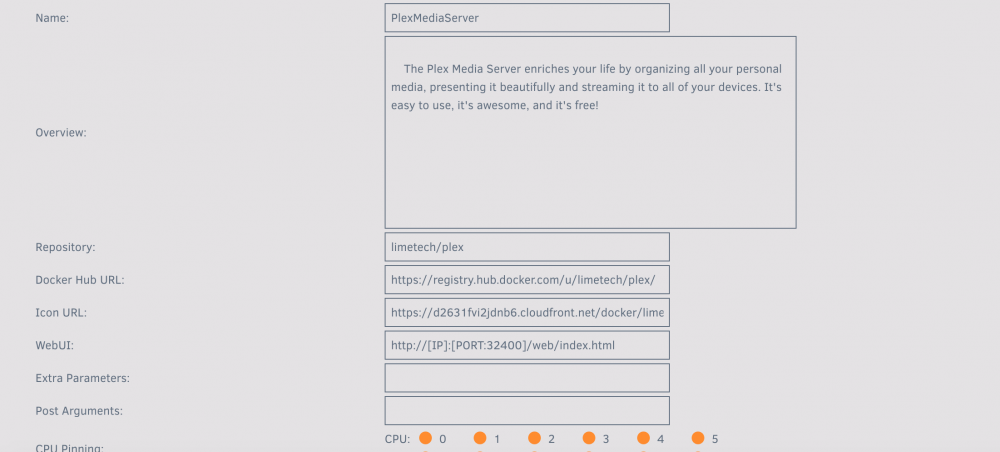

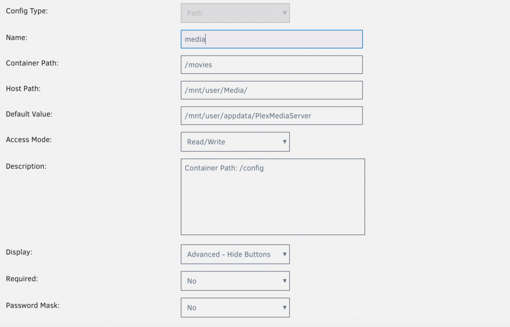

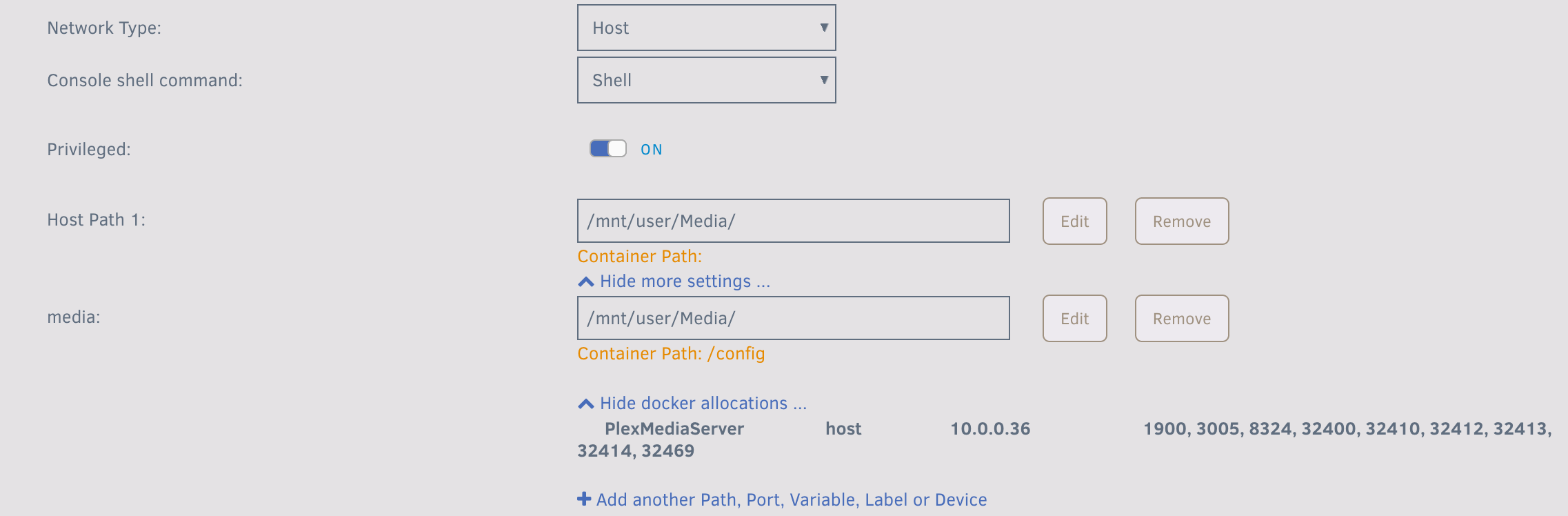

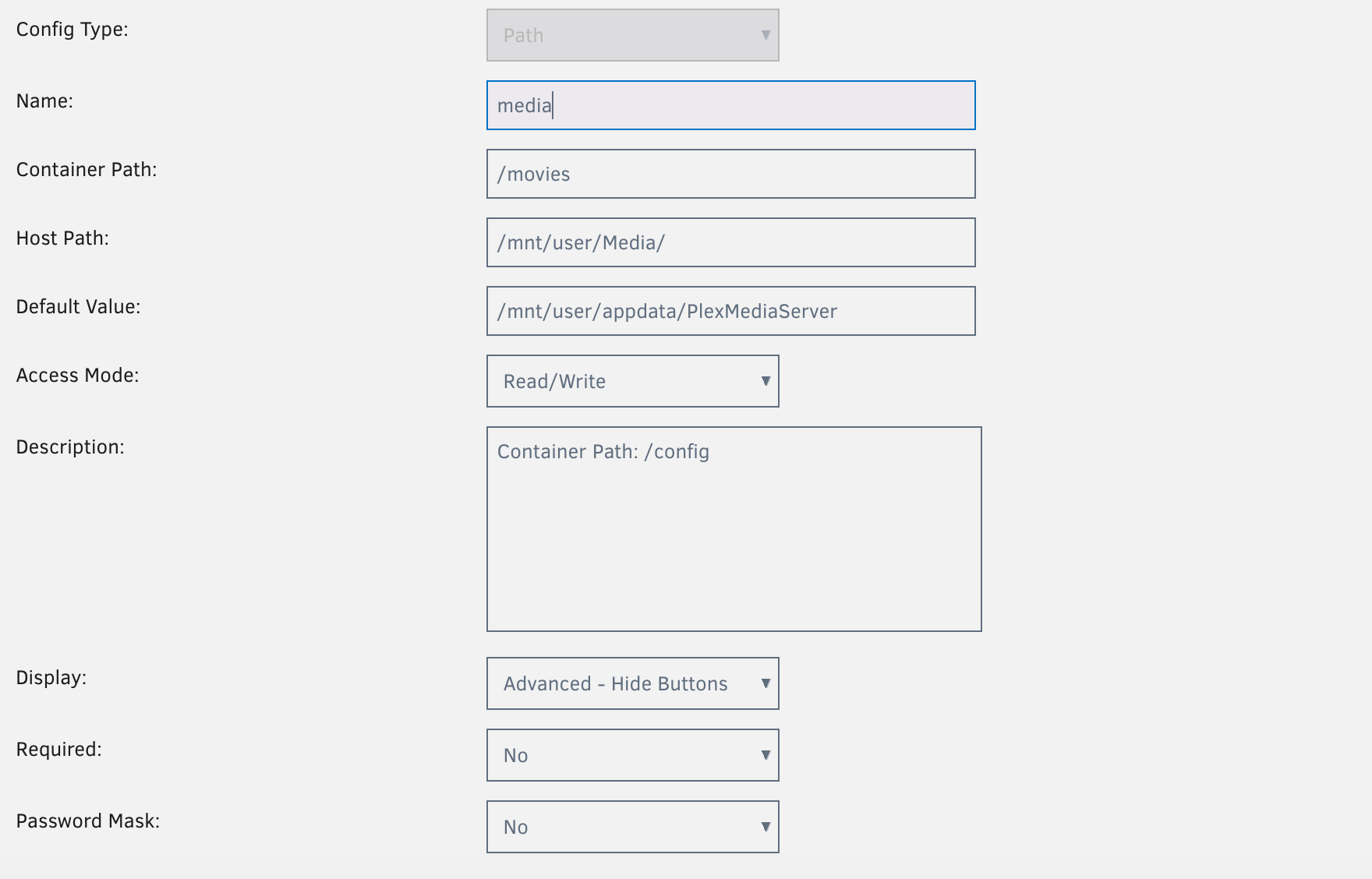

Sorry about that rezip. But here are the screen shots of my docker. I guess I configured Plex wrong and it is running in ram. Not really sure how I did that.
Looks like you have taken the /config path and used it to map your media. That /config path (and its default host mapping) needs to be there because that is where plex puts it database (library). Since you haven't given it anywhere to put it that is going to be a problem.
Start over. You need to leave that path alone and make another for your media.

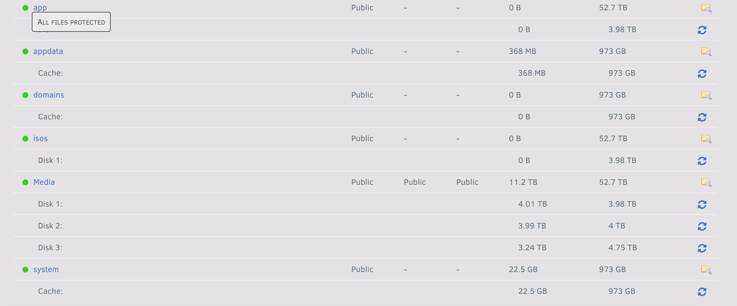

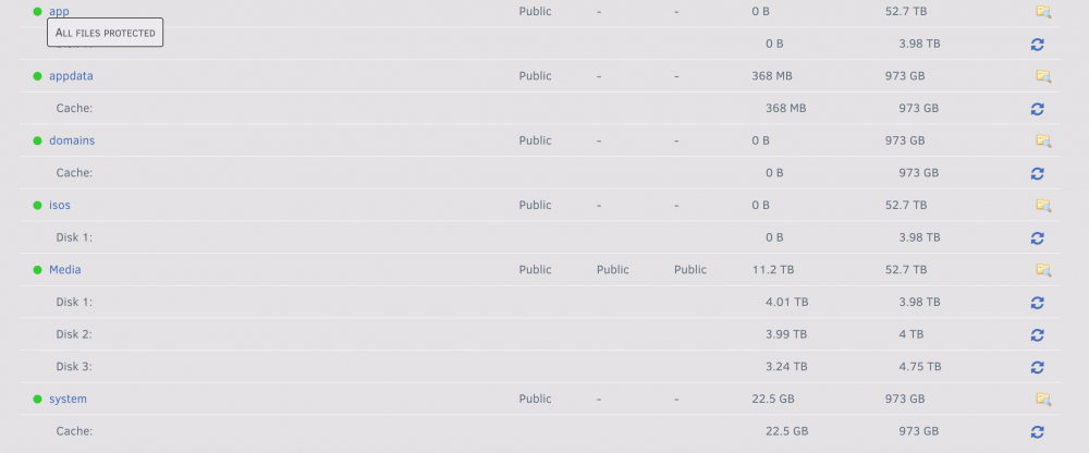

You have the domains share set to cache-no, but fortunately its contents are already all on cache where it belongs. Your appdata and system shares are both set to cache-yes, and they have content on cache and on the array. You want all of that to be on cache and stay there, but it will require a few steps to make this happen.
  • Go to the appdata, domains, and system shares and set them each to cache-prefer.
  • Go to Settings - Docker and Settings - VM Manager and disable each.
  • Go to Main - Array Operations and Move Now. Wait for it to complete.
  • Go to User Shares and Compute All. Wait for it to complete. It should show you that appdata, domains, and system shares are all on cache only.
After you have finished that post new diagnostics so we can check.

That screenshot looks fine and shows what I was looking for so don't really need that diagnostic.
You can enable Docker and VM Services now.

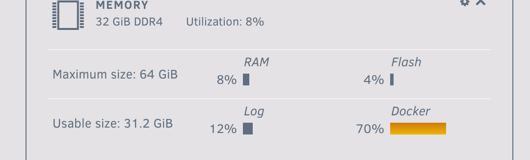

Was plex your only docker?

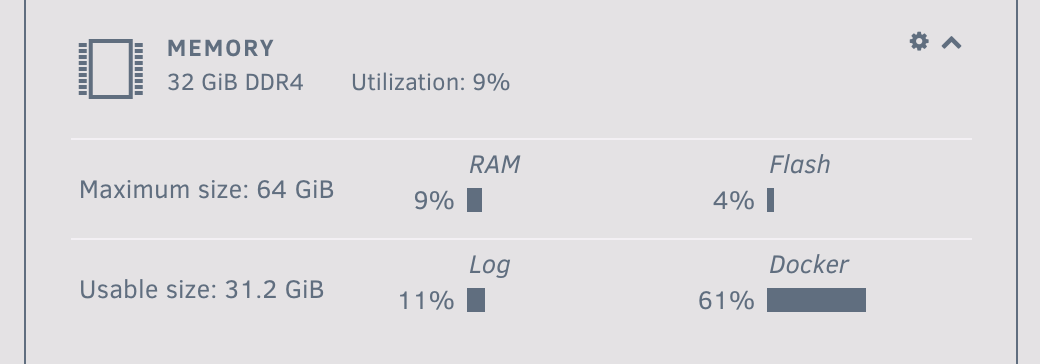

Still showing everything in ram.
Sorry missed that. It isn't RAM that is filling, it is your docker image. And in fact, that is what I would expect from the plex mappings you had before.
Disable docker service if you enabled it, delete the docker image and recreate it.

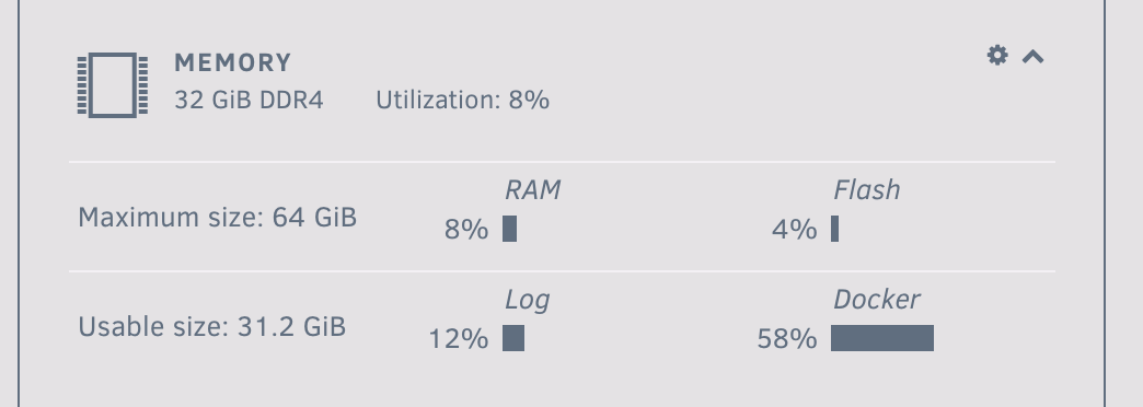

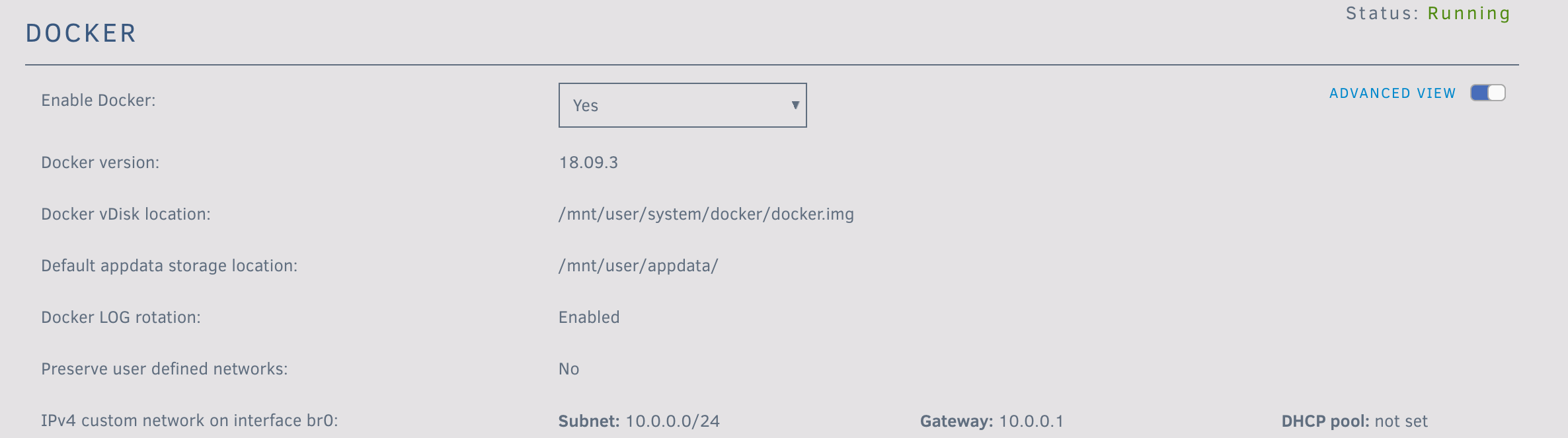

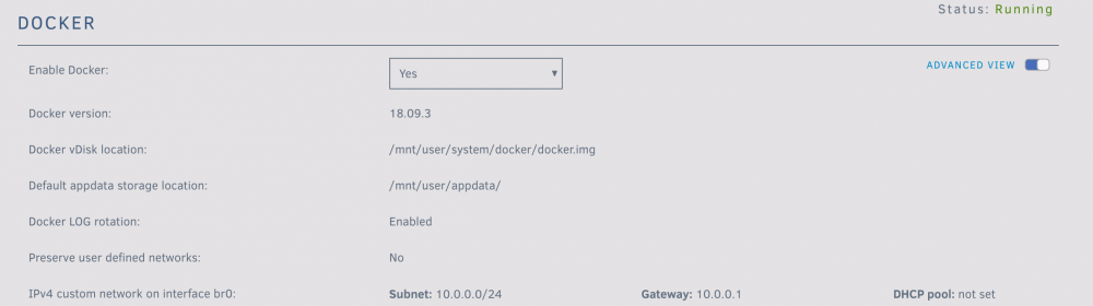

I did have two other dockers. But I just deleted all my dockers just now to see what would change. But now it still shows 59% and i dont have any dockers installed which is wierd.
Did you do this?
I dont use VM or anything like that. I am only going to be using this as a Plex server and media storage.
I have not recreated this yet. Going to do this now
