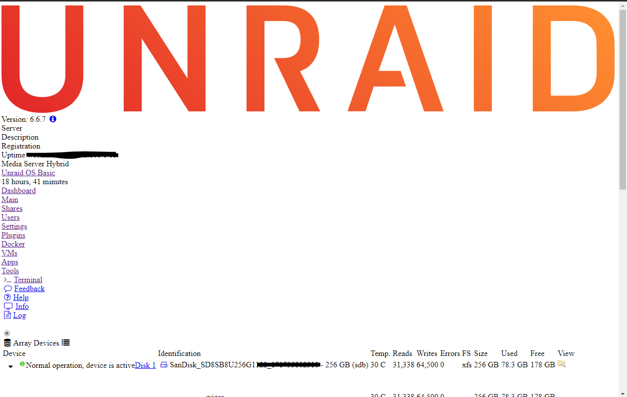

I'm having an issue where I select the "Gray" theme in Display Settings and everything looks fine for a few minutes, then eventually the system will auto-convert the theme back to Black.
I've tried deleting my cache in Chrome, as well as changing the default-black and dynamix-black files in /usr/local/emhttp/plugins/dynamix/styles to .BAK to remove the theme from the options, but doing this breaks the unRaid GUI overall as shown in my attached screenshot.
I've tried researching the issue myself, but I was unable to find any other threads/posts with people experiencing the same problem :(
Please let me know if anyone has any suggestions or wants some specific logs! (I'm not sure what logs would be applicable here besides the error messages when it tries to load the Black theme I renamed)
Apr 12 13:30:21 wecanstream nginx: 2019/04/12 13:30:21 [error] 28135#28135: *197674 open() "/usr/local/emhttp/webGui/styles/default-black.css" failed (2: No such file or directory), client: [redacted], server: , request: "GET /webGui/styles/default-black.css?v= HTTP/1.1", host: "wecanstream", referrer: "http://wecanstream/Main"
Apr 12 13:30:21 wecanstream nginx: 2019/04/12 13:30:21 [error] 28135#28135: *197594 open() "/usr/local/emhttp/webGui/styles/dynamix-black.css" failed (2: No such file or directory), client: [redacted], server: , request: "GET /webGui/styles/dynamix-black.css?v= HTTP/1.1", host: "wecanstream", referrer: "http://wecanstream/Main"
