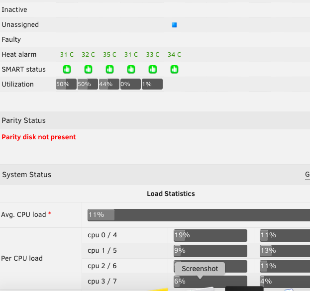

The speeds at both ends have to be approximately the same.  So  it will always to the speed of the bottleneck.    Again, what are the size of the files?   File management overhead is an issue with rotating hard drives.  Plus, I am not sure how 'efficient' Krusader is in handling external transfers.   (I assume that you are using the Docker version of Krusader.)
Have you checked the speed of transfer to your backup server using another computer.  There is also Lan Speed test utility that I have used in the past.  I would suggest that you 'vet' it before downloading.  You can find it here:
  https://old.totusoft.com/lanspeed1.html
You do have to use a fairly large file size to get around the RAM caching that Unraid will use if memory is available.
