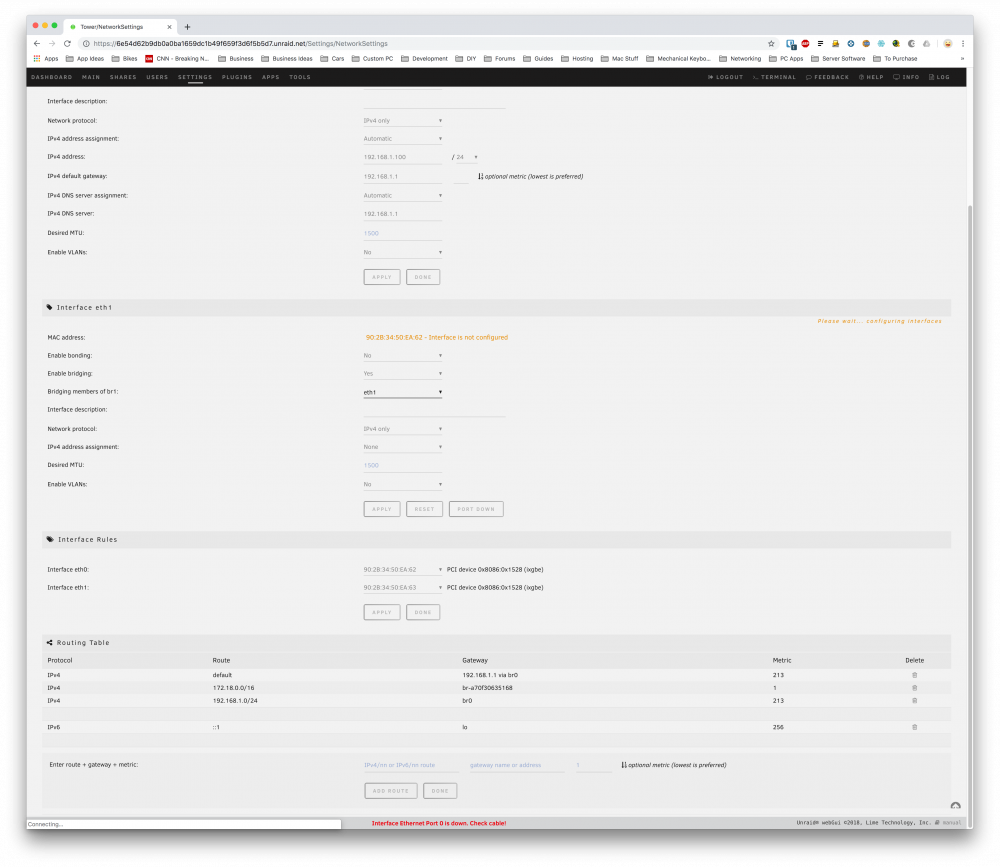

I was messing around trying to setup a "Public Network Bridge" and ended up last leaving the Network Settings page like this (attached).
Server is now unreachable over the network, but of course can still access it via terminal at the box.
Can someone please help me undo this? I believe it's due to me setting eth1 to Enable bridging > Yes, and Bridging members of br1 > eth1
TIA.
Delete /boot/config/network.cfg and reboot, it will go back to default.
