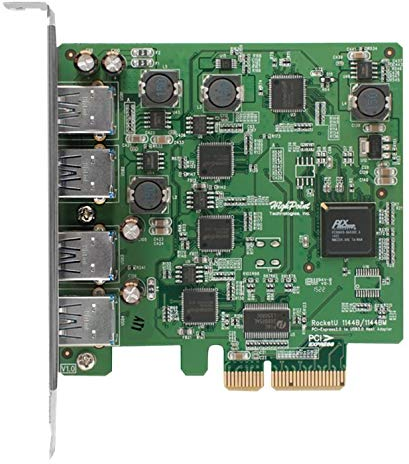

High Point 4-Port 4-Controller USB 3.0 PCI-Express 2.0 x 4 HBA RocketU 1144D
https://www.amazon.com/gp/product/B015CQ8DCS/

Using pci-stub.ids=1b21:1142 in the syslinix.cfg lets one or more of the 4 controllers to bind to a VM (but not different VM's without the PCIe override being set). I tested thumb drives & had three Brio web cams ingesting at 4K simultaneously without issue. No need to stub 10b5:8609. The card is not compatible with UNRAID's "BIND" via vfio-pci.cfg

This card works in my setup using the VFIO plugin.
  • 6 months later...
I'm using this card it works great!  However.. I get intermittent disconnecting issues.. every 10-15 min or so.  Any suggestions?
[Edit] It seems like my issue was more related to a usb extender!  There is a fairly rare disconnect now where I loose access to all usb devices to the vm, but a server reboot resolves this (still annoying).  The card is working well with the below settings:
- I have all 4 usb controllers bound using the VFIO plugin
- None of the additional devices that show up for the card are bound
- I'm sending two usb controllers to one vm and two to another
- I have a powered USB hub connected to the port.
- I have PCIe ACS override set to: Multi-function
- VFIO allow unsafe interrupts: no
