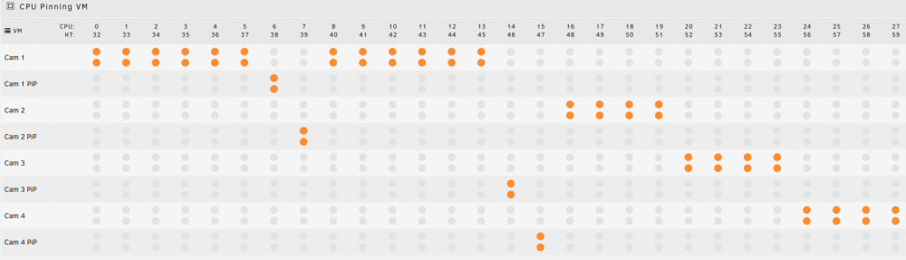

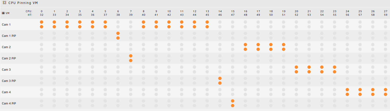

    Testing the intended use of this motherboard, I've been ingesting four 4K Brio's via an USB3 add-on card passed through to a Win10VM and outputting a 4K stream to YouTube as well as outputting those 4

Here's my pinning layout. Cam 1 is running Livestream Studio and it exports multiple Brio's via NDI to the other VM's to upload to YouTube using OBS.
So the bump comes from the 1st core assigned to your VM. If it's a windows 10 machine it seems to consume a lot of kernel in htop. The timer fixes will cause it to drop. You won't see the utilization in the VM itself as it's large overhead happening in the hypervisor level. What you will see though is higher cpuz tests as you notice it does multi thread then tests the first core in windows. I'm curious to know if others see the same cpu throughput in cpuz that I see.
