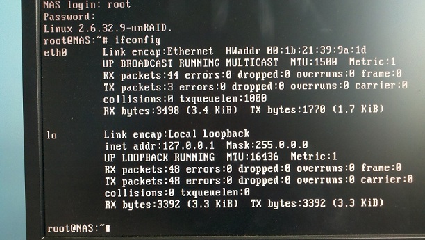

Well changed the ip and subnet to what ifconfig shows on my unraid server and can't get into the web interface. Any other ideas?
Changed my pc to 172.0.0.1 sub 255.0.0.0
Ifconfig says unraid is 172.0.0.1 sub 255.0.0.0
I get a page not valid message

is there a way from the console to set an ip, subnet, and default gateway?  or a way to check those settings?  maybe even ping?
From the console type ifconfig and press enter
You should see eth0, confirm the inet addr and mask.  You can also try to ping your pc by typing ping 192.168.1.177
